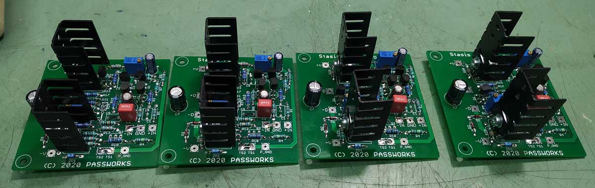

Hi Zen Mod, I don't know what size your FE boards were. The one Nelson laid out was 3.5"x5.5", which put it in the $65 with shipping for 10 pieces.

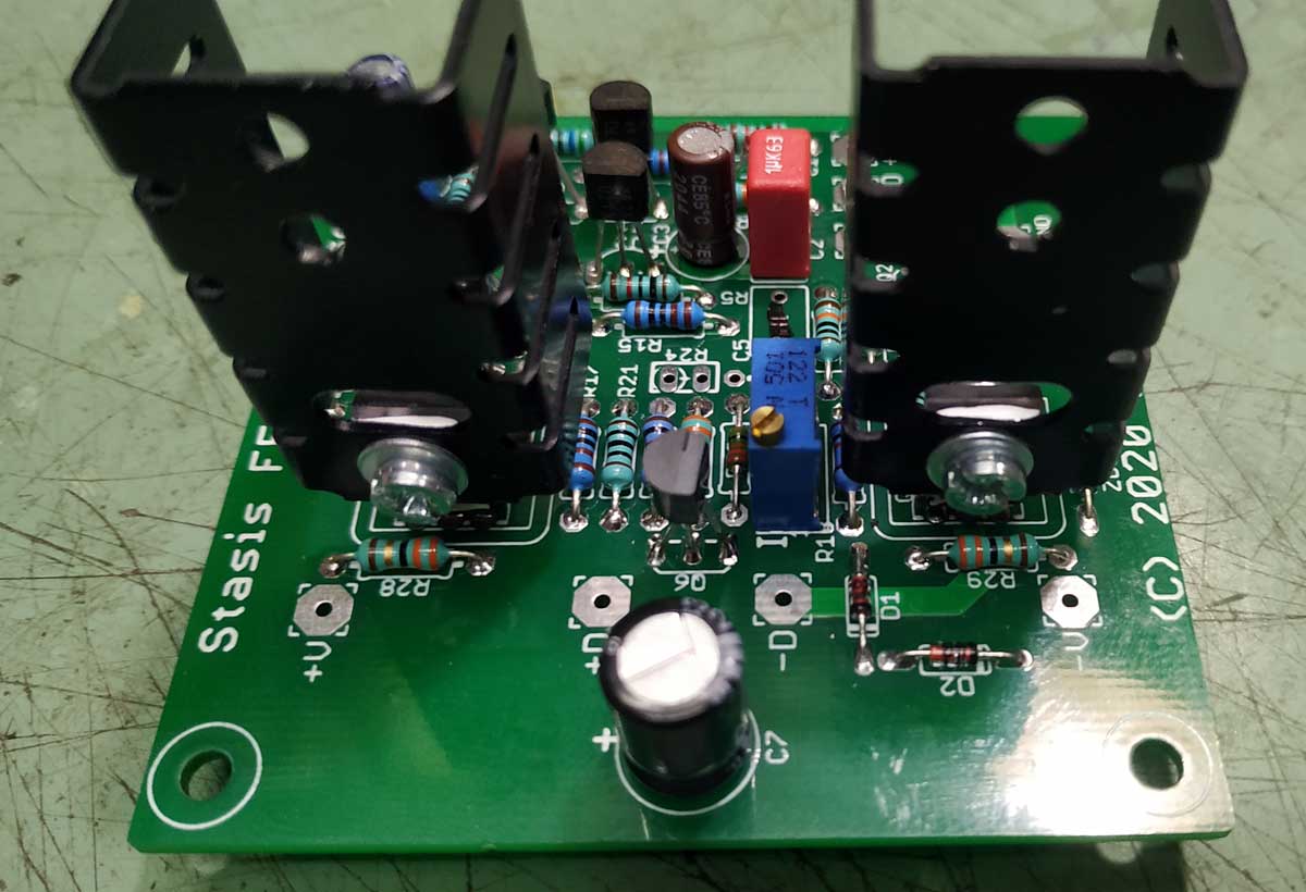

Hi Mike, I don't think I can change the gerbers from another package though I have never tried to import them (maybe I will have to look into that), I just use the schematic capture and PCB layout program to make new boards. On the new board I am making, it fits between the current long screws which are on a 2.75"x 4.25" pattern. I laid out the PCB to use the 220uf Silmics for C2 and C3. Also I like to use multiturn pots that can be had with the screw on the top or on the side, and you can reverse them, so they can face up or down, and I always try to put them near the edge of the board so easier to adjust, and if possible make a location on both edges so you populate whichever one you want up. I design stuff from the point of easier to service if I can. Too many times working on my car I wanted the Toyota engineers throat in my hands. 🙂
I was going to suggests putting trimpot locations on both edges but didn't think that was easily doable with all of the other traces on the boards. I suppose you could use jumpers to go over the other traces and decide which trimpot location you want to be in use.

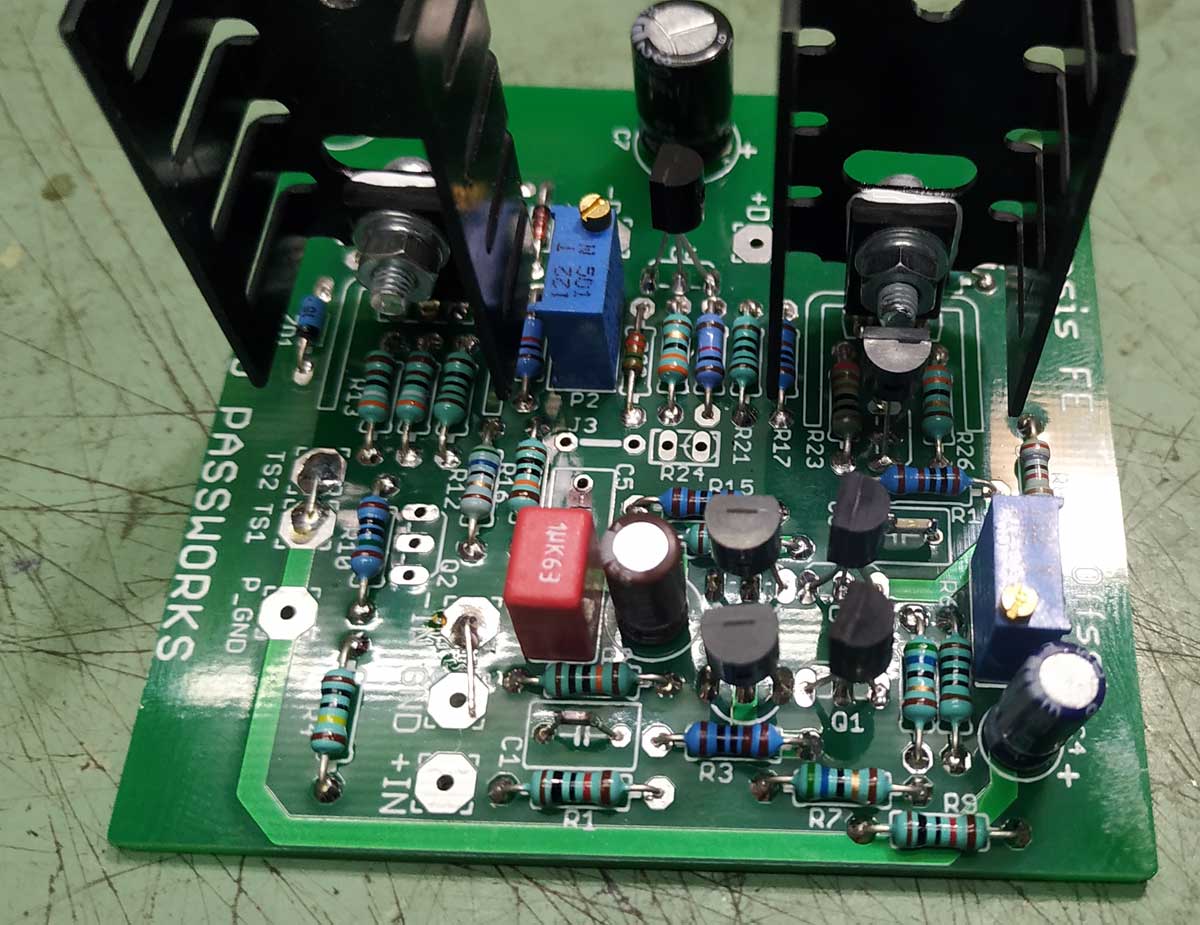

So going back to my post in #1257 I learned a few things. I believe the NTC thermistor takes the bias and lowers it as the transistors come up to temp. I also learned that my bias issue was due to C4 being empty. As of right now, I have 20pf in there.
Increasing R18 resulted in very high bias, to the point where it would blow the negative rail fuse (I put 2 amp fuses in for testing). Lowering R18 resulted in lower bias and less of a rise. With 20pf oscillator cap in place, the bias behaves. Also, taking the cover off causes the bias to drift. So as Zen Mod says, put the amp together. I believe I need to increase C4 a bit more. I will grab a 25pf, 30pf and a 35 and try them. I need to get something that produces an accurate square wave though. At 10khz, my DAC seems to put out a sine wave according to my oscilloscope.
I also was able to fit the 220uf Silmic II cap in C2. I just bent it over.
When I get everything wrapped up. I will post a schematic with the values that I have in place. Also pictures showing everything as best as I can.

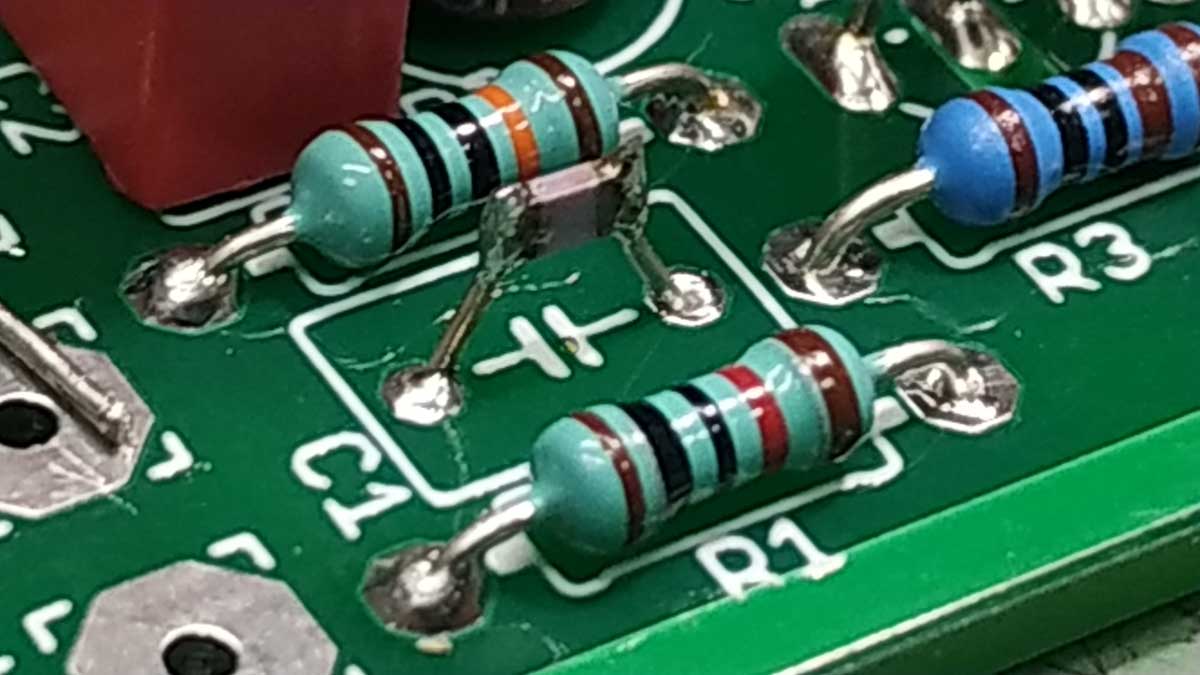

decided to rejoice some of my Yore amps with Hitachi laterals
BC639/640 instead of ZTX
MJE340/350 instead of 2SA/SC
see what I'm doing for pico-caps, lazy to search and order through-hole, already having drekload of them in SMD
will post, once when done, actual schematic and some pics
when - who knows, that's lazy work

how do you keep the SMD from unsoldering when you solder add-on legs
to the PCB? Forceps as a heat sink? -nice work around- 🙂
U shape leftover pin of 1N4148, solder in pcb, cut U above, refresh soldering on cap itself
if you're soldering properly in pcb, that is not going to melt solder at cap

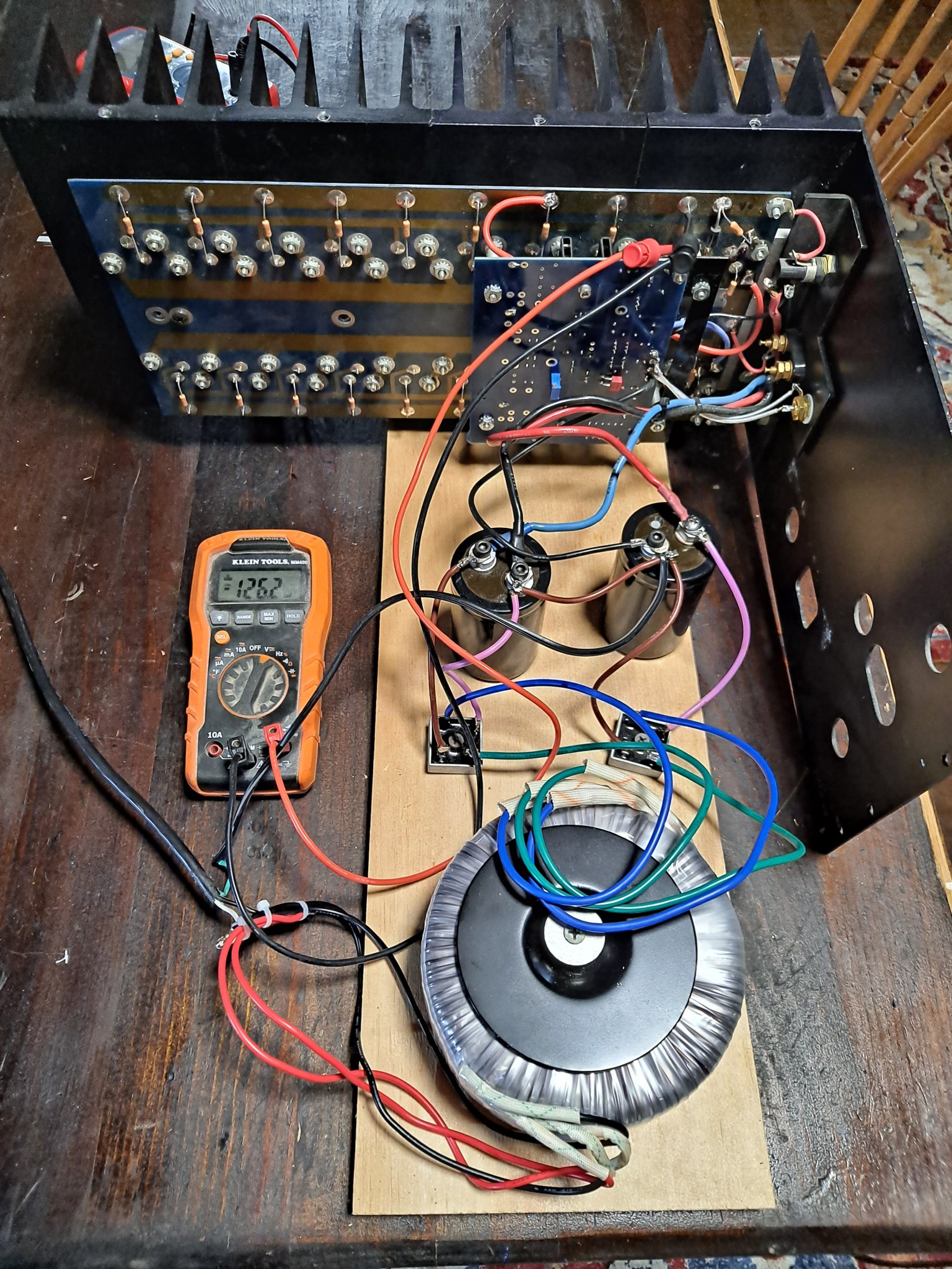

Okay, so I messed around with trying to swap the front end with the values suggested earlier in this thread for my Threshold S/500. It was prone to oscillation. I tried a variety of caps and got it to behave and bias okay. Not great but just okay. Taking the top off of the chassis would cause the bias to start going up. The oscillation cap seemed too high as it was causing the soundstage to dissapear but the center image was very strong. However, it didn't sound quite right. I suspect this front end wasn't intended for the 80v rails that the stock S/500 has.
So an experiment. I bought two 500va 30v transformers. I mocked up a little power supply to test (40v rails, no CRC filter, a fuse, and about 100000uf). The nice thing about this is I can now run the stock values that the front end was initially designed with since the rails are now 40vdc. I will run dual mono with the DIYaudio CRC network and the onboard rectifier section. I suspect this will get me down to around 39vdc. I checked to see that the S/500 runs the same output devices that the SA/1 runs. It does. So I should end up with around 70-80 watts or so in pure class A per channel. This should hopefully make for a neat hotrodded SA/2.5ish?
I am powering up the amp tonight with my cheesy test power supply just to test and see that things behave, stay cool, bias up without smoking etc. Tomorrow, I intend to go through the new stassis front end board and return all of the values back to stock. Then I can bias it up again and hook up a minimus 7 to it (test speaker)
I am excited to see if it sounds better than the original setup. Worst case scenario, I can return the S/500 back to stock and make a stassis amp in a different chassis. I'll have most of the parts anways.
Now I am debating whether to stuff everything in the original chassis or if I should run a separate power supply case and put some extra caps in the main chassis.
