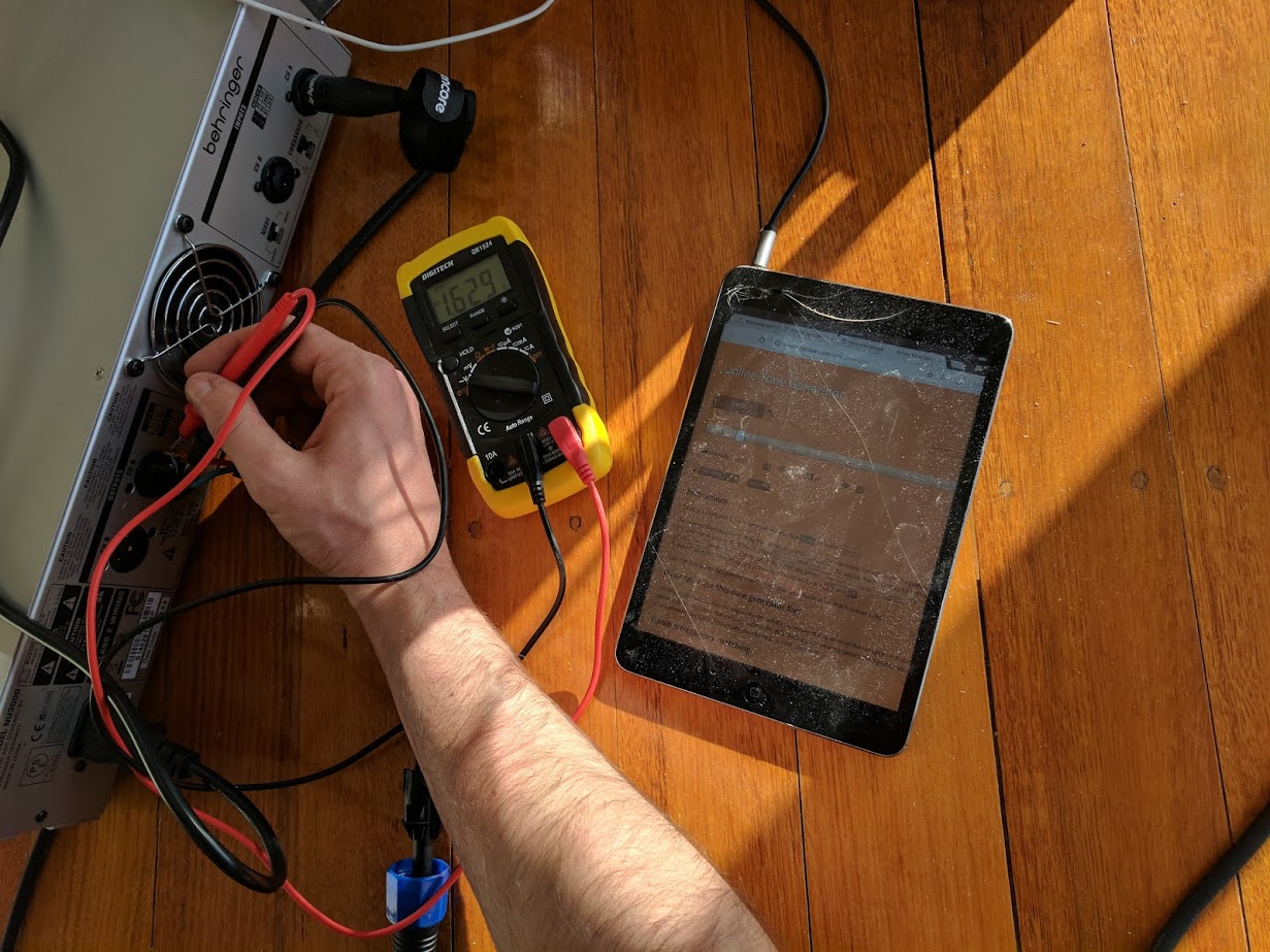

In our previous chat you mentioned connecting a lightbulb in series to the woofer, where and what value resister would I need in this test circuit?

There is also a low-budget way to do it with a signal generator, a resistor, and a volt meter (i could walk someone through this procedure if they wanted to try it , it is pretty easy really)

That is correct , a small lightbulb (like a mini hobby bulb) in series with the driver will do the trick , it will shine brightest right at the cabinet's tuning ....You would just want to run your signal generator up and down in frequency by 10hz above and below your target tuning while keeping an eye on your bulb to see at which frequency it becomes brightest............................In this sort of setup you can also take a voltmeter (in A/C mode, low voltage) and connect it across the lightbulb to see the changes in more detail .... The higher the voltage reading you are getting on your meter means the closer you are to the current cabinet tuning as you adjust the frequency on your signal generator .... (in this case you can even just replace the lightbulb with a 10 ohm resistor and pay attention solely to the voltmeter as you sweep your signal generator back and forth slowly through the general bass range in question)..
NOTE: If you don't already have a signal generator (to drive your amp in the above tuning and experiments) then I wanted you to know that there are some software signal generators out there , and i was even able to find a really cool and totally free web based signal generator! Go to the link , this is really cool , i think you will like it ..

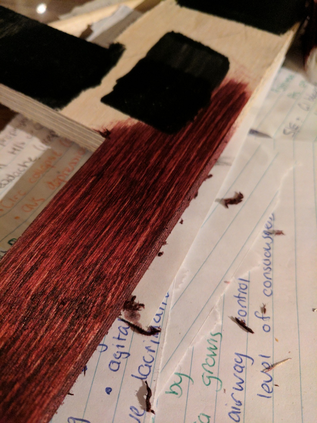

Just a quick post to check in: got the cabinet together today, tuned to 33hz (no real reason why, I do like Larry Bird though). Doing the final glue up at the moment, will fill gaps and sand tomorrow and begin with my finish.
I'm going to stain the aperture and finish it gloss and use chalkboard paint on the rest of the cabinet. I know, bit wtf but hopefully it works!

It was terribly difficult until I found out I was using a 10k ohm resistor instead of a 10ohm resistor. After that it got a lot easier.

Attached is a photo of my test paint/stain.
Hehe , that makes a big difference!

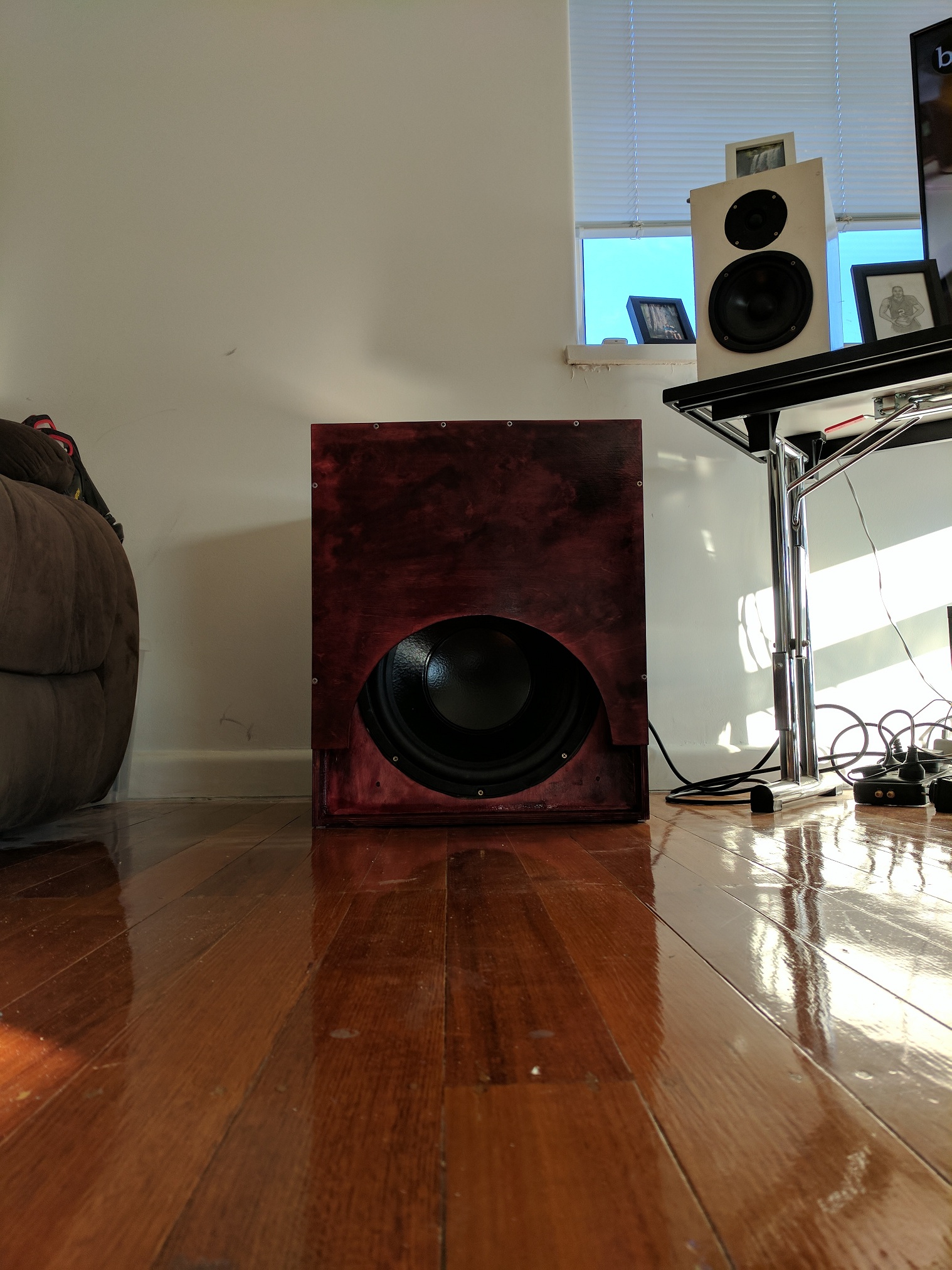

Sorry for the gap between replies, I've been busy snowboarding of all things! Attached is a recent picture of the front, the sides and rear are a matte black chalkboard paint that hasn't seen any chalk yet but I'll keep you guys posted. I will post a video some time this week once all my neighbours go to work.
The sub sounds amazing, it's obviously effortless in its job, even at lower volumes and sounds great. It's not overpowering (which I was afraid of) but when I start turning the volume knob up it lets me know that it could induce a pneumothorax at any moment.

Your Karlflex cabinet looks great!
With the "E" style aperture lowered slightly (and shading just the top of the driver) it gives you a very cool aesthetic appeal I like it a lot , and it should be technically solid with enough well controlled resonance down low to give you some great subbass presence for such a compact cabinet ..
I also really like the finish that you used .... Very attractive .... That ended up working out well
I appreciate that you posted this publicly, so folks can see how things turned out ......
As far as the crossover is concerned that Lab15-4 driver was really meant to be used strictly for bass reproduction and according to it's published graph it is not that great above 150hz so we know it is good up to that point at least (as the Karlflex design itself was meant to have a very wide bandwidth which means that the cabinet will not the limiting factor here) , but i have to admit that I am curious about how high up in frequency it will play reliably when loaded with that driver (not that you would actually want to use it up that high for regular listening, unless you had a stereo set of them perhaps) ...

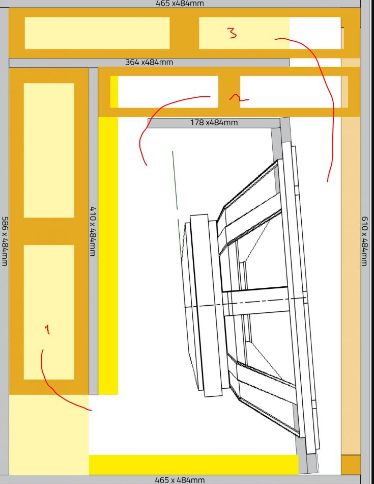

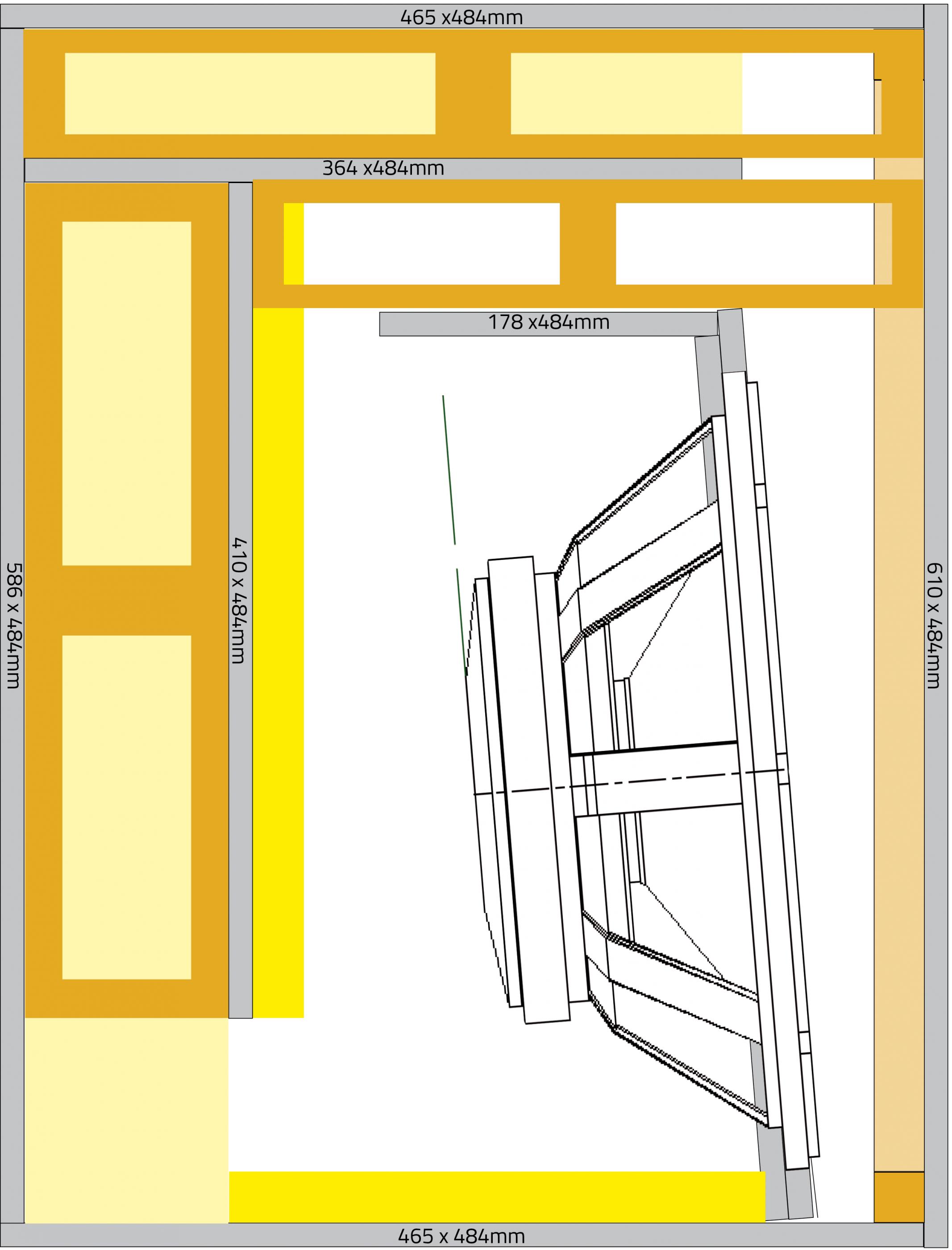

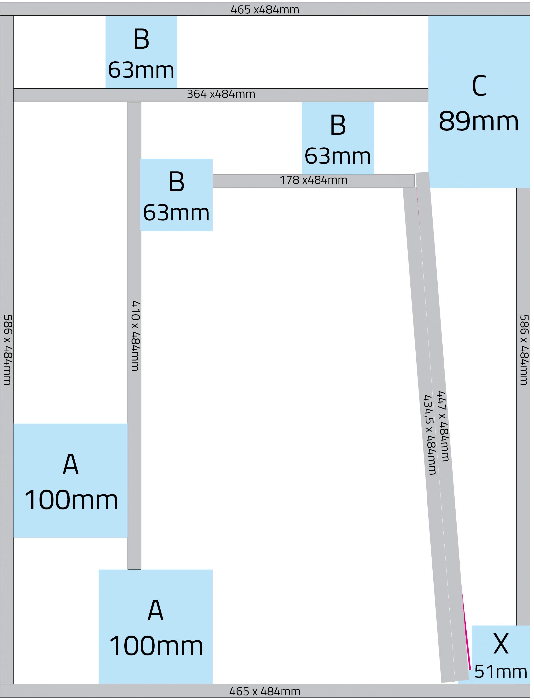

Hi guys,
now it's time for me to build a Karlflex 15, to be equipped with a Thomann speaker.
Here's my first drawing, all dimensions converted to metric:
Braces and stuffing / lining omitted on purpose, will add later. Comments and criticism is welcome!
=D
