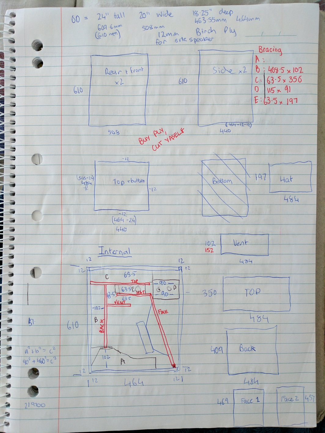

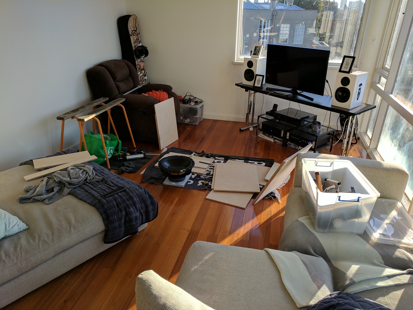

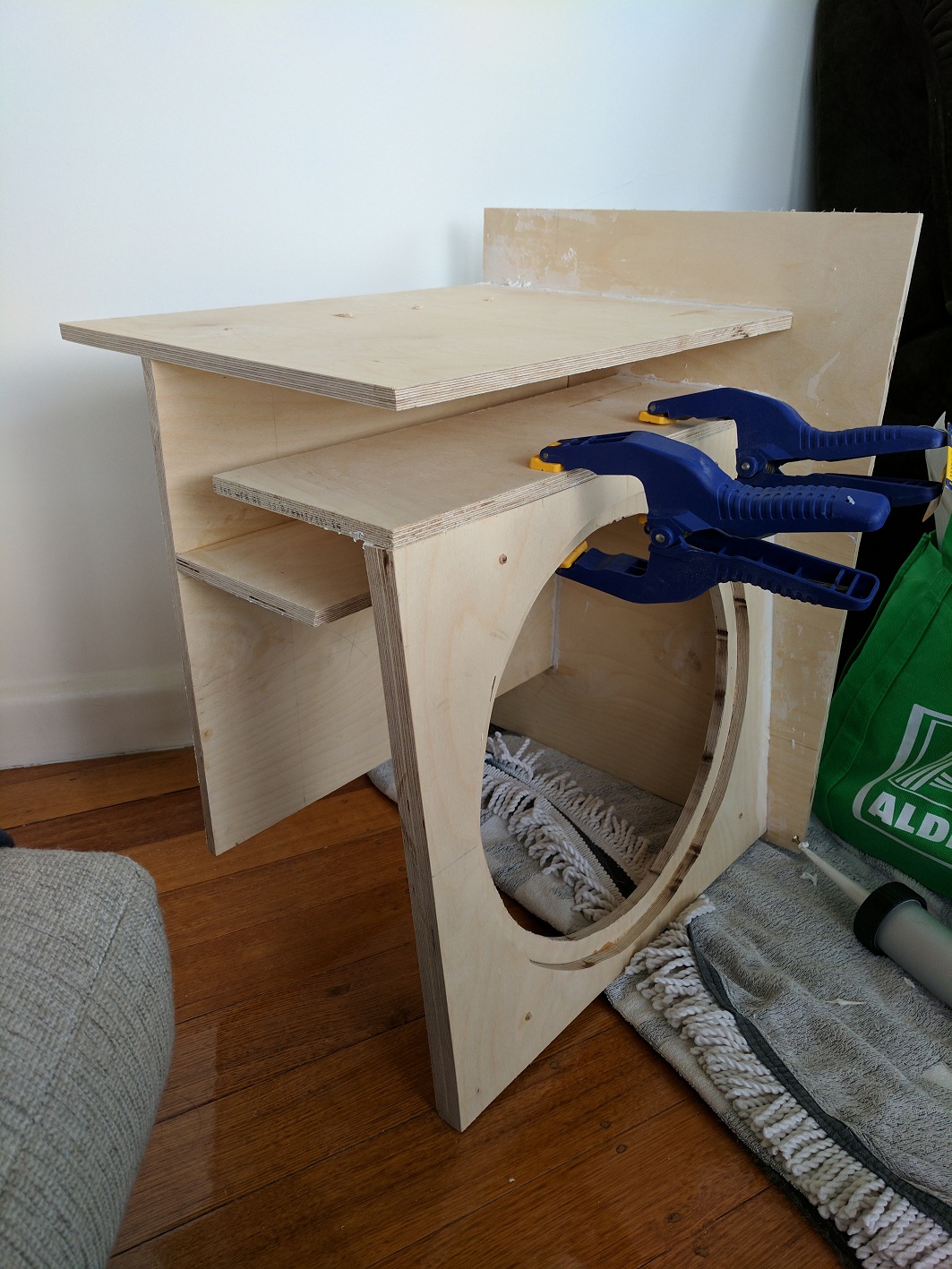

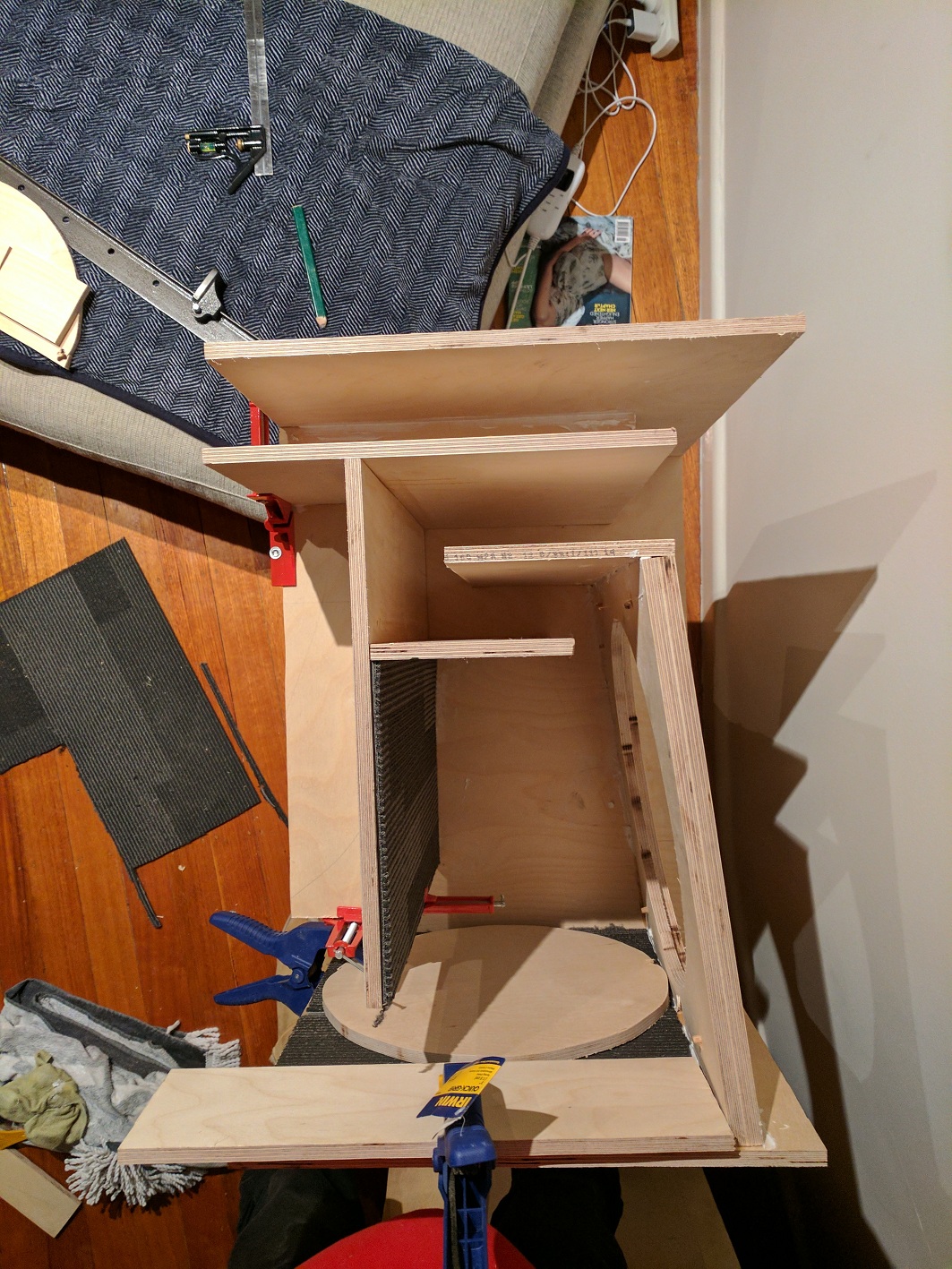

Gday guys,
Had a quick chat with MMJ a few years ago about this project but have finally got around to building a 100L Lab15-4 Karlflex, here are the photos so far.
Not a lot of room or tools to work with so it is a bit of a botch job, lots of rough joinery and patching up but I enjoy learning. I have an iNuke 3000 to use with it although I'm not sure how much I'll get to use the sub as I live in an apartment.
Should be ready to use in the next day or two, although I'm not sure how I will finish the ply yet.

MAGNIFICENT!
This is wonderful Mattcalf !
Good job!
You will find that it will play without the front panel (aperture) but it will REALLY come alive and impress once you have added the aperture panel, and the good news is that the shape of the panel isn't as critical as it is when making a wideband Karlflex, because you can obscure part of the driver with the aperture panel if you like .... You could obscure the upper portion of the driver , you could make a slot located in front of the driver if you want ..... You have options without having to worry about the effect on the upper midrange , hehe
This will be a subbass and bass range only cabinet of course, and it is very compact for it's capability...
I can see that you went with the extended duct option, in order to tune the Karlflex low .... Expect a tuning of around 30hz once you get the aperture panel installed ....
In an apartment you probably won't be able to turn it up very loud without upsetting the neighbors ... Hehe ..
NOTE: That 4 ohm version of the Lab15 has a tight suspension and won't perform at it's best until the suspension is broken-in (also called run-in) ..... I would suggest breaking the driver in before loading it into the cabinet ...
To perform a break-in just place or suspend the driver somehow (in a way that doesn't cover it's pole vent) such as sitting it on the open end of a 5 gallon bucket , or hang it from one of it's basket spokes using a cord or rope and then drive your lab15 with a 25hz sine-wave at enough power level to get the cone moving just a bit ..... You can just set it up and walk away ...... Break the driver in this way for at least a few hours minimum , or even better yet let it break-in overnight while you sleep! Then it will be ready to load into your new Karlflex cabinet when you wake up ...
Looking forward to hearing your reports about this cabinet

Thanks mate! I was planning on going for designation E as the aperture. Would that be your choice? Re-reading our previous correspondence you mentioned that the aperture/mouth should be around 1x SD of the driver (823cm sq), is this still the case?
Excellent, thanks. I'm just waiting for the speakon stuff to arrive and then I'll run it in.
Will definitely keep you posted.
Various notes about aperture , tuning, resonance etc
Mattcalf ,
Aperture style "E" is definitely a great solution in that cabinet , i had to tinker around with the prototype quite a lot to figure that out, and yes , the type "E" would be my first choice for producing a wonderful resonant yet well controlled subbass output in that Karlflex sub design ...... and yes matching the driver's SD is a solid conservative approach ..... ......................
The classic K-slots do have an interesting and very useful purpose in regards to the dispersion of midrange and upper midrange frequencies (if you have some on-axis decibels to spare in the upper-mids) , but that really doesn't apply here to a subwoofer ................................. There is however this question of augmented resonance near the fundamental tuning , and i will touch on that again later ..
There was some information about tuning that i wanted to leave here for you .... As i mentioned in a post recently the optional duct extension panel that you included in your build should get your tuning down around 30hz-ish (an approximation) .... Without that extension the tuning will be more along the lines of 36hz-ish which sacrifices some extension in order to gain a few more decibels of efficiency and max output (compared to the lower tuning).........
So, again, you have options
The 30hz-ish tuning would be considered more ideal for movies (home theater) and will also make a fine multipurpose sub for general usage ...... The 36hz-ish tuning (or higher) would be considered more specifically dialed for music applications such as PA where maximum output and efficiency become a higher priority ....
.... My original target was 40hz without that duct extension panel but after building my prototype Karlflex i realized that the box tuned a little lower than what was predicted by the sims ... This is partially due to the fact that the Aperture Style "E" doesn't have any sort of slot in the upper part of the front panel to unload the low frequencies early on, so in other words the path length is somewhat extended by the front panel itself which is not necessarily a bad thing ....................*This shift in tuning can be compensated for if someone was intent on keeping the tuning up around 40hz or even higher, it requires pulling the driver out and trimming the end of the internal shelf duct or using a hole saw to drill a few holes near the end of it...
If anyone would want to attempt such fine tuning then you would need to be able to take impedance measurements to verify where your tuning ends up ... The tuning frequency is indicated by an impedance minimum as seen in the graph generated by something like a Dayton DATS unit , or "Woofer Tester" unit or similar device ....... There is also a low-budget way to do it with a signal generator, a resistor, and a volt meter (i could walk someone through this procedure if they wanted to try it , it is pretty easy really)
NOTE: If someone felt like they needed even more resonance near tuning with this design they could obscure part of the driver's cone using an aperture "E" with reduced arc , or no arc at all (to "shade" the top of the driver with the front panel) or add some K style wings or some such thing, but keep in mind that this would also shift the cabinet tuning downward a little (which is easily compensated for, the procedure is mentioned above*) ........
