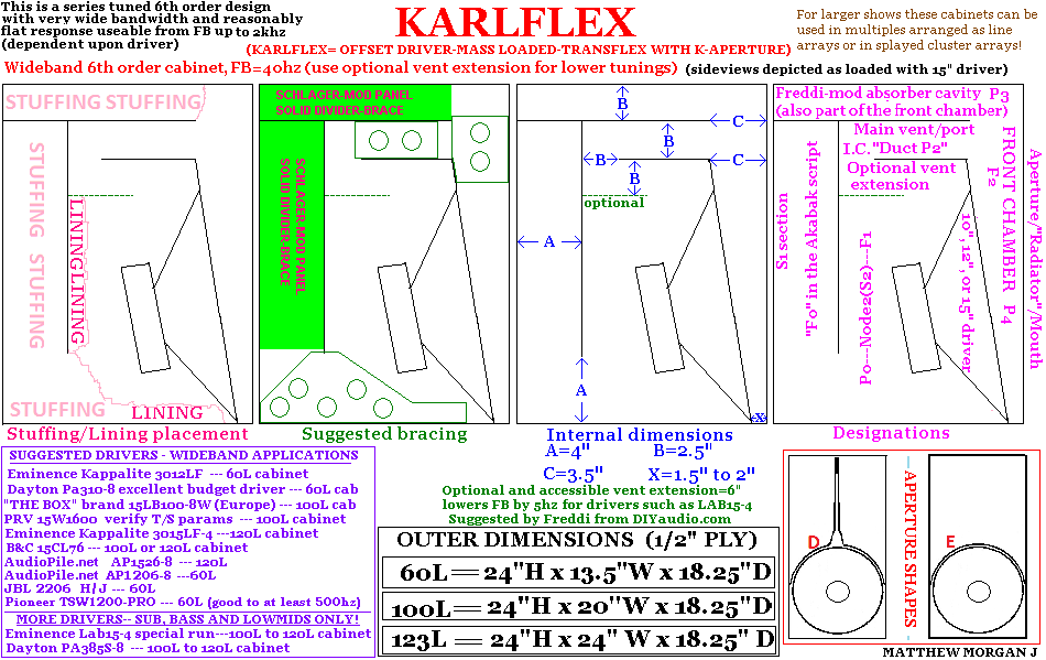

Sketch update ... Karlflex simple , with "Schlager-Mod"
Updated sketch![wrench :wrench: :wrench:](https://files.diyaudio.com/forums/images/smilies/wrench.gif)
Fixed a few minor errors, added a few drivers, and added the "Schlager-Mod" (should be used in the wider versions of this cabinet, but also can be used in the 60L cab if you want) ...
The Schlager-Mod is a divider panel which also acts as a brace and is meant to break up width related resonances within the S1 (offset) stub and the Freddi-mod stub ....
Updated sketch

THE KARLFLEX , some thoughts
As far as the KARLFLEX cabinet in general is concerned, it works
, and i am happy enough with the prototype turned out.... I have to say though that i prefer a bass rich sound as opposed to "dry" and as a single cab tuned down to 40hz i think i would have preferred the sound of a 15" PA driver for wide range usage in a Karlflex (at that tuning, as a single or a stereo set) ..... However with a 12" PA style driver in a SINGLE cabinet it seems to me that a higher tuning would have been more ideal (Freddi had the right idea on this) to subjectively balance the bass output with the midrange at the expense of extension ... ...... I emphasized the word "SINGLE" because with multiple cabinets everything changes of course as coupling and arraying of these cabinets will bring up the bottom end response more than the top end ......
FOR EXAMPLE: A set of 8 Karlflex-12 cabinets tuned to 40hz and used in some super portable PA system would be very effective with satisfying bass and no need for a subwoofer ..... Loading these cabs with Kappalite 3012LF would be especially potent in this scenario
, A "slot" of a sort could be reoriented horizontally and then the cabinets laid on their sides (making the slot vertical again) and stacked on top of each other (two stacks as a stereo set , basically a mini line-array rig), should provide sufficient dispersion and output right up to around 2khz max where some high frequency array can take over (NOTE: crossover point could be made lower for less comb filtering if you can afford an HF array that goes lower) ....... Anyway, that is all theoretical as it hasn't been done yet, but if anyone would want to try such a thing just get in touch with me and we can begin the development ..... Should be a fairly straightforward process since the basic cabinet has already been figured out ...
