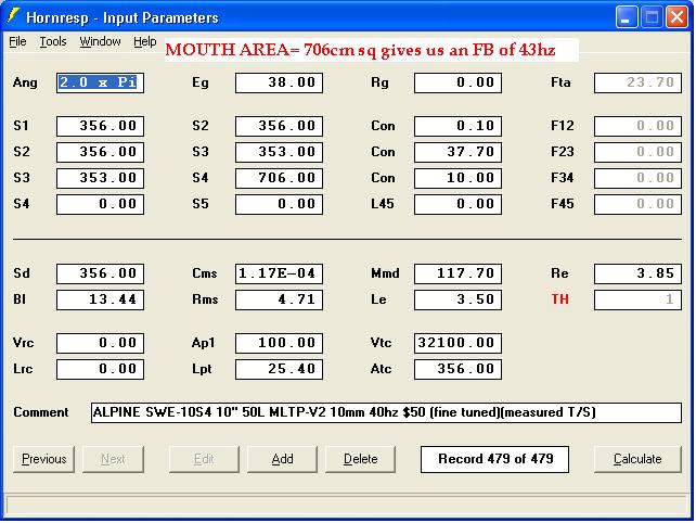

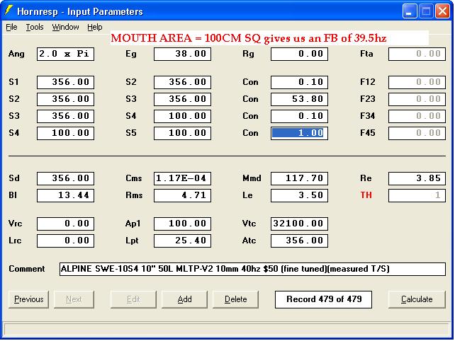

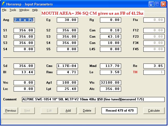

XRK, I believe you may be correct when you say that mouth area will definitely change the resonant behavior of the small chamber (higher midbass resonance) , the effect on this midbass resonance is likely to be more abrubt than the effect upon FB but still follows the same pattern of shifting upwards with an increased mouth area and shifting downward with a reduced mouth area .... Of course Hornresponse doesn't properly acknowledge the extra midbass resonance that the small chamber (or plenum or whatever we choose to call it) contributes so i can only demonstrate the effect on the box fundamental until i learn how to use Akabak ...
Take a look at the 3 attachments, the shift in FB is slight, but it does occur ....
Keep in mind that the '"magnet in mouth" arrangement (configured as it is sketched) shifts the FB down a little more, so these three examples are actually predicting on the high side, but of course we are "splitting hairs" here .......
