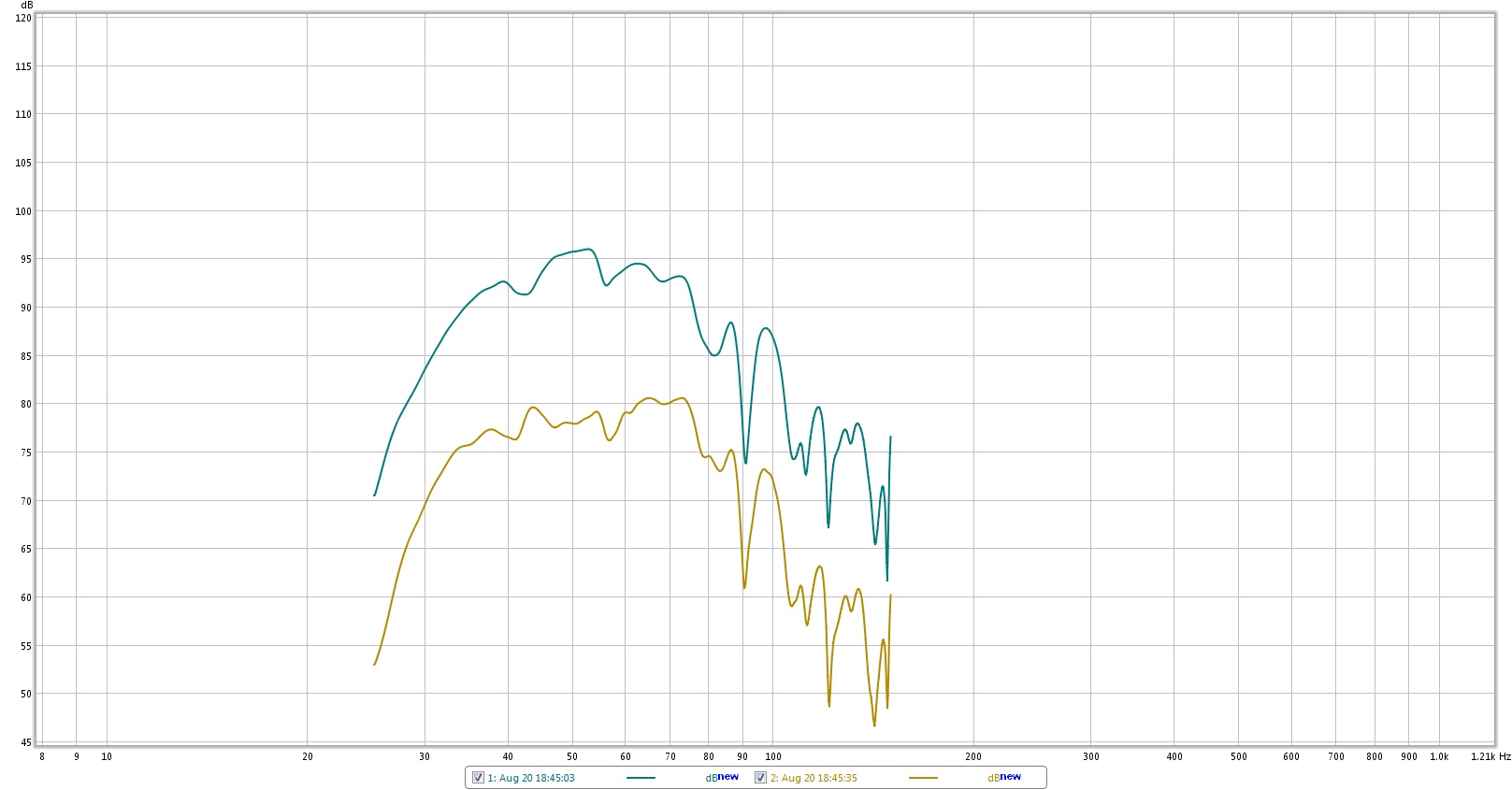

I seem to be getting a bit of that Here are two un-referenced test,the sweeps were done with the same microphone sensitivity, only difference was changing the "playback level". The louder of the two was bloody loud but I didn't check to see if the limiter light went on, don't think it did (oops). There is some EQ applied but it occurs in both sides so can be mostly ignored.
30 Hz shows an increase of 13.2 dB while 49 Hz shows an increase of 17.3
35 Hz shows an increase of 14.71 dB 66 hz shows an increase of 12.5 dB
40 Hz shows 15.8 dB increase. So yeah, take from that what you will.

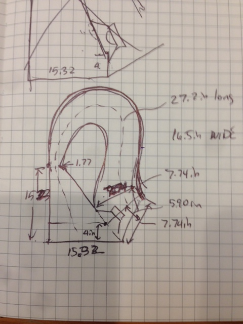

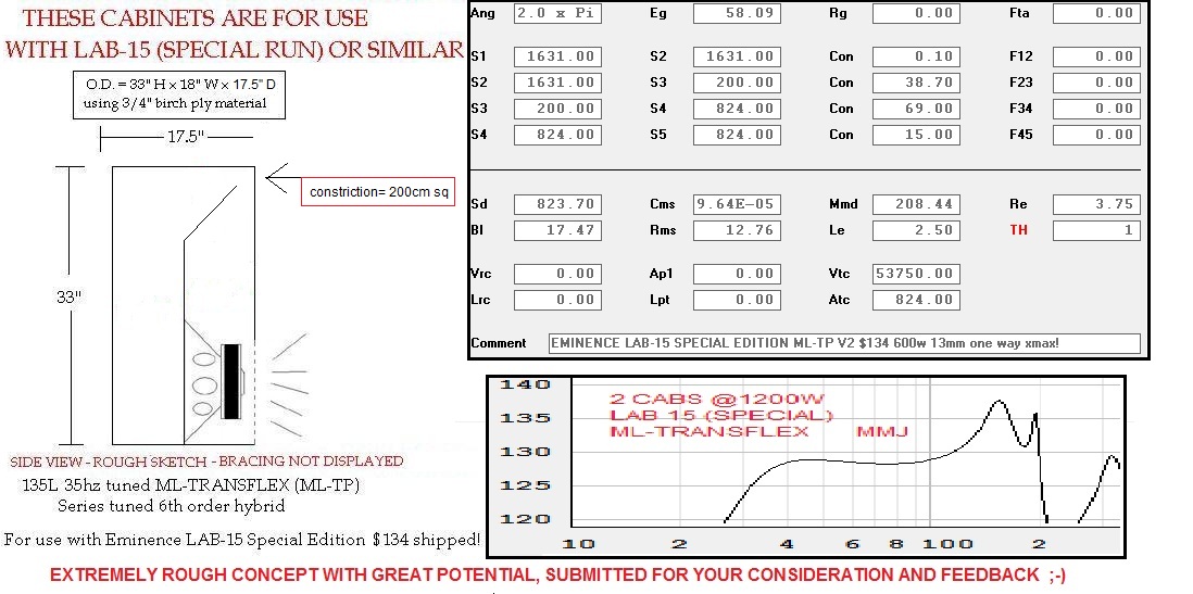

Matthew Morgan,
Your sketch shown here:
Looks nothing like the dimensions shown in the HR input page, which looks more like this (assuming 16.5 in internal width):

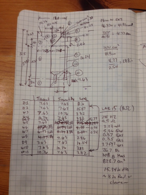

I actually built the Akabak model using your exterior dimensions sketch, which by the way, is more complicated than the last design as it has 12 flow elements vs 9. I deduced all the dimensions based on the 33 in (H) x 17.5 in (D) x 18 in(W), and 200 cm^2 throat (1.88 in x 16.5 in), and practical size of driver puts first segment at 8 in. Here is the sketch of the model based on your sketch:

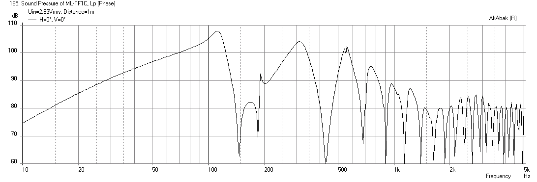

And here is what the predicted response of this box with the 8 ohm LAB 15 (basically, the volume is too small which is why it falls off so fast). Although, I may have a mistake in the code, I doubt it, I double checked the dimensions of the segment per the geometry I derived in the figure above:
You are going to have to do a little more work when it comes to realizing the physical topology given the 4 segments of HR. To build a box that resembles your HR inputs, it will look like my sketch above with the curved horn after the throat. You basically have a BVR (big vent reflex).
Here is the code if anyone feels like double-checking. Also useful if you just want to edit it as the skeleton of the design that is sketched by Matthew Morgan is there:

"I actually built the Akabak model using your exterior dimensions sketch, which by the way, is more complicated than the last design as it has flow elements vs 9."
"And here is what the predicted response of this box with the 8 ohm LAB 15 (basically, the volume is too small which is why it falls off so fast). Although, I may have a mistake in the code"
Hey there XRK ,
According to your hand written sketch that does look like work , thanks for putting this into Akabak .... 130 or 135 liters is enough volume for the Lab 15 , but i think it might not be clear about how the HR sim relates to the sketch .... The throat chamber has no port attached to it so it is basically just a big chamber with an open end that comprises the first 2 feet of the path which the S1 through S5 connect to... The path then proceeds to S1 & S2 which open up to a large area as it goes around the turn (the reason for the large cm sq area of S2) , then a squeezed down S3 creates the constriction , then below that there is another 30+ inches of path ..... It certainly works well with HR , not sure why it isn't translating to Akabak...
You are right that it is similar to a BVR , or even a Cubo but this box will have more quarter wave action because of it's longer path length , Cubos have a pretty short path
One thing that comes to mind is that since the pressure end of a classic quarter wave resonator is located at the closed end, and the max velocity end of the pipe is the mouth/terminus i would imagine that moving the constriction up the path (away from the mouth) could cut down on velocity since it is no longer the end anymore (the smaller segment does contribute to path length) which sets this design apart from any standard ML-TL
Yeah, it’s not a vent, it’s just a stepped open pipe segment connecting a larger closed pipe and reflex compression chamber, so its air mass ‘slug’ is trapped between two mismatching acoustical impedance junctions. In this context we can view it from the reflex side as the initial expansion in a BLH, ergo all we need to do in theory is taper it slightly, but in reality it’s well proven that using relatively short lengths of straight pipes laid out in multiple bends like Olson did with his BLH only rolls off unwanted HF content.

I am looking at Saba's high/low power graph right now ... The relative bump (or lack of loss?) centered close to 50hz is interesting .... Also , did you guys notice that around 80hz he is only getting a difference of about 10db versus 15-ish db near and just above FB (along with many other areas) ... ? That seems odd ..

Everything about those measurements (in relation to each other) is weird. I don't think there's anything to learn from these. Proper measurements need to be done outside ideally, at clearly indicated power levels.
If the sub, or the mic, or an object in the room moves a couple of inches this kind of thing can happen. And without a calibrated measurement or any indication of power level it's impossible to really know what's going on.
