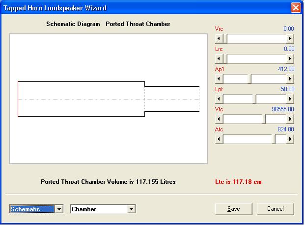

L34 becomes the new tap when S5 is disabled and S4 becomes the new mouth....... S5 isn't necessary in some cases , like this one ......
In this box the throat chamber and port make up the majority of the box and the S1-S4 only make up the very last bit of the path .....
Take a look at this screenshot of the throat chamber setup in my wizard ... Does it look the same on your end?
(by the way , Ltc and Chamber volume both just happen to be 117 by a random coincidence, i wasn't trying to make them match on purpose or anything like that )..

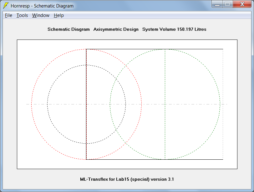

I inputted exactly what's shown and used the 'throat ported’ option, but if you total up all the volumes, it's only 63.2974 L, not 150 L, nor is there a L45/S5 length, so seems like you’ve posted the wrong HR record.

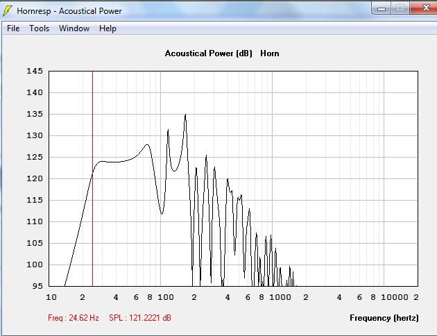

Hi GM,
Your schematic diagram should look like the attached screenprint.
Segment 1 = 0.082 litres
Segment 2 = 18.952 litres
Segment 3 = 14.008 litres
Throat chamber = 96.555 litres
Throat chamber port = 20.600 litres
Total system volume = 150.197 litres
Kind regards,
David
The use of the large throat chamber in HR re-purposed like a pipe was just a workaround in order to create the shape and sections that were needed , otherwise it is not possible in HR.
Hi MMJ,
A very innovative solution, and a great example of "thinking outside the box" - no pun intended
Kind regards,
David

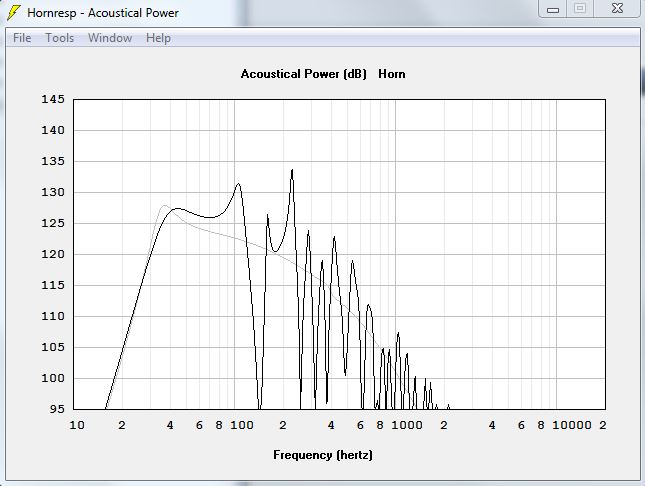

I should be able to get more but this is my 200 L TH vs Ported (2 drivers in both) comparison.
I'm sure the TH gods could squeeze out a few more dB but without increasing the size this is my best response to date.
*Note the dark line is TH, Ported is light grey.
The port in this case is huge to reduce port compression likelihood and the TH is a very nice <12 M/s although I really need someone to simulate what it is at the pinch off point (haven't settled on a gap size yet, working on it).

Will,is this two Alpine 12s endfire? Can low end of TH be extended more like the ported?
This is a single fold tapped horn end firing. May be able to make it side firing but I don't like the idea of constricting the output there. Also, this thing as shown is a little longer than I had hoped 215 cm L23
You can make the low end go as long as you want if you don't mind compound folding or making it longer, Here is if you grew it to 6 feet tall (external) Next to that is 300 cm path length with a wider cabinet, tuned to 26 (f3 of 25) and that it takes a slightly smaller signal, which is accounted for in the image -- 55.7 V (. Note that the larger cabinet is 12.5 cu. ft. internal and thus is approaching T60 size (21.8) But still has more output per cubic foot (ignoring power)

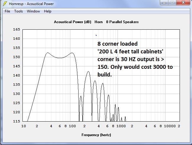

For grins this is corner loaded 300 cm path length "scaled up" version. Next to that is best case scenario '8' 4 ft external tall (185 L each internal) cabinets in a corner. Yeah I like that graph too.
I'll build for someone these 8 cabs for 6000, half up front to buy drivers and ply.

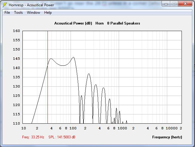

Finally, the same 8 cabinets without cheating in a corner (2pi)
This is 1-2 dB less than a TH812, but needs 8000 instead of 16000 watts. Major difference is this doesn't go near the 28 f3 unless in a corner (which is ~29.5).
TH goes for >10k. I'm only asking 6k. Throw in amp costs in that, 7.5k including 4 inuke dsp 6000's.
Any takers?
For reference that at full power is 120 dB at 16 M outside. That's what most concerts I know of run at (peaks).

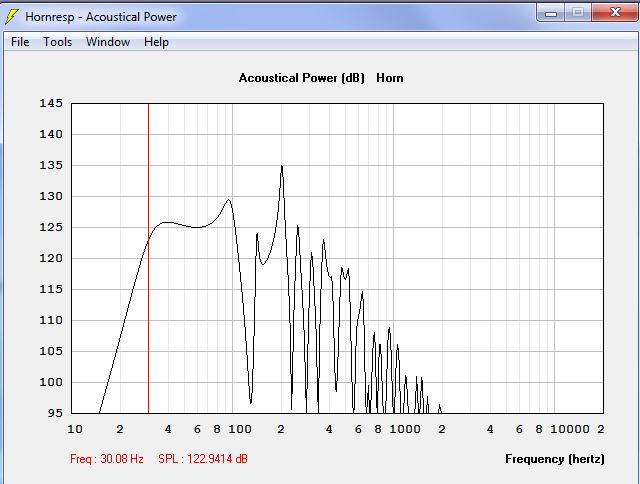

Here is ML-Transflex for Lab15 (special) version 3.1
The Tapped, Squeezed and refolded remix ... better than ever ...
Ready to go shopping for ply BeauB?
Path length in this box turned out better than i thought! Width had to be increased in order to offset airspace taken up by internal panels while also maintaining path area and lengths to match the HR model, but it is all worked out now
Around 7 foot of path length with the mass loading puts our FB right at 35hz ...
If i were a salesman i suppose the selling points would be much like before and they are as follows :
(for more enjoyment just imagine the following spoken by a high energy guy with an infomercial voice and a terrible suit, because it is better that way)
- Great output and extension down to the fundamental, meets rated linear excursion of this driver right at it's thermal power rating of 600 watts! So it is very well balanced in terms of well matched mechanical and thermal limits..
- Designed with 3/4" material in mind. Internal volume taken up by panels is compensated for, and then some (add 1/2 inch holed ply braces to the back panel and bottom panel if you like) .
- Driver fits into this box revision easily with some additional room to spare .. Easy access to driver... No removable panel required.
- Magnet in mouth (especially being the high velocity end of the pipe) provides superior motor cooling which results in less thermal compression, longer life and more output!
- Group delay , velocity, and phase response are all kept within acceptable bounds throughout the working range ..
- 32hz to 150hz useable response (3db down at 32hz with single cabinet)
- Very easy to add or experiment with optional damping and filling materials..
- Simple design, easy to build, reoccurring measurements throughout! , no difficult angles and no intricate woodwork involved... No wasted internal space ..Very efficient use of cabinet volume.. Thanks to Greg B and his Karlsonator for the fold inspiration ..
- acoustically shortened path by use of a mass loading constriction, which is a long vent at 50% of the main pipe's area, velocity at the port should not ever exceed 20 m/s in worst case scenario in the real world, with full power applied.(calculated by multiplying the velocity at mouth (*2 for the 2:1 mouth/port area ratio)
- Very affordable driver and low build cost for this class of performance
Saba,
Those graphs are showing some pretty monstrous output, for low cost herds .... If any venue takes you up on one of these deals you might want to have them sign a waiver saying that you wont be held liable for any structural damage done to their building

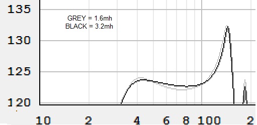

I don't think HornResp takes losses into consideration. Combine that with inadequately-braced construction and...
If the impact of Le is too low in the model, this should show up as a significant difference between the measured Vs predicted impedance curves at higher frequencies.
I don't doubt at all that much of the smoothing that we see in real-world cabs are due to losses from panel flex, lack of bracing and so on ....It might also be possible that the one guy's theory about David's LE algorithm being inaccurate is bogus ...
The effects of inductance are interesting though, i would have thought that high voicecoil inductance would mainly just cause attenuation of upper frequency response , but what we see it doing to the lower response in our sims is notable ...
With doubling of the LE: underdamped saddle responses flatten out , and initially flat responses turn into overdamped humps with shallow roll-offs .....
It all leads me to think that drivers with lower LE figures could work well in boxes that are slightly smaller (If all other driver parameters are the same in our hypothetical example)...

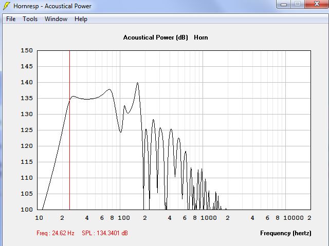

I am posting a screenshot to show what influence on response the doubled LE has upon this particular Lab cab (a single cabinet at 600w) ... Not a whole heck of a lot of difference, but it is there ..... and the measured response of this will most likely resemble the black line instead of the grey line , but due to what factors? Its hard to say .... What i do know is that i have seen some of your (Brian's) tapped horn measurements compared to sim with stock LE (i think it was POC#3?) and the curves matched up very well if i remember correctly ....That box was well braced , so that supports what you say about the curves of built boxes being more altered by panel flex losses as opposed to some issue with LE in sims ...
