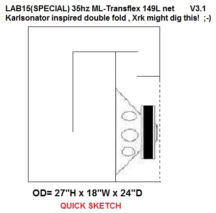

The Genius behind the Karlsonator fold is GregB. I just modeled it in AkAbak. Your sketch resembles the Karlasonator although you don't have an expanding pipe before the constrictor. A so called reverse TQWT MLTL 6th order bandpass with Karlson aperture is the full description.
Is he still around? His fold style was an exceptional solution to making a physical manifestation of the HR sim for the Lab15(special) Ml-transflex ...It worked out perfectly as far i can tell ...Such a good match ... I cannot believe how easily everything just fell-into-place once i switched to that dual fold scheme ... I suppose i should let Greg know that i used it and say thanks to him ..

Yes, Greg B is here and quite active in the forums and especially Fullrange forum. You should check out his image archive called "Stupid HiFi Tricks".
Before I even ran the sim with the scaled Karlsonator I knew it would work with the Lab15 - I have simulated probably more drivers in that alignment than anything (about 50 drivers) and almost all of them could be made to work with the right adjustment of height/depth and width. A driver with Qts from 0.35 to 0.65 works very well in it. Even high 0.9 Qts can work, albeit, larger volume but bot a problem for smaller 2 or 4 in fullrange drivers. Send Greg B a PM if you want him to see what you did with his design. Or post your ideas in the "Karlsonator" thread in Fullrange.

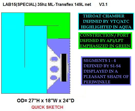

I made a Hornresponse correlated color key sketch for this Lab15(special) cab , check out the attachment ..... It made it colorful !
![happy2 :happy2: :happy2:](https://files.diyaudio.com/forums/images/smilies/happy2.gif)

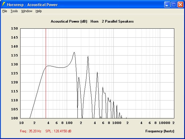

The finishing touches on the LAB15(SPECIAL) CABINET
This is all of what i have so far for the newest and most refined version of the Constricted-Transflex cabinet or ML-TP , or series tuned and mass loaded 6th order bandpass for the LAB15(SPECIAL)... I need to settle on a name for the alignment and stick with it ...
This should hopefully be the final version ... I might only make a few minor tweaks to the HR inputs but other than that this is pretty much it ! (Unless one of the Akabak gurus spots some insurmountable problem with it, but that is unlikely
, this box is fairly straightforward) ..
I think we may have a winner here for Eminence driver, but i don't want to speak too soon !
This has been a learning process ....
Thanks to GregB for this fantastic fold style!
I will probably put all of these sketches and screenshots (along with a little more data)together into a single patchwork collage jpeg so it is a single file ....
Lab15-Special-35hz-ML-TRANSFLEX-DOUBLE-FOLD-149L-INPUTS.jpg59.9 KB · Views: 229
Lab15-Special-35hz-ML-TRANSFLEX-DOUBLE-FOLD-149L-KEY.JPG41.3 KB · Views: 216
Lab15-Special-35hz-ML-TRANSFLEX-DOUBLE-FOLD-149L-RESPONSE-2CABS-HALFSPACE.jpg47.3 KB · Views: 216

Wow - as soon as we have a finalized, dimensioned drawing - I'll be at Ganahl buying wood.

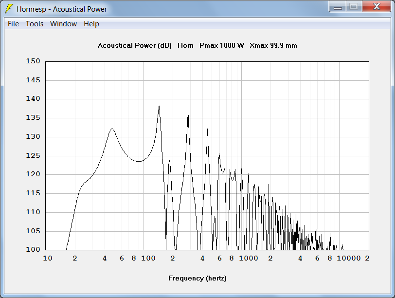

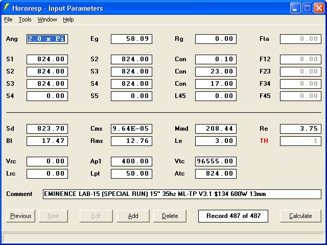

I just want to make sure that when i am doing simulations that i am actually giving the driver the appropriate amount of wattage in the model
Hi MMJ,
No matter what value of Eg you specify, the voltage will still be constant, which means that the electrical input power will vary significantly with frequency due to changes in the system electrical impedance. (Select Tools > Sample from the Acoustical Power window and move the frequency slider to see how much the electrical input power can change with frequency).
Constant electrical input power can however be specified in lieu of constant input voltage by using the Maximum SPL tool with Pmax set to the desired input power and Xmax set to 99.9 to prevent any displacement limiting. (The attached example shows the response for the design given in Post #531, assuming a constant input power of 1000 watts).

I know that you and Mr Sabaspeed are right about that, the impedance changes radically through the usable range and current draw is associated with that impedance so electrical input (wattage) is also following those same radical curves in an inverse tracking fashion..... I totally get that part and i totally agree with you guys on it .....
I guess i am just looking for a more valid reference for calculating voltage ....
Between different makes and models of drivers the RE varies so much it seems to me that the manufacturer's generic label of 4 ohm or 8 ohm isn't specific enough ... Although i do acknowledge that there is probably more to determining a driver's impedance rating than just it's RE, it hasn't stopped me from trying to "roll my own" impedance figure for the purpose of inputting that figure into the Eg's voltage calculation popup window, (I do this however with the understand that the way i derived this impedance figure is likely oversimplified because ideally other factors like reactance should also be taken into account , right? ...So it is just an approximation ....
Nevertheless i think that the impedance figure that i am coming up with is at least more accurate than the generic "nominal" impedance that the manufacturers give us , and that helps me more accurately create the equivalent voltages for comparison's sake in simulations ....
So for example, instead of just plain 4 ohms we could consider a driver like The Eminence BP102-4 (referred to in post #498) to have an impedance of 3.78 ohms which is pretty darn close to 4 ohms , so a person might say: "whats the big deal?!?" right? The problem is that using the same standard (RE*1.4) implies that the Eminence Legend 620H is a 5.5 ohm driver, even though both drivers are labeled by Eminence as "4 ohm" and this can cause comparative simulations to be misleading if inputs are done in the standard way (by using the generic 4 ohm figure to calculate voltage)..

Hey there Saba ,
Reverse taper designs can be created as either tapped or not .... Either way can be made to work , generally the tapped version will allow a box size reduction but it may come at a cost of slightly reduced SPL... Sometimes a bit of tapped effect helps , sometimes it hurts , depends on the situation really ....
You can use any of the modes in Hornresponse to design reverse taper alignments, i would most often use OD or TH mode for something like that though because that allows having an offset driver, which is how most of my cabinets end up being configured , even if the driver offset is only half of the driver's diameter (because the woofer is loaded into the side at the end of the pipe)
ND and CH modes model the driver as being plugged in to the absolute end of the pipe with no offset whatsoever...
Reverse tapers work the same way that Mass Loading , mouth shading, ports and constrictions work to reduce physical path length.... Bass doesn't care whether or not you accomplish that in steps or if you do it in a long slow constriction .... With the absolute extreme being a Bass Reflex box (but at THAT extreme there is not nearly enough path length to provide any useful quarter wave action, so performance suffers, and the moral of the story is that you only want to take these path length reduction schemes so far ..... too much of a good thing can definitely be a bad thing , so find your "happy place"
In the ML-Transflex for the Lab15(special)we have just a bit over 6 feet of path length for a 35hz box , so the path is just moderately shortened which gives us great performance in a tidy package
In AkAbak I plot the electrical power vs freq at a fixed voltage and you can see how that changes. Then set the peak power to match ratings by adjusting voltage. That is max voltage. Takes impedance changes and Re into account.

That's one way to do it. I just sweep the impedance curve, give like a 10-20% buffer and then use that. Most subwoofers have an impedance low spot of darn close to Re. E.G. 7.1 vs a Re of 7 for one of the designs I considered. But I consider it 8 for finding a starting voltage because there are some frequencies with significantly higher impedance. My reasoning is that any bass note with exactly Fs will have a spread of power plus or minus about 3-4 Hz at the least and thus an average impedance will help find the average impedance at the speaker. If you're running sine waves at FS or play certain genres you may just want to be a little more careful, but most subwoofers rated for 500 watts rms have no problem peaking in the 600-700 range so long as excursion is kept in check (and Xmech for sws12d4 is like 25 mm 1 way so I'm not worried about that) they just can't dissipate more than an average of 500 watts at the voicecoil for extended periods of time.
I'm sure most of this you already knew or suspected but I thought I'd mention it.
