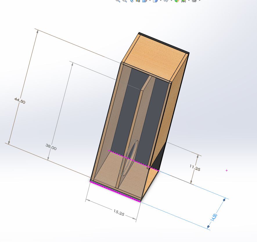

Can anyone here verify that my path length is correct? Driver is 6.5 inches (meaning the center of the driver cutout) from the bottom panel and as far as I know the simulation matches this... Just someone put it into AKABAK (a shorter version) and his path length was different. Note 3/4 inch material.

Ok , here we go
I am pretty proud of this one![]()
Version 3
Still a very simple design, and this one is 100% compatible with HR's segments, chambers and ports so this curve should be close enough to what you will get in real lifeSomeone out there could still try to Akabak it if they want, it should be a lot easier with this one because it is relatively straightforward compared to the last version i uploaded ...
I plan to make this my final version of the ML-Transflex for the LAB15 special..
I will get a sketch drawn up for this thing tomorrow , dimensions are very similar, i just have to extend one dimension to allow for a few more liters of internal volume ...
- Great output
- Low group delay
- Excursion stays below 13mm at a full 58v (600w)
- driver is easily accessible without the use of a removable panel
- efficient use of cabinet volume, no wasted space
- simple single fold design, easy build, all straight panels, no angles
- acoustically shortened path by use of a mass loading constriction, which is a long vent at 50% of the main pipe's area, velocity should not exceed 20 m/s in worst case scenario in the real world.(calculated by multiplying the velocity at mouth (*2 for the 2:1 mouth/port area ratio)
- Very affordable driver $134 shipped, get em while they last!
- Woofer's motor is located in the mouth (the high velocity end of the pipe) which maximizes cooling of the voicecoil ! Which equates to reduced thermal compression when used at high SPLs for extended periods of time.. Longer life, and more output!
- well balanced bass output, just the right amount of damping.
Do you know the external dimensions of the revised enclosure?

The external dimensions will be very similar, i think i will try to keep the same width and depth, and just increase the height by approximately 2 inches to make room for the additional 10 liters of internal airspace
