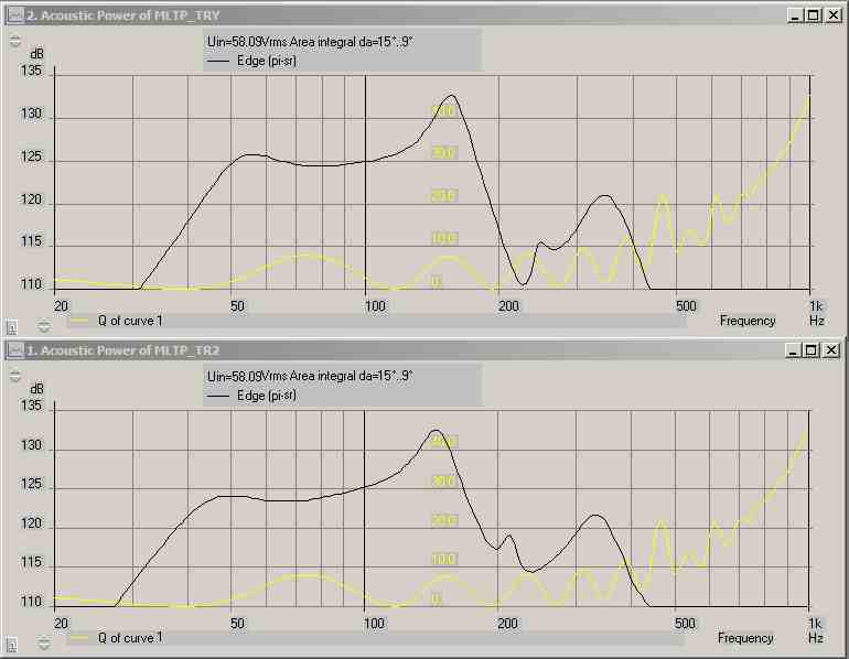

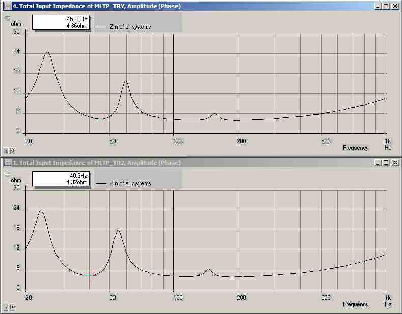

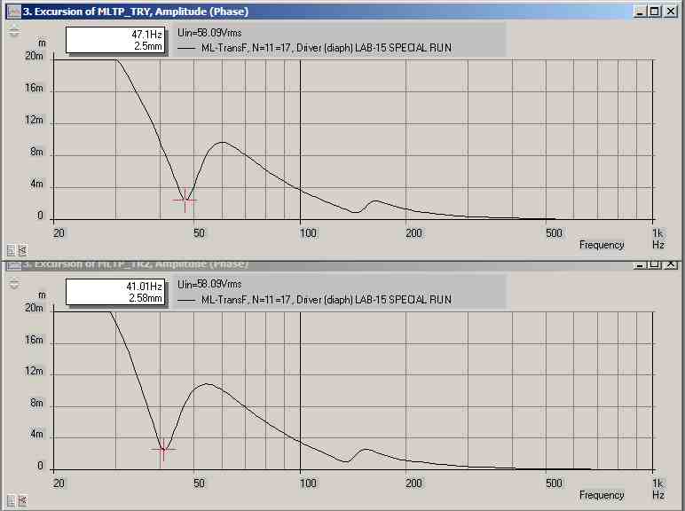

Hi Matthew Morgan J,
Post #462: "...Is it possible that there might be some path length or volume that was somehow left out..."
Yes, you are correct, one section had the wrong length. Here is the error correction: changed waveguide 'W4' Len=2.625in to Len=10.297in.
In the attached pictures the original one is on the top, and the corrected one is on the bottom (the ones where everything is a little lower in frequency).
It's interesting how much of a difference those 7.672in make. Looks like to get lower the overall duct length will have to be increased. Nothing new there

TB46 ,
Fantastic! Looks like you are getting a lot closer to what HR was giving me
If in the end it turns out that there just simply isn't enough path length in that configuration to get the FB down to around 35 then i can make some changes to the HR model in order to fix that... I think i am about to drop the idea of using flares around the constriction altogether anyway... Since my new goal is to keep the constriction to between 33% and 50% of the main path's area i really don't think that the flares will be necessary (at the m/s rates that will be generated with these drivers) .. ...

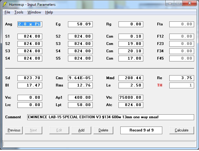

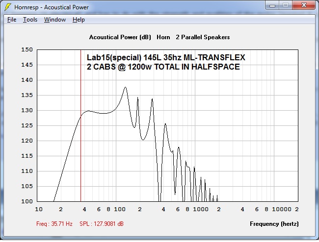

UPDATED (AND LIKELY FINAL) LAB15(special) ML-TRANSFLEX!
Ok , here we go
I am pretty proud of this one
Version 3
Still a very simple design, and this one is 100% compatible with HR's segments, chambers and ports so this curve should be close enough to what you will get in real life
Someone out there could still try to Akabak it if they want, it should be a lot easier with this one because it is relatively straightforward compared to the last version i uploaded ...
I plan to make this my final version of the ML-Transflex for the LAB15 special..
I will get a sketch drawn up for this thing tomorrow , dimensions are very similar, i just have to extend one dimension to allow for a few more liters of internal volume ...

- Great output
- Low group delay
- Excursion stays below 13mm at a full 58v (600w)
- driver is easily accessible without the use of a removable panel
- efficient use of cabinet volume, no wasted space
- simple single fold design, easy build, all straight panels, no angles
- acoustically shortened path by use of a mass loading constriction, which is a long vent at 50% of the main pipe's area, velocity should not exceed 20 m/s in worst case scenario in the real world.(calculated by multiplying the velocity at mouth (*2 for the 2:1 mouth/port area ratio)
- Very affordable driver $134 shipped, get em while they last!
- Woofer's motor is located in the mouth (the high velocity end of the pipe) which maximizes cooling of the voicecoil ! Which equates to reduced thermal compression when used at high SPLs for extended periods of time.. Longer life, and more output!
- well balanced bass output, just the right amount of damping.
