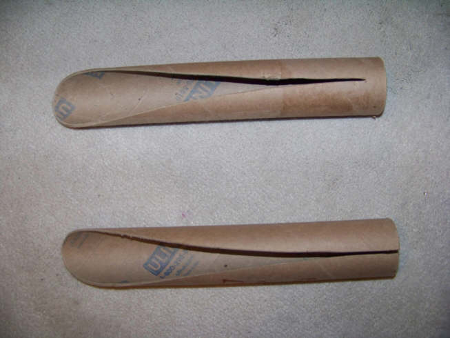

Thanks for the additional picture. Is the 5.3" length above the flange, and how thick is the flange of the Transylvania K-tubes? Your schedule 40 pvc tube looks good. I make the slotted length 5.5", and left a 3/4" bottom stub to be cut to length during fitting of the tube to a flange.
Post #1760: "...is the tube on the left 1"ID? how did you manage the taper on the other tube?..."
Both were made using the development in Post #1754 (1/2 of an ellipse), the viewing angle makes them look different.
I used the fiberglass tubes I described in Post #1757: "... fiberglass tube that are ~ 1.020"O.D. w/ a .030"nom. wall. Rough measurements confirm that the I.D. is about .960" to .963"..."
I found some 2"I.D. cardboard tubes, those should be fine for the 12" long "von Langa" tubes (?).
the Transylvania tube I grabbed is roughly 5 3/16" above the recessed part of the flange - add about 1/8" and a hair to that for its overall length from throat to tip. This tube has a roller pin fitted crosswise (gotta charge my camera) for whatever craziness the makers seemed to think that made a difference. IIRC the late Ernst Beck had some tubes drilled but missing the roller pin so he thought the holes significant
- once I get a picture, you can poke a little 1/8" diameter dowel piece down in the tube and wonder for yourself.

Hi freddi,
Thanks for the additional data. So we have 5-5/16" (5.3125"nom.) from K-tube throat to tip. Looking forward to your pictures of the roller pin. Maybe to kill some particular resonance peak?
I butchered a piece of 2"I.D. cardboard tube, that was easy enough. I cut the slot on one tube all the way through to the throat, and it's interesting to see, that you can open up the throat, and the section towards the tip does not seem to change. This may be one way to get some slope into the K-tube. I have the development attached in two parts, that way it fits on 8.5x11 paper using 1:1 scale. Again, it's for 2"I.D. and 12" length, 1/2 ellipse.
