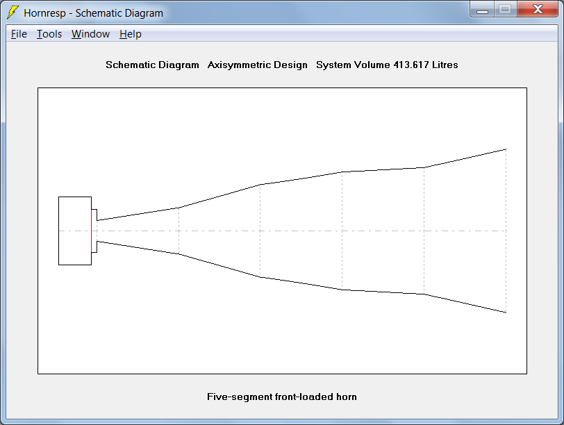

just one more segment
I agree !! With one more section in Hornresp we could get so much closer to modeling this type of cabinet ...
As it is right now we just fall short of being able to properly model the offset driver with the proper interchamber duct (to define where the rear chamber ends and front chamber begins) simultaneously ........ I have found ways to simulate those features independently but not at the same time in HR....
At least it is easy to model the equivalent simple aperture in HR , or "round aperture" as Schlager calls it
(just not the classic K-slot) .....................BUT it doesn't matter since Hornresp was not really intended to properly estimate high frequencies anyhow so there is no point in trying to create a K-slot in HR, just shift the L45 all the way to the left in "Loudspeaker Wizard" (.1cm) to get an idea of what the response in the bass-range can be like with a K-aperture of some sort (slotted or round)
This is what i refer to as my "quick and dirty" HR method which is in fact very quick and very rough but serves it's purpose well... It is what i use to get an idea about what the bottom end contour will look like and how much total internal volume will be required for any particular driver, for more detail you have to build an intricate Akabak model, but this is a good place to start, just a preliminary test just to see if a driver will qualify (to figure out if it is something worth pursuing)..
The basic schematic ends up looking like this:
We need one more section-please.

re: one more hornresp section, what has David said so far as to its feasibility and if he might do it?
Hi freddi,
The way that Hornresp is structured, the addition of a fifth segment would require a complete re-write of the program. This is not something that I am in a position to do.
For a conventional front-loaded horn system it is possible to use the throat adaptor feature to include an extra cylindrical or conical segment at the throat as shown in the attachment, but that is all.
Kind regards,
David
