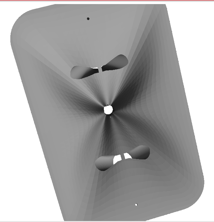

Here's Nexus Four:
As mentioned in previous posts, I wanted to shrink the footprint, and ideally make it a two way.
I think the jury is still out, whether it's possible to make a full range Unity that's a two-way, but I'm willing to take a few cracks at it.
I think if you look at Nexus One and Nexus Two, I think the high frequency response suffered because I used a dome tweeter instead of a compression driver.
I think if you look at Nexus Three, the performance was superior to Nexus One and Two, but it was bigger than I'd like.
So... Nexus Four is an attempt to compromise between the three designs.
The STL file is attached. I haven't printed or measured it yet, so stay tuned.

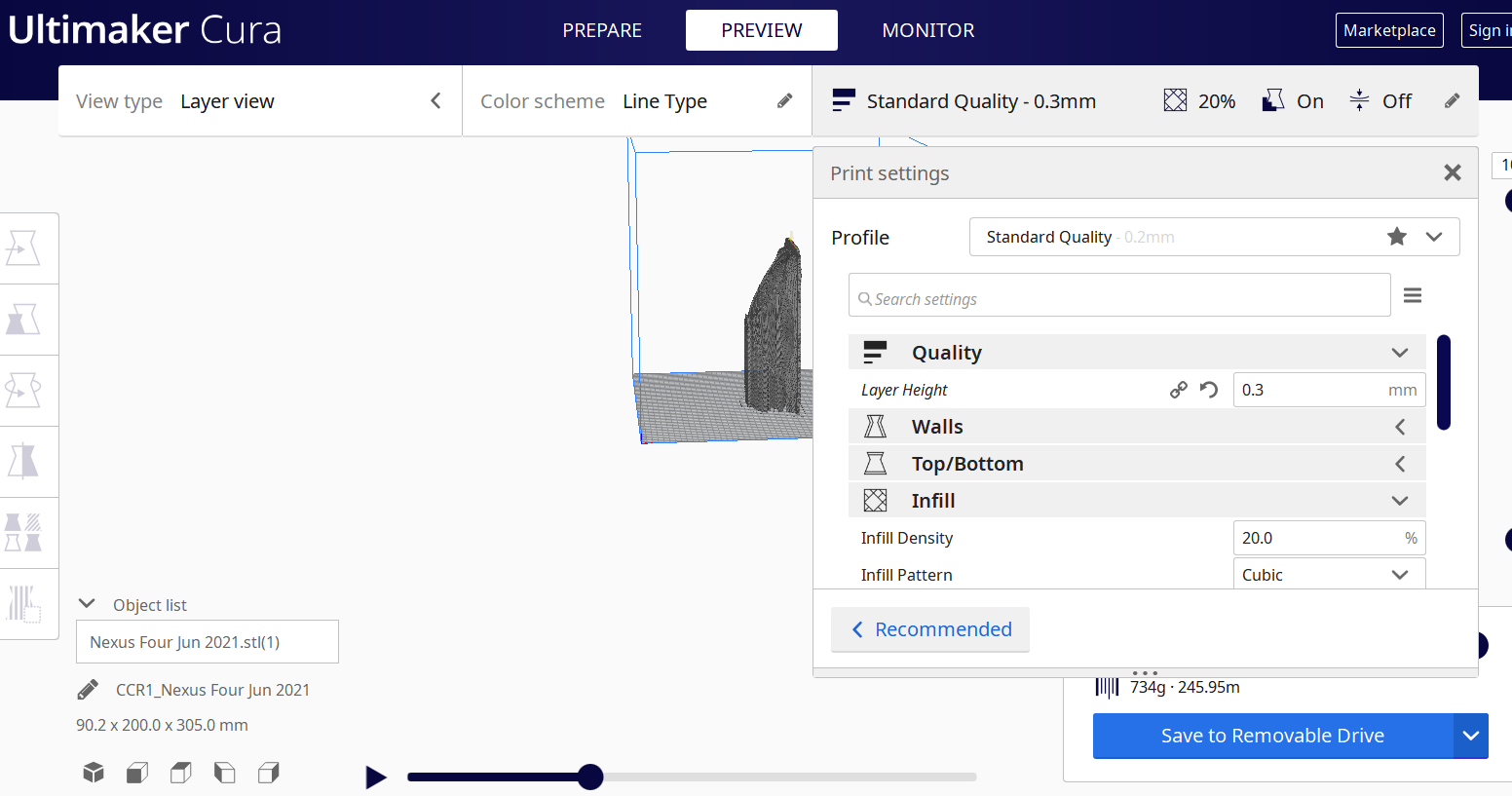

Looks awesome, looking forward to measurements as good as the waveguide looks.
Took a quick look and imported the model in cura to take a look at the size and printing time. I positioned the waveguide looking up so there will be no support material on its surface. Its a week project, unless there is a better wy of setting the printers.
![CURA_NEXUS4.png CURA_NEXUS4.png](https://www.diyaudio.com/community/data/attachments/872/872100-f0e93d1a160b0055ac4bda23a83d85c3.jpg)

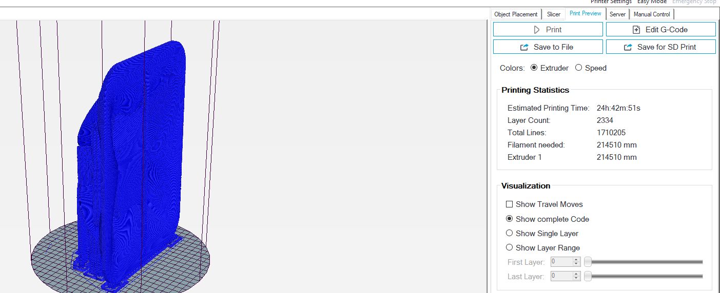

I rub your settings and I still get a slower time. I have a crealty 10 5s. What Slicer are you using, I would like to install it and compare time to find out if the slicer is inefficient of if it the printer is slow. More than twice the time and filament. New unit and just going trough the learning phase paint

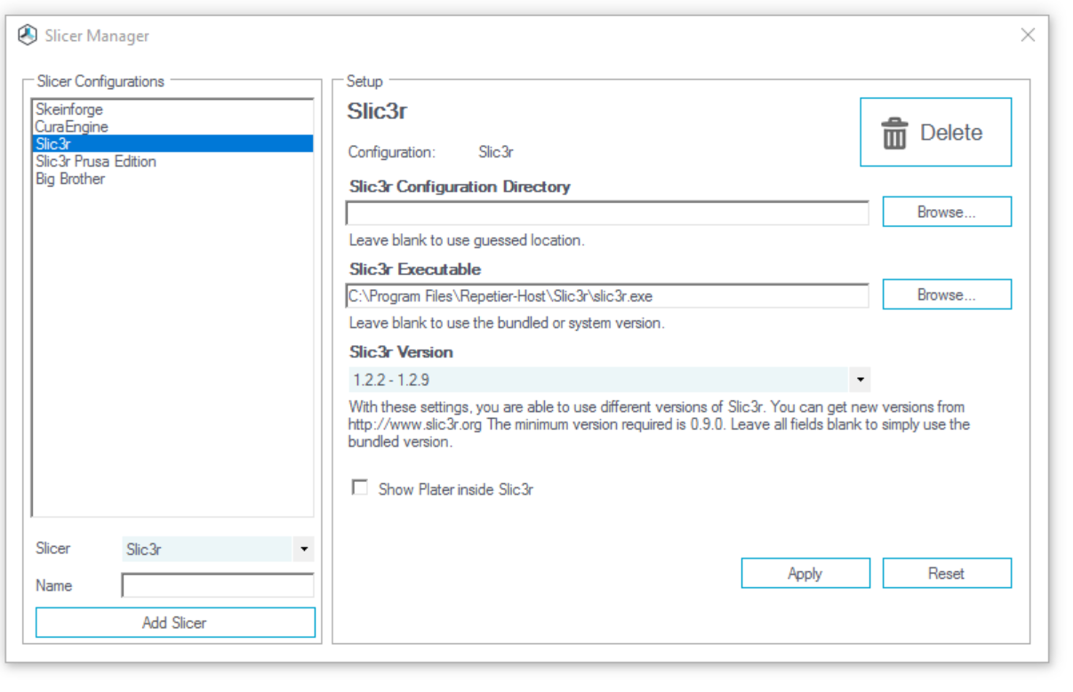

I always get much faster print times with Repetier Host. I honestly can't understand why people like Cura, I hate the fact that it lacks so many basic functions that Repetier has.
I have been printing and doing 3d design by proxy for years, but this is my first printer. Cura has a definite advantage, 100's of profiles for any printers. As a plug and play brainless solution, its rather simple. Its all about return of investment, aka, how much labor required make a system works, and the Cura with a sd card its a very simplistic single software solution with no network config. Sometimes simplicity can be a bliss.
IMHO, the worst part of the package is the 3d manipulation controls, unresponsive compared to other packages (simplyfy3d)
I installed Repetier today. Looking for a definition file for my crealty dr105s. For sure beats cura on functionality and expandability. Will move my workflow to Repatier as soon as I can get all configured. Sometimes simplicity is is not a bliss.
To my understanding, Repetier does not have a slicer; curious to see which one are you using to get better speed (from Repetier manual) Slicing - Repetier-Host Documentation
