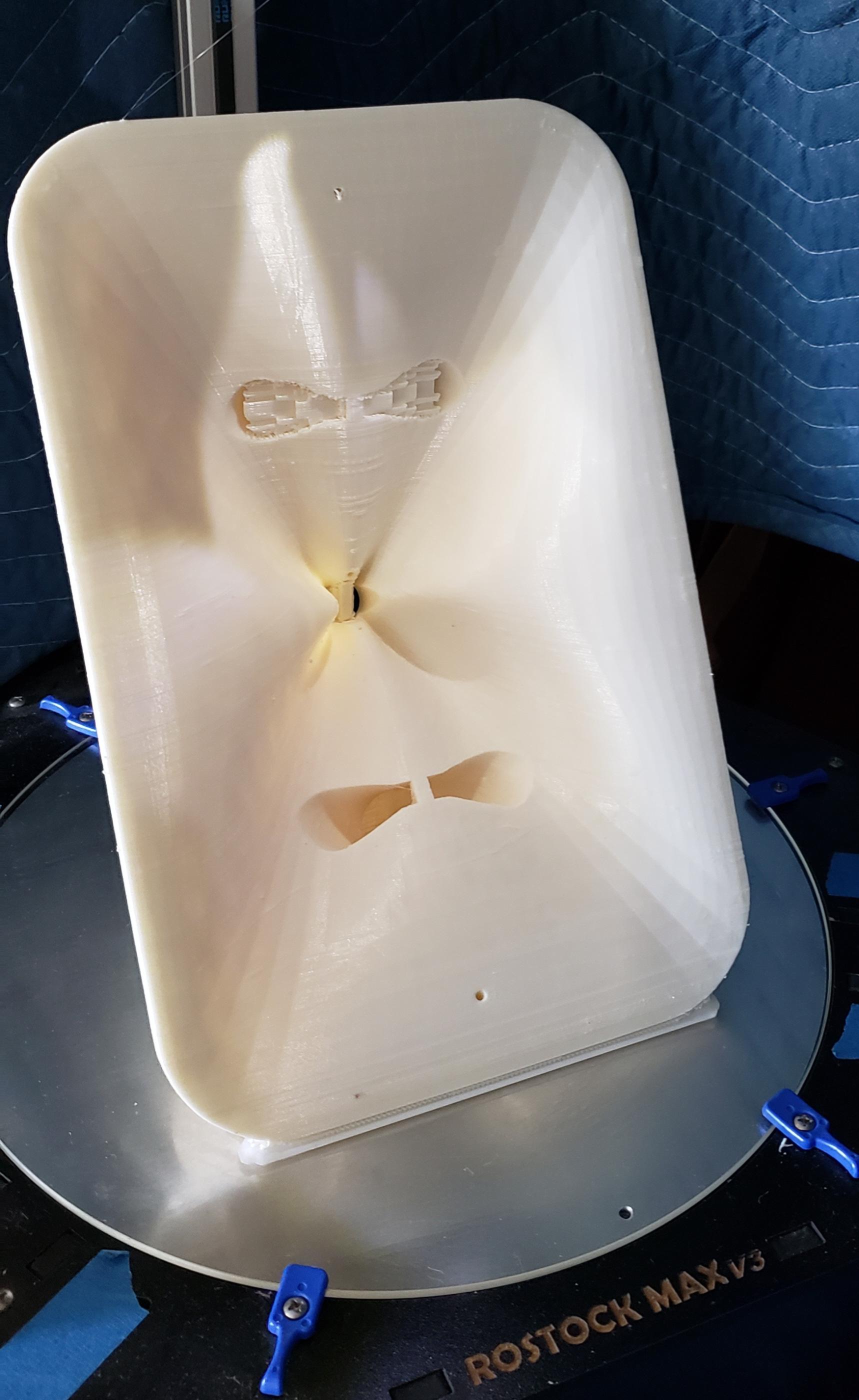

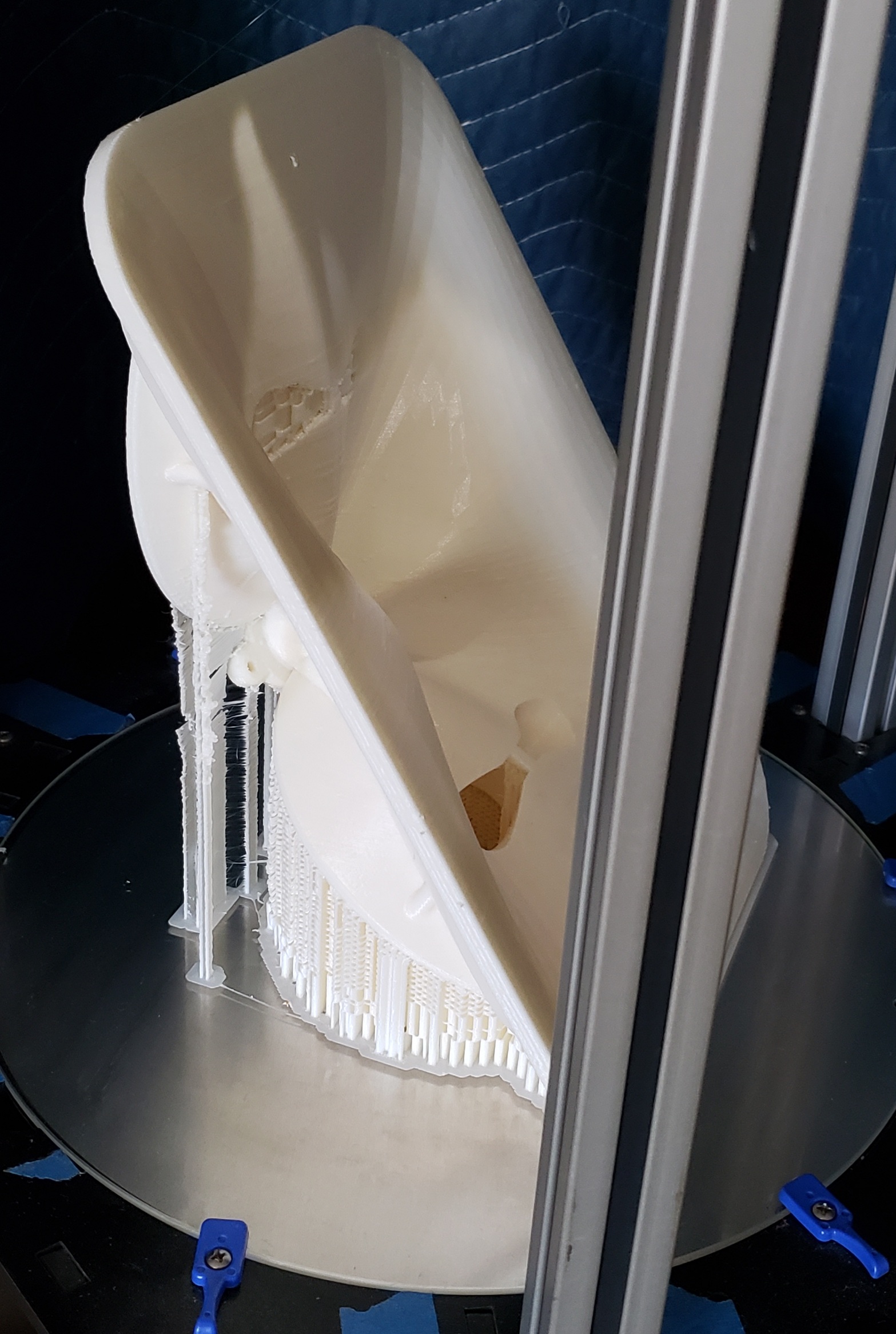

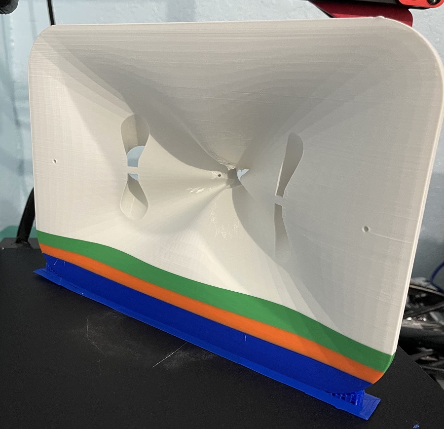

I printed the waveguide in ABS. Took about 28 hours and came out pretty good. I'd really prefer to print this exit-up, but my build surface is only 300mm diameter.
I would give anything to be able to make prints like that :O
I like the blanket idea that you have going on there. I should try that.
I've built a couple of enclosures for my 3D printers, but have never been 100% happy with them because they make it difficult to interact with the print. IE, if you have a box that covers up the entire printer, it seals the heat in, but then if you need to fiddle with the extruder or get a good look at the print, you have to remove the box that's covering the printer, and that's a pain.
A plain ol' blanket is probably a more elegant solution.
Another tricky thing for me, is that living near Vegas there's a near constant air circulation in my house because the AC is running nearly 24 hours a day. I have the vents closed in the room where my printer is, but there's always some air that makes it through.
Thanks. I had terrible warping with ABS until I bumped up the build surface temperature to 100C and started using the blanket. It's a Harbor Freight moving blanket held to the printer frame with large binder clips. It works very well and leaves surprisingly few air gaps.
I check the first layer, then have a peek every few hours to make sure I'm not making spaghetti.

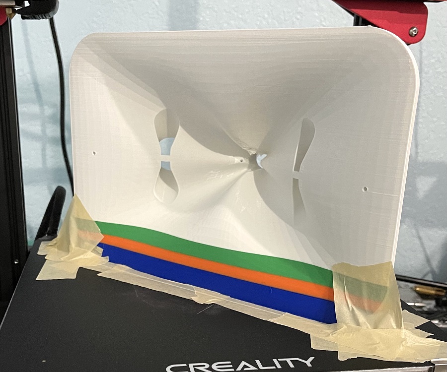

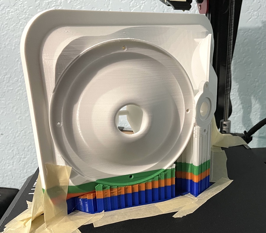

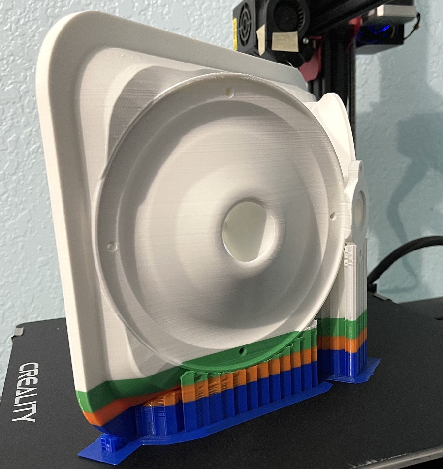

Nexus Four
Thank PB

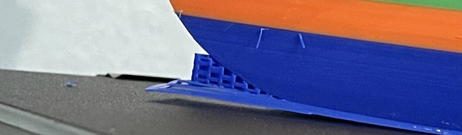

I got it done in 66 hours, Cura predicts 53 hours
PLA
50% infill
Brim support to built plate
205C nozzle temp
70C built plate first and second layer the rest room temp ~27C average
No blanket or box
one issue at the throat (in red circle) will sand it down, might affect the response? time to try Slic3r...
Print feel very solid, I am happy the result.

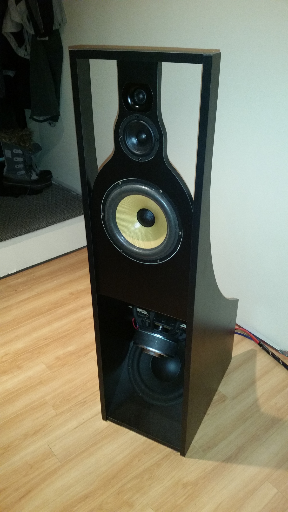

why do you use midrange left and right,
and not like D'Appolito, top and bottom?
The short answer: it works better.
The long answer: In a D'Appolito array, you have really strong off-axis nulls, and if you're not careful with the spacing, there's more sound hitting the floor than going towards the listener!
This is really bad; it basically ruins your imaging and hurts intelligibility too.
The reason that it happens, is because with certain spacings, the two woofers in an MTM will be in phase at 90 degrees off axis. In particular, if you have one-wavelength spacing, the woofers will be in phase at 90 degrees off axis.
Many of the contemporary midrange-tweeter-midrange designs use much tighter spacing than was typical back in the 80s and 90s.
For instance, the Horbach-Keele design uses a spacing of 55% of a wavelength. The reason that they did this, is that when the spacing is close to one half wavelength, nearly no sound at all will radiate towards the floor.
IE, if you have two midranges, and they're spaced at 50% of a wavelength, then they will nullify each other at 90 degrees off axis. (Because they're 180 degrees out of phase.)
But the challenge with using such tight spacing in an MTM is that it forces you to use a very small midrange, or a very low crossover point on the tweeter.
In this classic MTM speaker, the "Focal Aria 5", if the designer had opted for a spacing of 55% (like Horbach Keele advise), the crossover point would have to be 619Hz!
Obviously, that's completely impractical.
In the Horbache Keele design, they instead go with very small midranges - just 2" in diameter.
For more info on off axis nulls, check out my post here:
What Causes Off-Axis Nulls?
My "Nexus" speakers are shamelessly inspired by Donald North Audio. The DNA design accomplishes three things:
1) Because the array is symmetrical, the beamwidth is symmetrical. (A D'Appolito array is not symmetrical.)
2) Because there are twice as many midranges, you can use smaller midranges. This allows for a higher crossover point, a smaller tweeter, or both.
3) Probably the biggest advantage of the array, is that the midranges in the center 'fill in' the off-axis null of a D'Appolito, and they also reduce the severity of the off-axis peak of a D'Appolito.

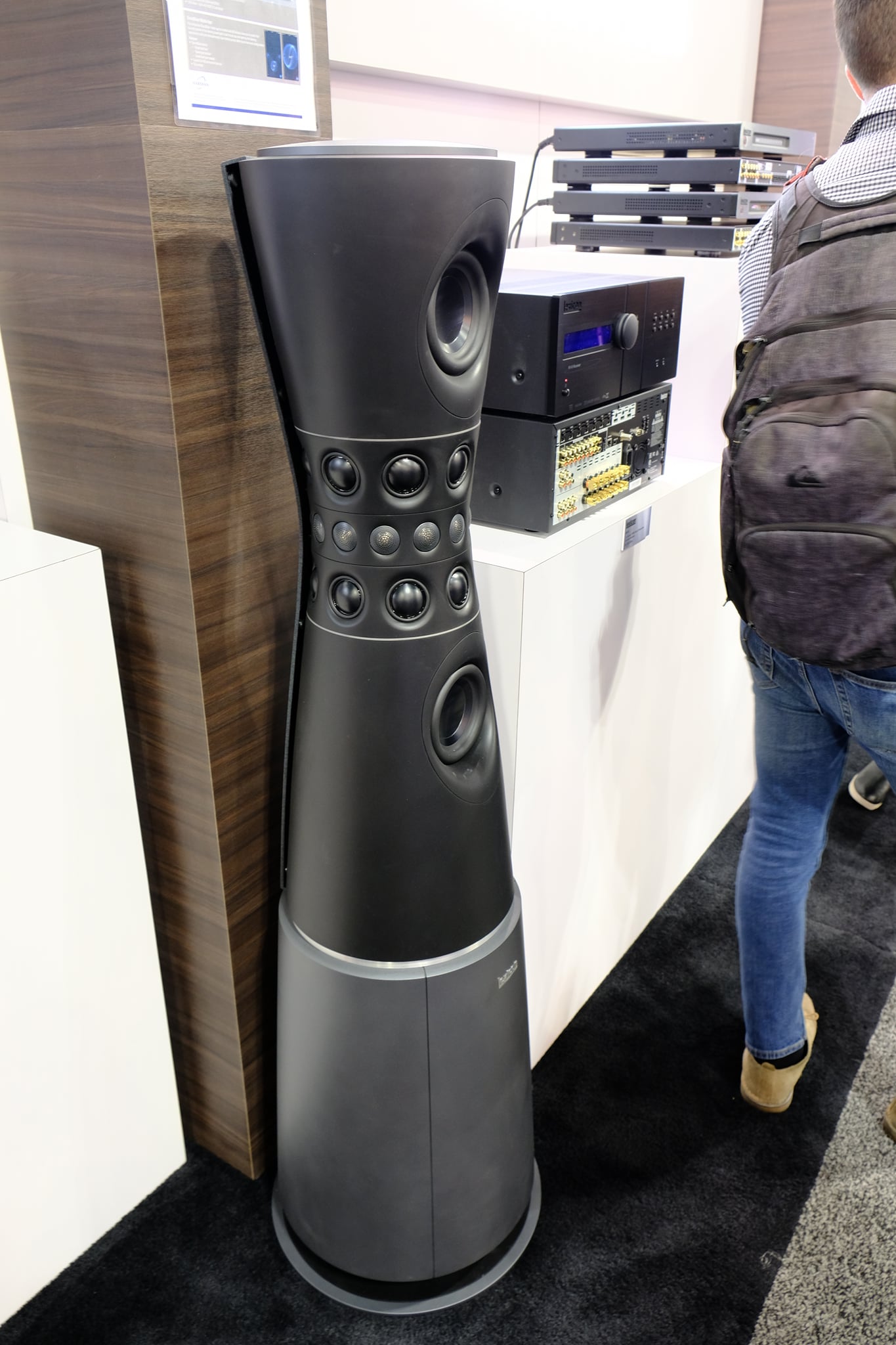

The Lexicon SL-1 (pictured in my attachment) takes these ideas a step further, and allows the beam to be widened, narrowed, or steered. It does this by manipulating the arrival time and intensity of the array of drivers. The SL-1 was designed by Horbach and is an evolution of the ideas from the Horbach Keele loudspeaker.
The only obvious reason that I could see using a D'Appolito array instead of the DNA array is if you WANT an asymmetrical beamwidth. Which a lot of people do.

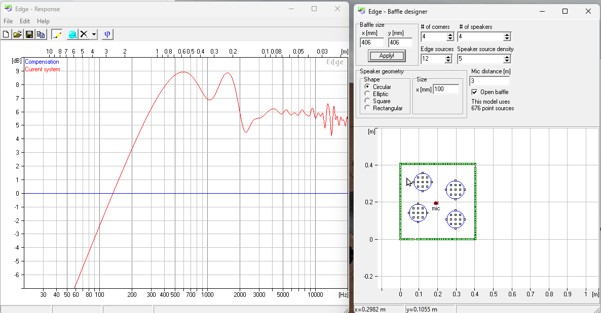

I was looking at my own "Nexus" project, and it looked like the first version, which was very rough, had a lot of promise.
Basically, I don't normally make dipoles, and when I made the first measurement it was mostly because I was in a rush to see how it would perform. IIRC, I never intended to make it a dipole. The plan was to port it. It's been a few years, but that's how I recall it began.
Based on that, I thought I'd evaluate if the dipole performance can be improved. The attached pic simulates the performance of "Nexus One" from the first page of this thread.
As you can see from the sim, the dipole radiation gives a fairly large amount of low frequency gain.

I did some messing around with dipole midrange arrangements in "The Edge" and basically came to the conclusion that:
1) There's a law of diminishing returns with baffle size. Basically I'd like to see the midbasses play down another octave, from the 200Hz that they were doing on a 40cm x 40cm baffle, to about 100Hz. But the baffle gets huge in a hurry.
2) It's tempting to go out and get an infinite baffle woofer, like the one that Scott Hinson used here: https://www.madisoundspeakerstore.com/pdf/SB Audience OB3 Open Baffle Kit.pdf But the challenge when you go that route, is now you can't get that Unity Point Source Magic.
Right now, what I'm leaning towards, is recreating that "Nexus One" speaker, but messing with the geometry to see if I can cram two additional midranges on the baffle. If I make it a bit pyramid shaped, I think it might be do-able. It wouldn't have the narrow angles of a typical unity horn; instead of 60x60 or 50x50, it would be more like 135x135. But I think that doing that might provide enough space to squeeze two more mids on the baffle.
On second thought, that's probably not going to work. If you look at the dipole's output at 100Hz, it's down about 17dB. (in the measurement, it's down 12dB from 200hz to 100Hz, but there's another 5dB of boost in the EQ settings.
