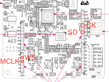

Last post for tonight. These are the pins for the I2S1 configuration I'll be using as a first attempt:
The MCLK shouldn't be needed as the i2s is running slave and the master clock is external. The clocking should should then synchronise via the bit clock input (CK), the frame clock input is WS and the SD is the data pin input.

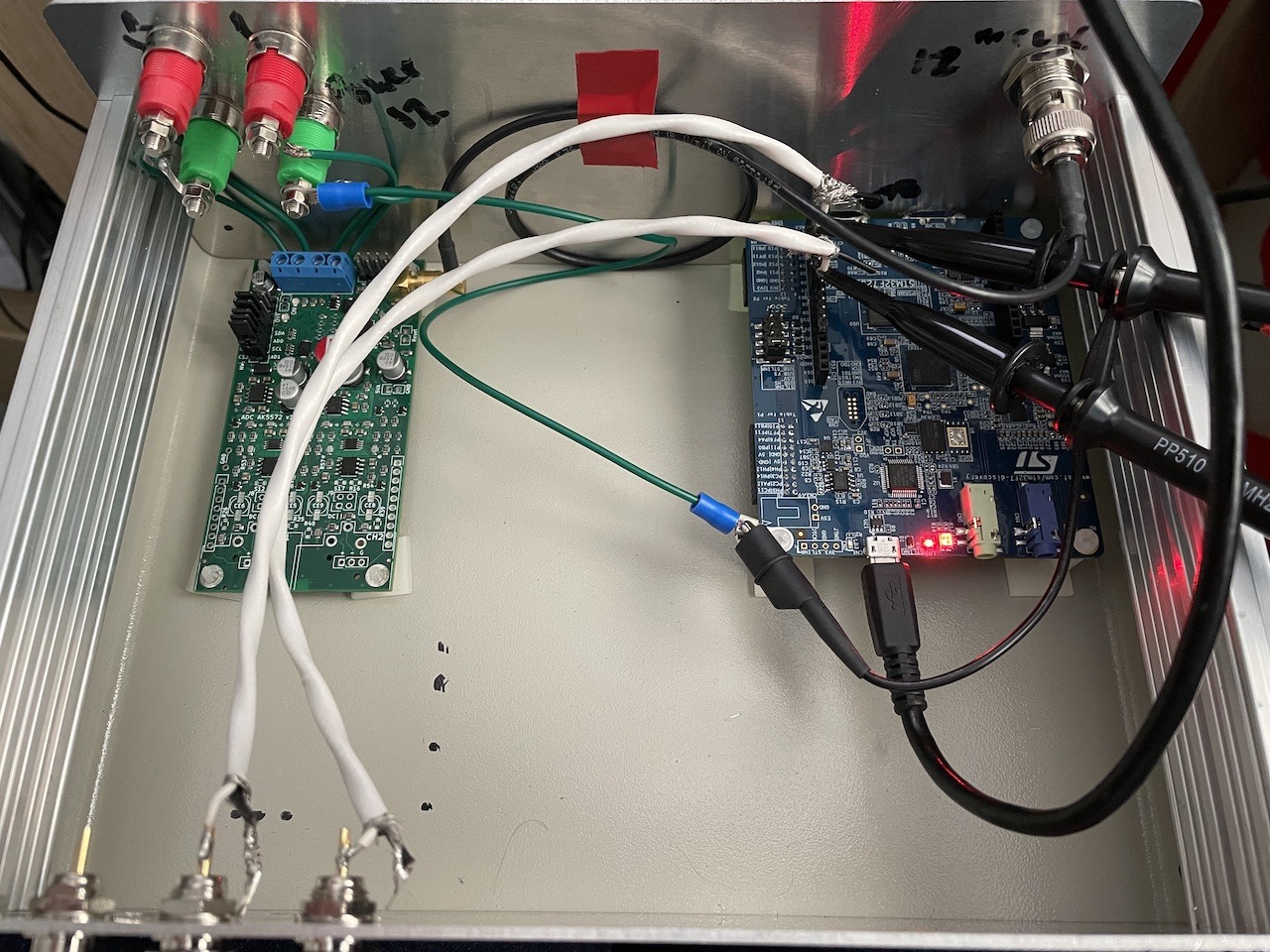

Ok. Removing everything and starting at the beginning. If I apply signal generator generated 24.576MHz SCK and a 12.288MHz FS, does to the SAI - It works. So the STM does work with the DMA and interrupt.
So one option for now is to use BNC connections, not for the HV (connectors take 500Vpp) but instead use those connections for the test clocking for the DMA STM development. That will get me moving.

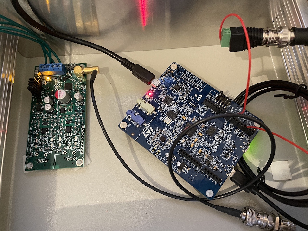

The test setup is a little neater now:
Currently I have the BNC's connected to the signal pins, that way I can clock the SAI interface from the signal generator, leaving the SD to be random.

So I'm getting the drivers say they're ready - both SAI and DMA, but the system isn't getting an interrupt. I've checked the PCM clocking from the ADC - that seems good (~3.3V).
The ADC is running MCLK of 24.576Mhz (this into the ADC), running PCM output 192K 32 bit,
SCK: 12.288MHz
FS: 192.000KHz
SD: ~ 1MHz (although that's obviously depending on the bit pattern of the digitised signal)
Those are at the ARD pins of the DISCO. So the ADC seems to be 24.576M / 128fs = 192KHz so that seems right with the config I have the ADC hard wired with jumpers as. However that doesn't match the 13bit long PCM signal.. so I'm a little confused..
So either something not configured right or I've managed to bust the ARD pins (although I doubt it).
