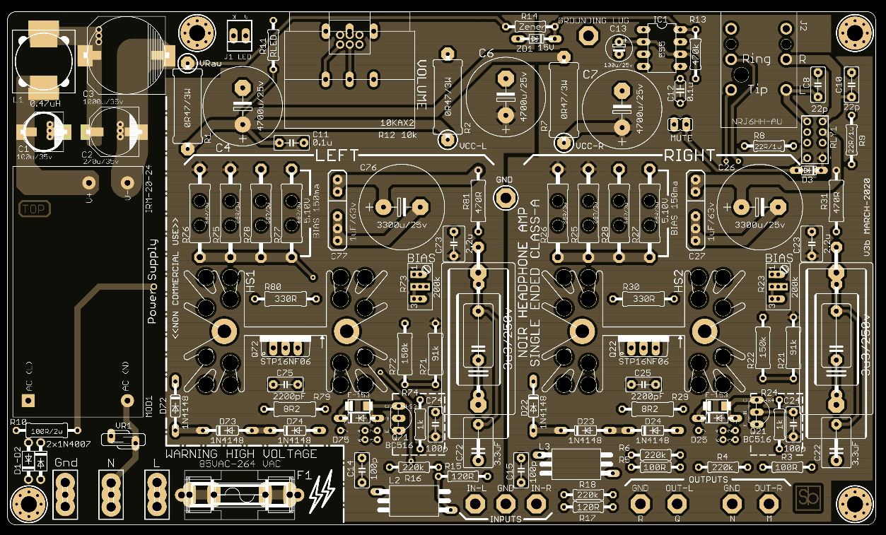

Have you got it going?
I'm curious about the on board switcher, my attempts so far have not worked too well.
Always ending up having to put physical distance between. I attempted Cu shield cage, etc.
The layout is nicely done.
Not yet, still need to order the pcb, probably not before a few weeks.
The on board switcher is the same I used with the B1 Korg and there is no noise a t all. It is also the same used into the Neurochrome HP-1. But depending on the circuit CMRR that may be an issue here, I'll see...

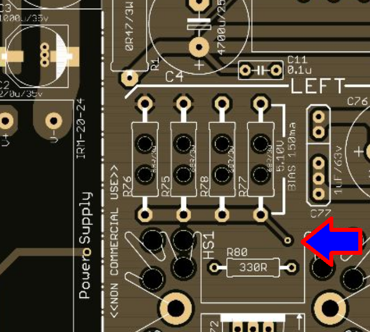

Eagle PCB. Corrected the via, It was not neded, probably a left over from previous iterations, thanks for the tips!

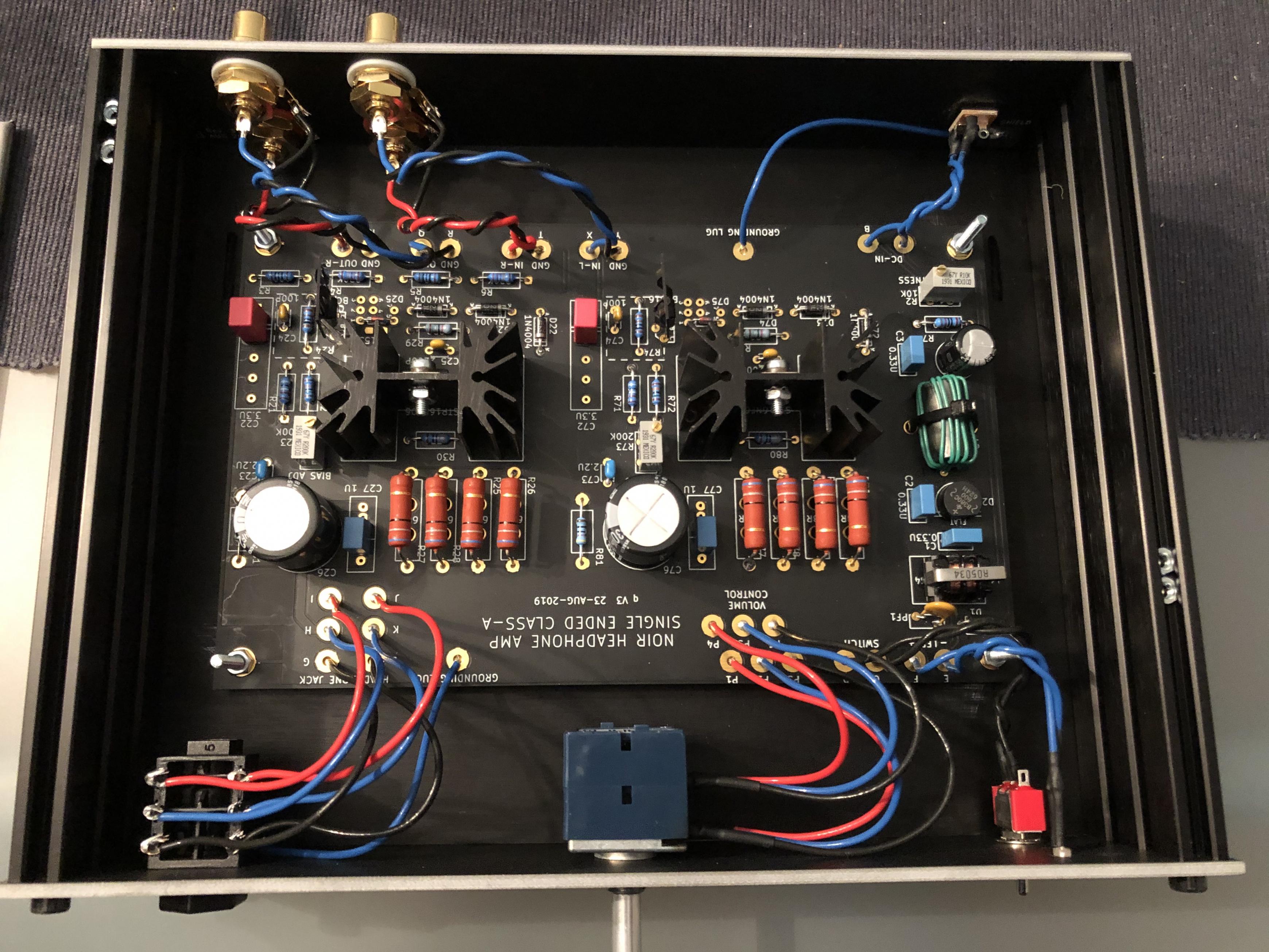

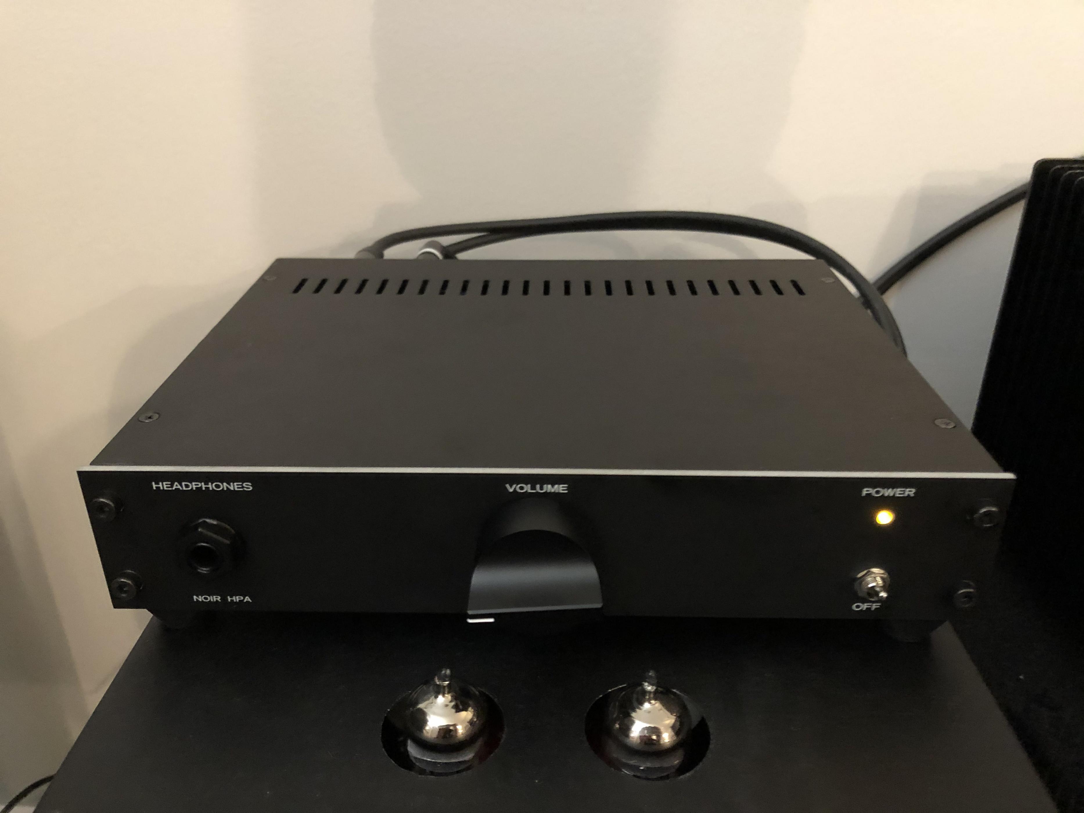

Finished!
Here my finished Noir. Biased without any issues.
Sounds fantastic both with my HD600s and F5 as preamp on initial listening! Gain is too high to be really usable in my main system though, where I usually use my ACF 12VAC buffer as line stage. So I'll probably keep it as a HPA. Might be time for a B1 build at some point......
I ended up using a wire from a never-used Ethernet cable and it fittet through the core pretty much exactly 11 times. The rest of the wiring is 16AWG PTFE that I had left over from my F5 build. Overkill? Probably 😀

Wonderful! Looks great, well done!!

Last year when I built my WHAMMY I used a red case with red Riverstone knobs I bought on Amazon at $10 for a pair. I used the other one on the NOIR. I think the red knob on black case looks terrific.
How would you compare the NOIR to the WHAMMY?
Just built up one of these yesterday since I’m now stuck inside and getting seriously bored. It’s been in continuous operation for around half a day, but I can tell it shows serious promise. Already it sounds much better than both Whammy and my build of the F5 HA.
It’s open and airy with a very mid-forward presentation that mates better with the TR-X00 than the HD-650s. It’s also bringing up serious flaws with my source so I guess a new DAC is now in order. Overall I’m very impressed with the kit. Anyone here get around to trying any upgrades with it?
