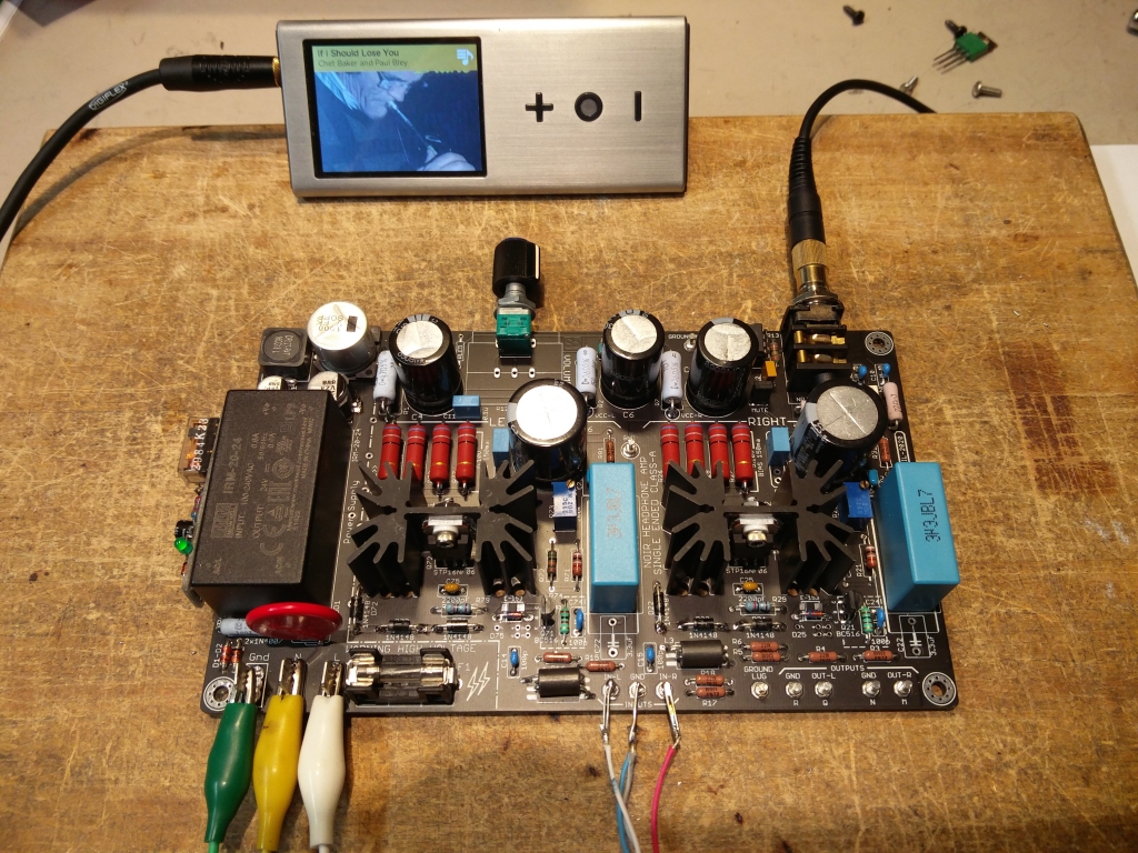

My own Noir with integrated Power Supply
Completed my own Noir version, and it is excellent, very great sounding, fast, immediate, sweet, perfectly silent, a great HP amp!
So here is what I did to the original design:
-Did my own pcb based of picture of the original. Re-route some traces and insured that ground traces separate each channel traces, to try to improve the channel insulation.
-+24V power supply top pcb layers are separated by channel, with a separate last RC supply filter to try to improve the channel separation.
-Added a startup mute timer and mute relay. At startup now the maximum is 8mv at the output. Same thing as shut down, so no more voltage swing.
-Added CRC multi stage filtering, the last stage one per channel to try to eliminate any power supply noise, and try to improve on the channel separation by isolating somewhat each channel supply. My supply ahs a vanishing level of noise. and can't hear a thing at maximum volume, and input shorted.
-Added pcb ventilation holes under the mosfet heatsinks.
-Added an integrated SMPS 24V power supply module with CLC noise filtering, works great, but read on 😉
-Added input bandwith limiting RC filtering and noise choke to reduce input source noise.
-Matched both Mosfet and got perfect gain matching between channel. I had to ordered about 10 MOSFET to get two matched sets.
Thanks for sharing this great design!
Check the picture, playing Chet Baker 'Diane' on my Pono

Did also some measurements, this amp perform really, very low THD at reasonable listenign level. Here my preliminary results, with a test lab power supply, All measurements done into a 32R test load, otherwise noted
Vout at Vin 1V, 1kHz: 1.95V, Gain 5.8dB (Don't forget I have an input 100R/220R, 100Pf input filter...)
Max Vin: 3.12V (Vout 6.2V)
THD (1V out, 1Khz): 0.05% into 32 ohms (0.005% open load)
BW (Ref 1Vout, 1Khz): 167Khz
Output square wave is almost perfect (I have an added 22pF at the output...)
Max Vout at startup: 8mv

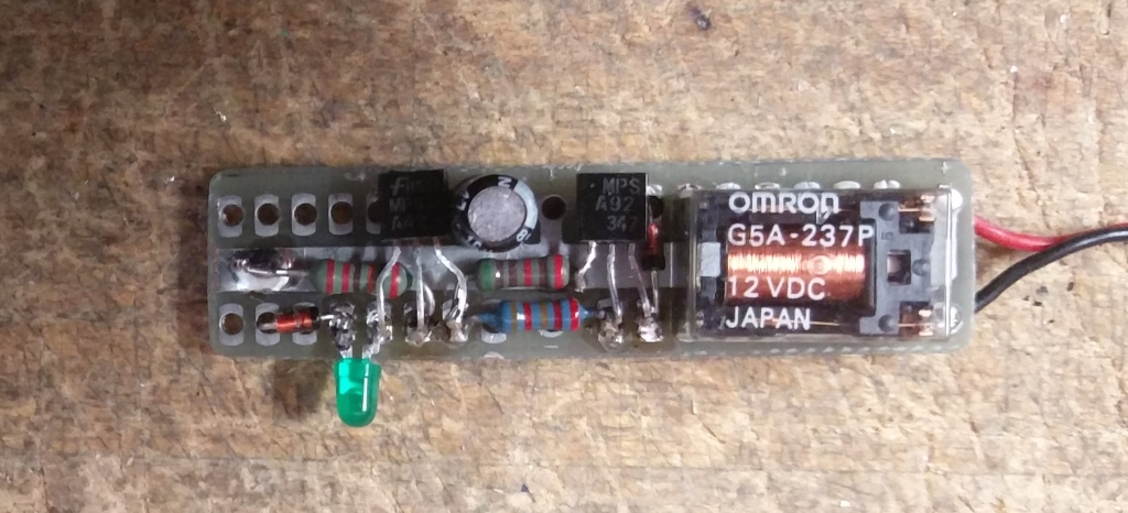

Back on the drawing board. The real solution was to add a 10R resistor at the SMPS output, and once the amp was stabilize (a fraction of second), to short the resistor out for the full 24V supply, and I had to do that within the Mute timer delay (no problem about 45sec mute delay). A softstart circuit 😉

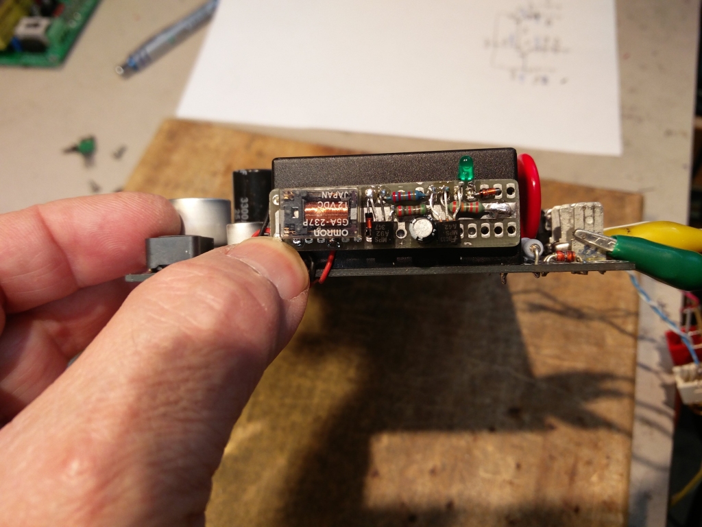

Using parts I had in stock made small point to point softstart timer and bypass relay. It clicks after about 1sec, and work like a charm... I glued it on the side of the SMPS with silicone. This circuit could be implemented in smd part, under the SMPS without problem...

The mute is the following, Relay CT pins connected to the amp circuit output, NC is a 22R/2W resistor to ground, the NO is the output, with a 22p to gnd.
The 22R resistor is there at the output during the mute, already presenting a load similar to the headphone, then when unmuting, the output switches the headphone, and there is almost no difference for the output coupling cap, hence no voltage swing. At least that's the idea...
No radiation noise and/or supply noise at all... Just this start problem that I had to solve...

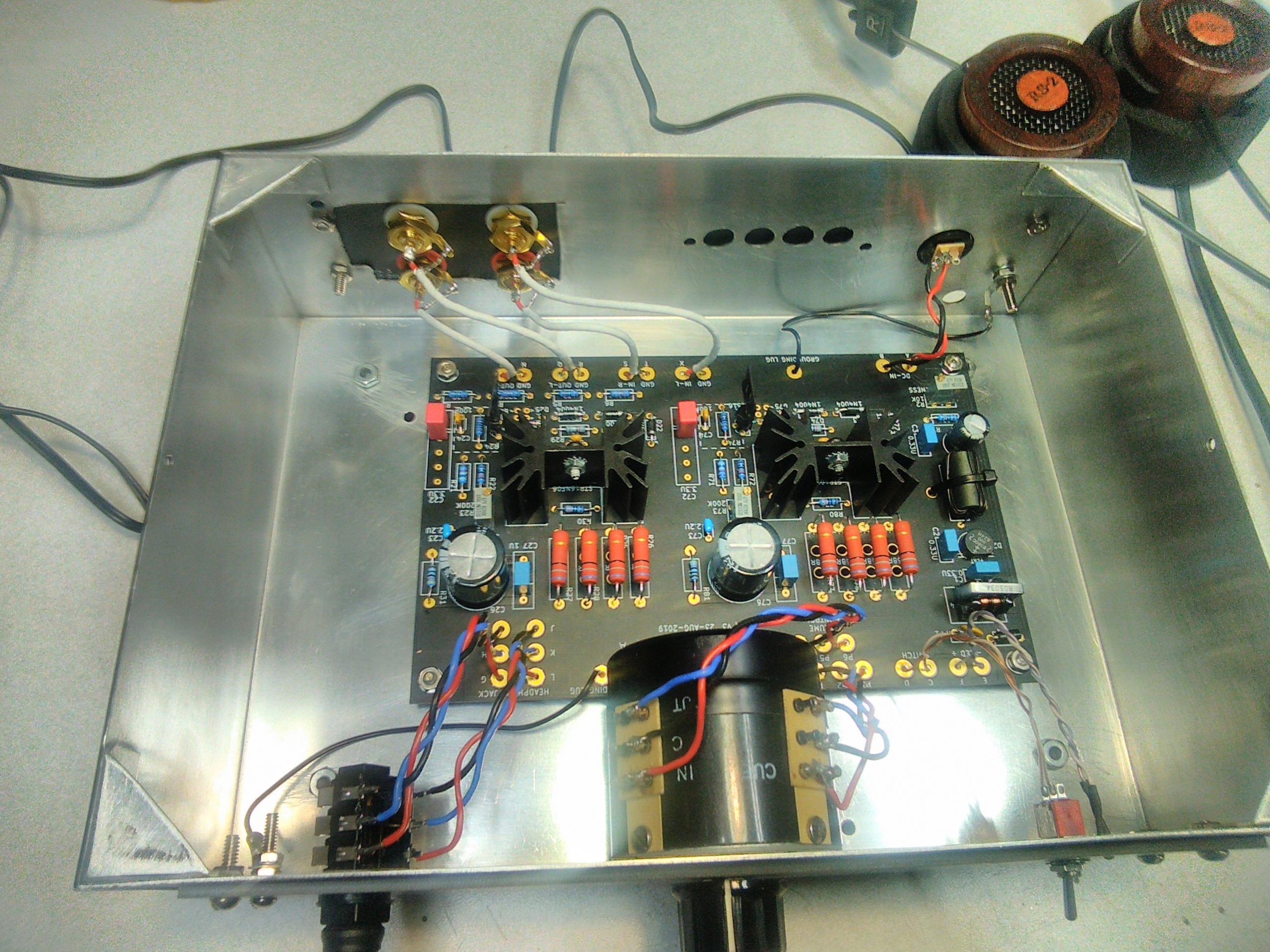

Congratulations on your success! With all of your modifications, not to mention your own PCB layout, it was an ambitions project. Glad to hear you are delighted with the results.
When it's all buttoned up & installed in a final chassis, please post some photos. I'm sure members would like to see how you arranged the front panel, the rear panel with RCAs or XLRs, the AC mains inlet, and so forth.

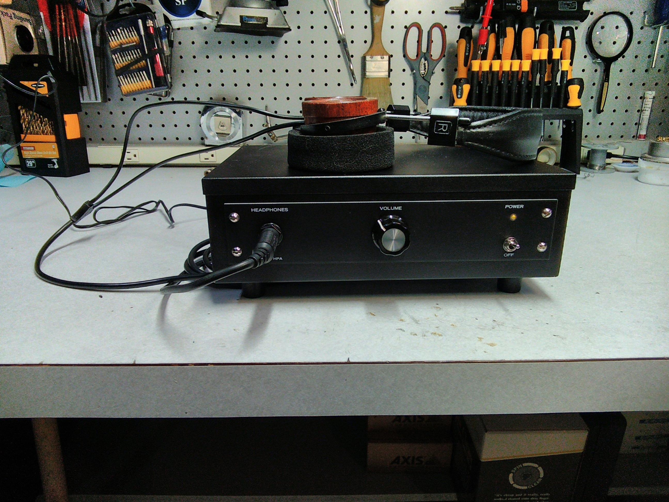

Very well done.
Will be rather straight forward using an Hifi2000 enclosure, and with my 2 little rounds ventilation window on top. This amp is cooking!

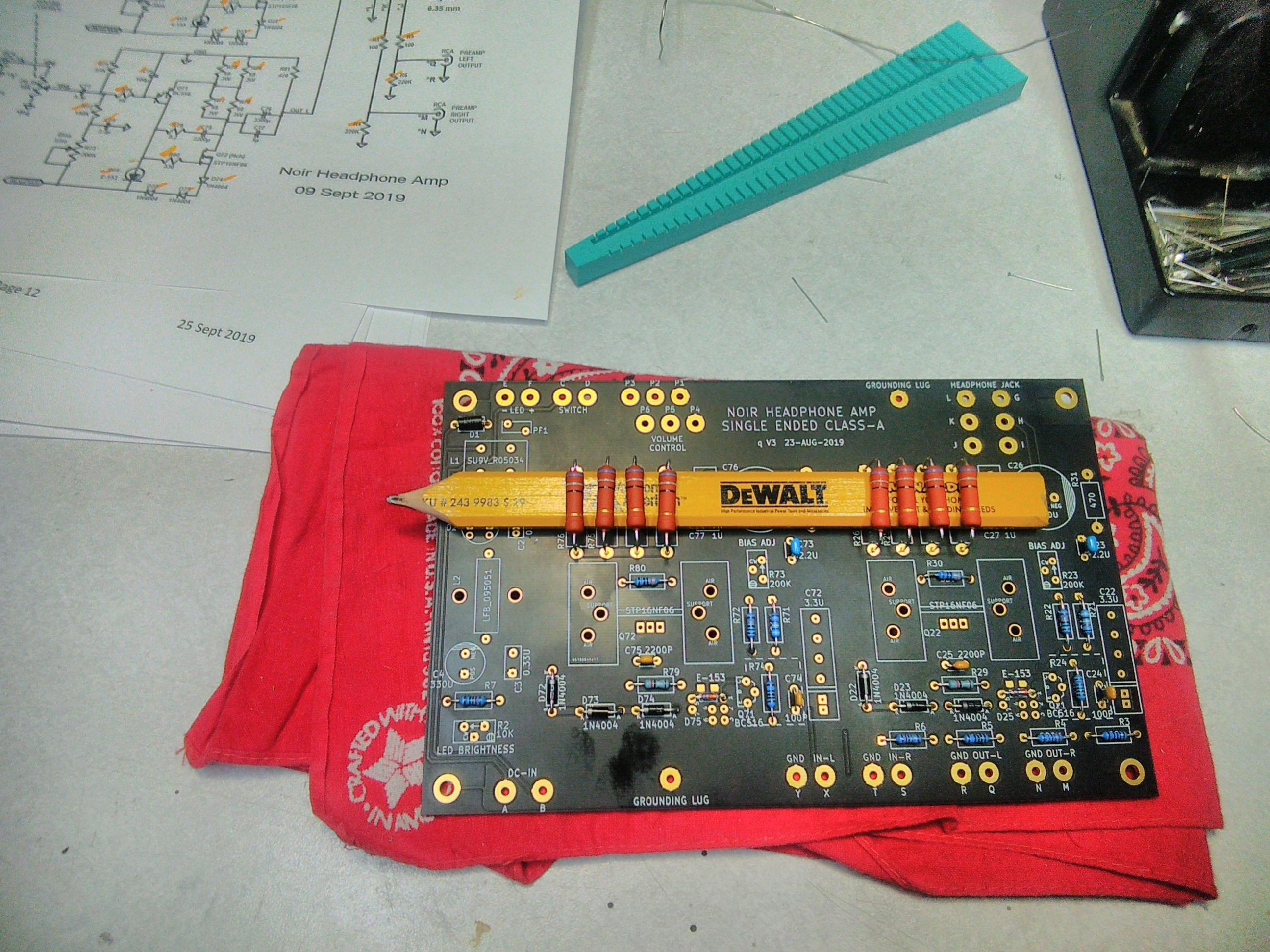

I finished my Noir a few months ago and finally getting around to getting some pics off my tablet. It was a fun little project. I tried to use mostly parts laying around the shop. Hence the retro look. This is the third or fourth project for the case. So the Noir front and rear panels were great for covering all the old holes. The volume pot is an old Shallco 10K pot rescued from an old audio board.
I found that a carpenters pencil worked well for mounting the large resistors.
Thanks Mark for this little gem.🙂
Mike2 - lovely build! Whatever you did to clean the PCB of topside flux, worked extremely well. And of course the carpenter's pencil was pure genius! Glad you're pleased with the sound of your Noir.
