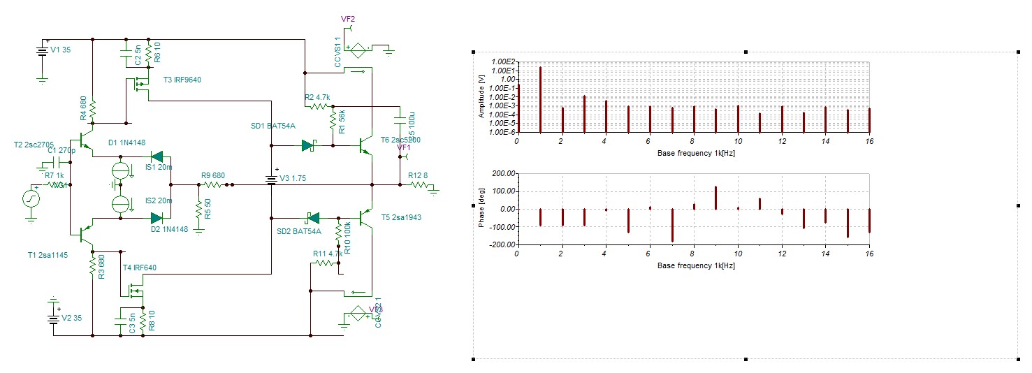

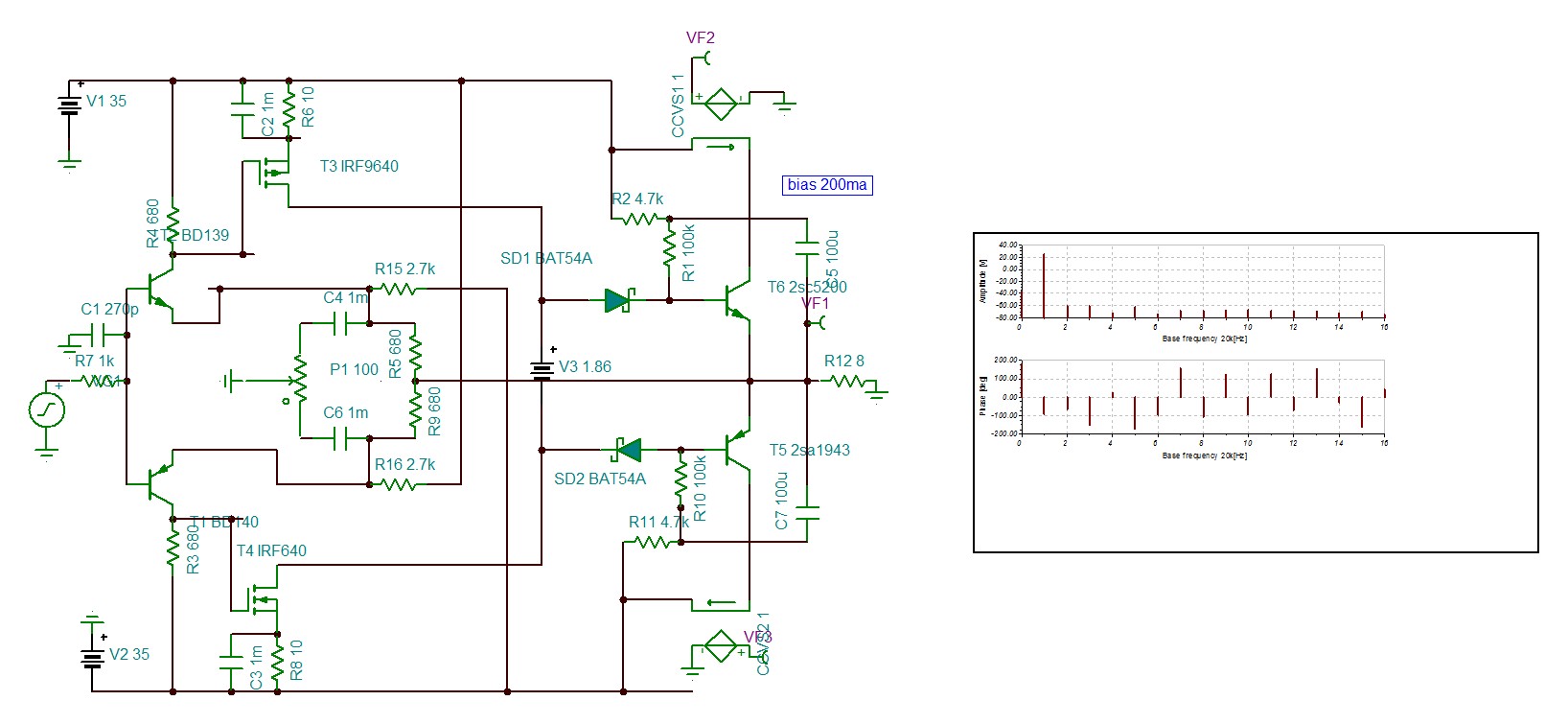

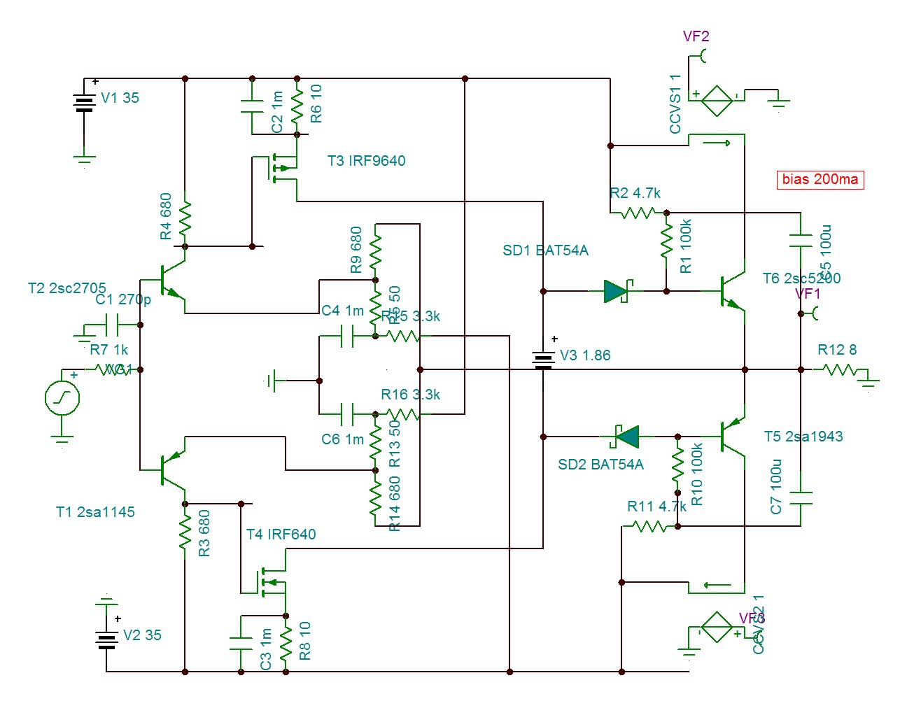

I have converted to a follower with bootstrapped V supplies. Driver/VAS is 30mA. Files attached.Goodmorning Ian. Your driver has a load of 800 ohms. To fix the dominant pole at 20khz , you must ground the collectors with 10nf. The maximum slew rate is Imax/10nf. You will need 2× 0.3ma to get 60V/us. This Why the drivers should be mid power transistors of min 40w to dissipate a continues 10w. I suggest you IRF640/IRFP640. At 300ma biased , it gives 93db*+6db VAS gain with Dtot of 0.0077% (mostly to be subtracted by the other pole ) at 20khz 18v p. ...

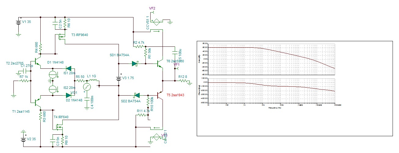

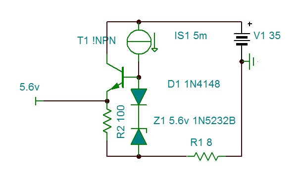

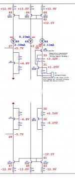

Basically yes, but a little bit more needed to apply in your (or any) circuit....Do you mean this way...

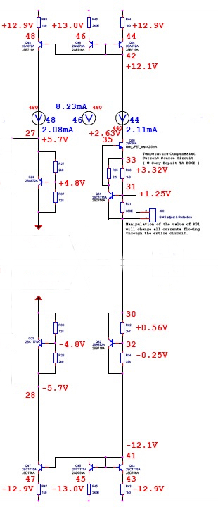

The jfet-bjt configuration is the Sony curent source, used in the Esprit series. It is temperature stable because the jfet and the bjt converge to a thermal equilibrium. An extra voltage source is in line to protect this circuit for to high rail voltages (but in this example only +/-15Vdc). The mirrors on these rails provide currents for the input differentials and, of use in your circuit, two symmetrical currents into two (as they are also called 'rubber') zeners. Instead of connecting them to powerzero, connect them to the output of the amplifier. An advantage is the very nice startup and shutdown sequence (no inbalances). Also, by manipulating the resistor connected to the b and e of the current source bjt, there is full control of the amount of current from this source, and can be used for protecting and/or those startup/shutdown sequences of the amplifier. The larger the resistorvalue, the less current results; maximum current depends on the jfet however, so limited and no runoff anyhow.
I made a quick trial for you. in sports version, I applied about 40db NFB but the distortion 20k 19v got just a single zero to be 0.09%. The culprit must be my error amp "a la Kokoriantz" which has a distortion of only 0.15% but as it is the corrector , it is correcting wrong . Some more adjustments necessary for the bias.

I have forgotten bootstrap on the negative. Once rearranged , Now I have 0.015% always 20khz 20Vp. I think I will stop here with this amplifier. I see there are a great number of followers this thread , by owing respect , I will resume back to original theme . I think Ian ,you should now start I new thread for your amp , where besides me ,others can also help you.

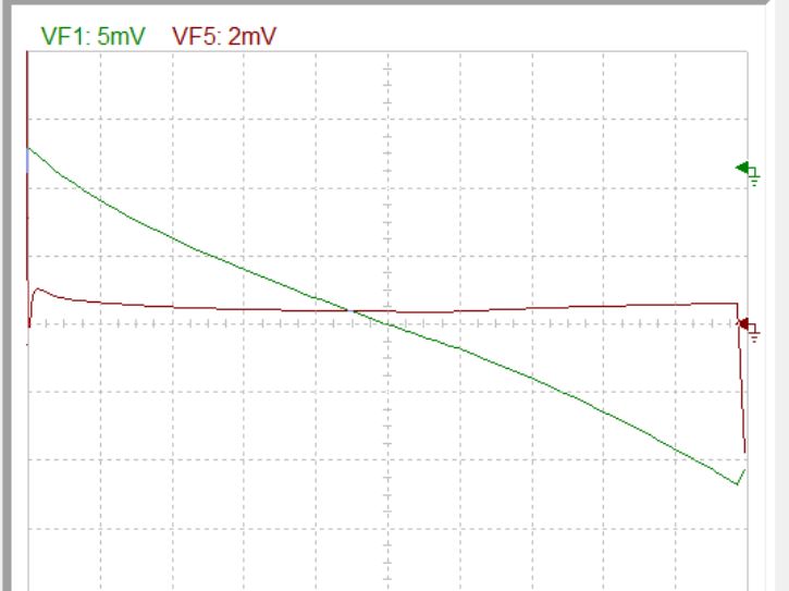

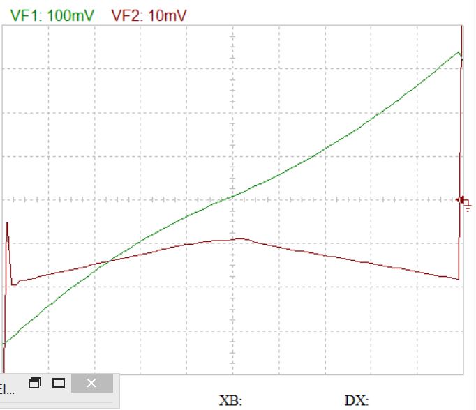

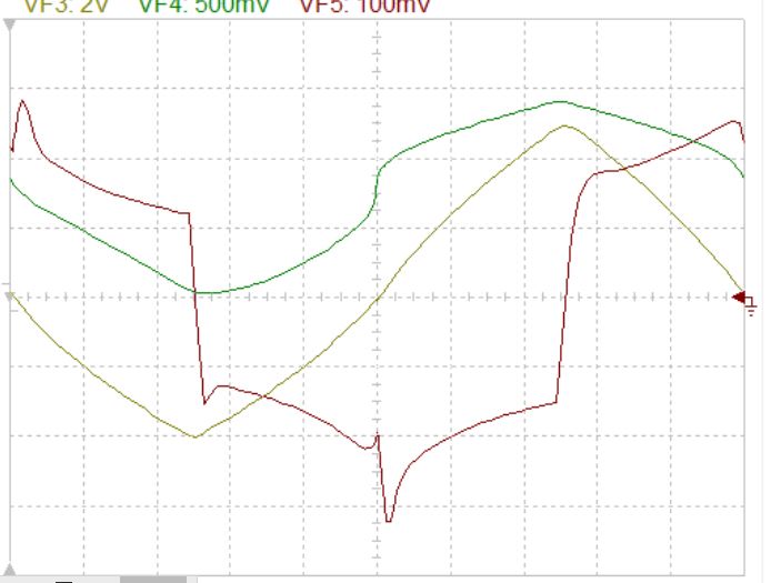

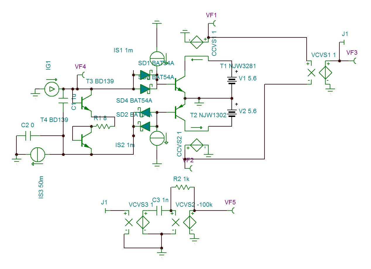

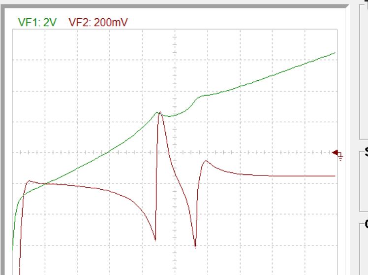

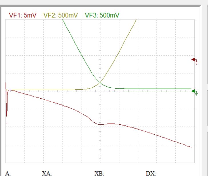

Good morning Ian. I have bad news for you. I measured the linearity of the output conductance for your non-switching technique , great disappointment .
I even didn't need to scope with the derivative function. See it yourself .
These are with Japanese, below are with NJW s.
I feel truly sorry.
Hayk
I feel truly sorry.
Hayk

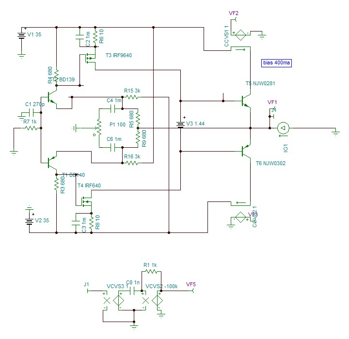

Why it doesn't work? The principle of your circuit is the high impedance current source, will over come the impedance variations of the base circuit. But, it doesn't ,because the current source by the driver collectors are limited in frequency due to dominant pole. So the switching of the fast Schottky diodes become slow. By this as the bad mouths were accusing to have switching diodes instead of transistors, got reason. I tried in most ideal condition with infinite slew rate source , even so, as you see on graph bellow it is not fast enough.
The optimal biased 3EF (2-3 pairs of njw0281g/njw0302g, 40-50V psu) is better and simpler than this non-switching OPS.

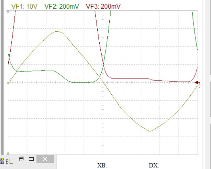

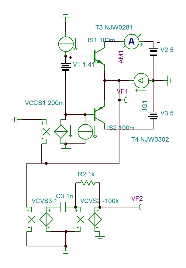

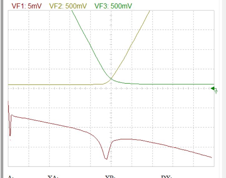

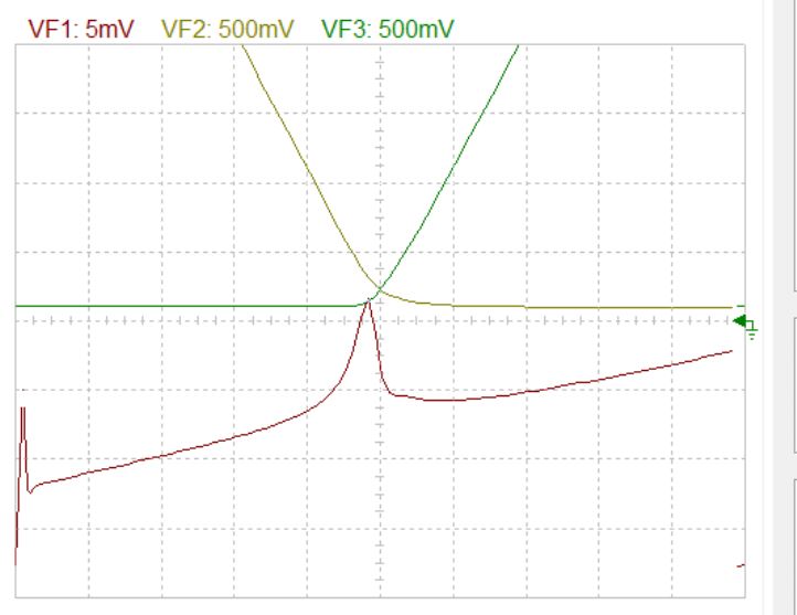

I made a test bench to test the output conductance of power transistors . Within this week, If anyone want me test his/her BJT/MOSFET, just post me the spice models or where I can download , and I'll test it for you at your desired rails/bias, with 5Ap triangular 10khz. Here is the NJW0281/302 biased 150ma +/-5v.
These transistors have clean crossover region but the transfer function is square root . The bias is about 150ma.

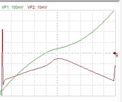

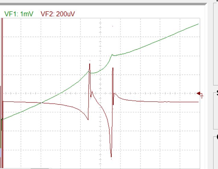

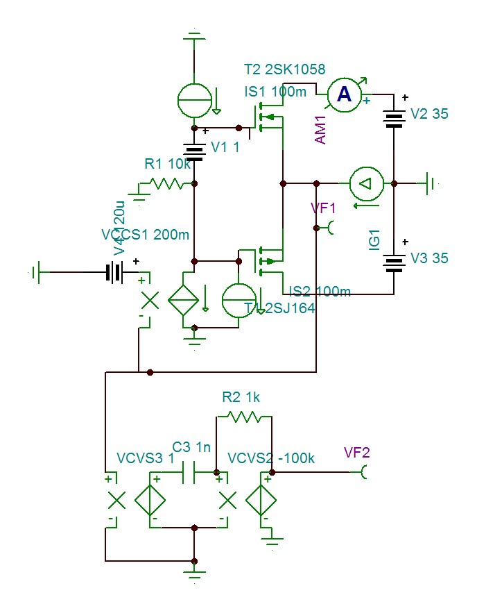

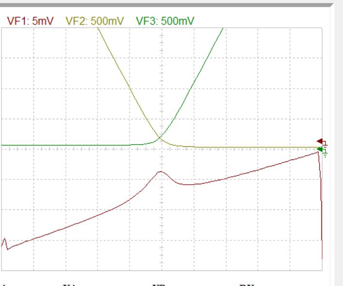

K1058/j164
This is the K1058/j164 conductance biased 177ma. Remark , besides cross over that it is linear .
in open loop
in open loop

I measured this configuration:
* 3EF open loop
* PSU +-50V
* predriver KSC3503,KSA1381, 1 pair
* driver 2SC4793,2SA1837, 1 pair
* output NJW0281G,NJW0302G, 3 pairs (rated power 200W/4R)

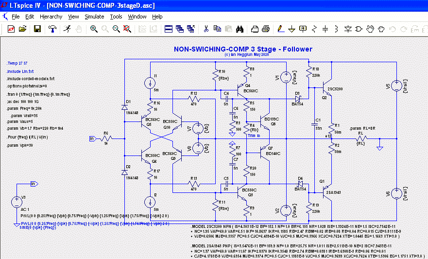

OK, back to the original theme. I assume you mean the circuit of post 1.
I have another variation of the original circuit. Would you like it posted here?
Cheers
- Non-switching complimentary output stage
