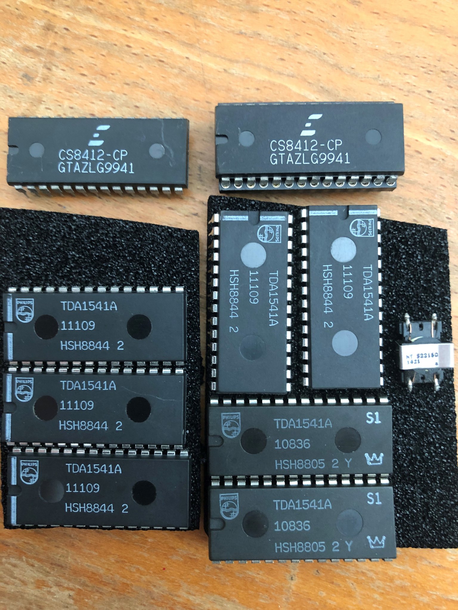

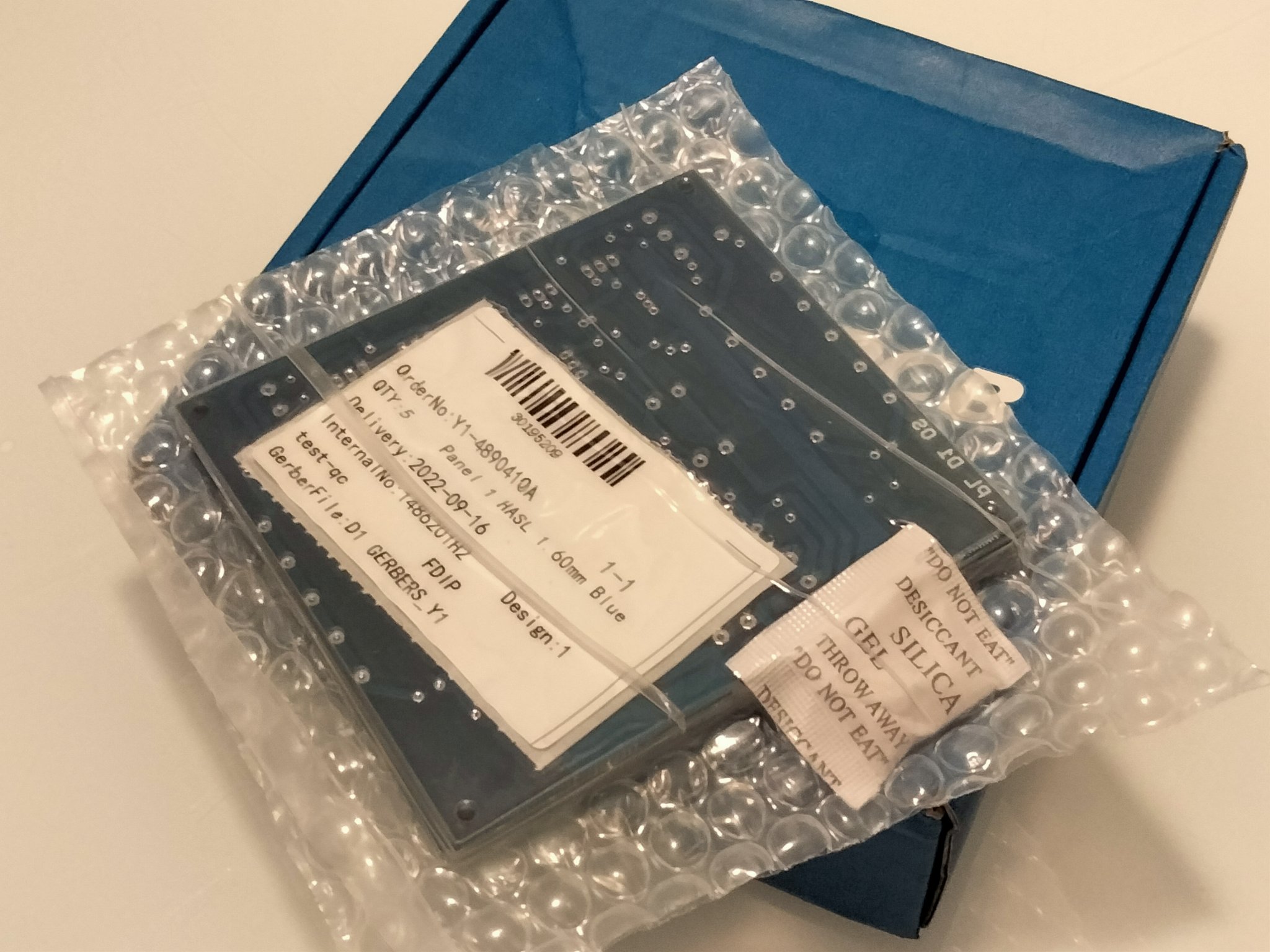

Unfortunately he is now sold out and won't be ordering more. However, I just ordered 11 from Rochester Electronics (same distributor that Paddy used). I paid about $25 each and will sell them for the same $25 plus actual shipping. Also I have ordered Miro's PCB using his gerbers. I will have a couple extra if anyone wants a set. Drop me a PM if interested.Paddy Garcia offers them for sale in the swap meet. That’s where I purchased mine.

- NOS TDA1541 + D1 I/V & output stage
