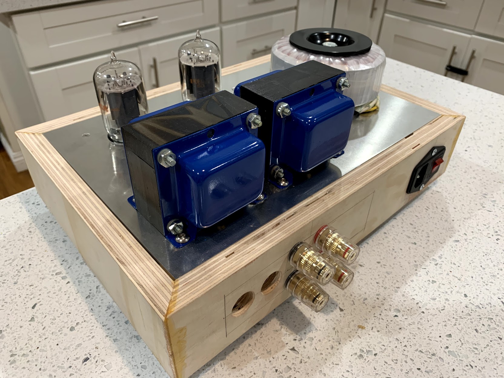

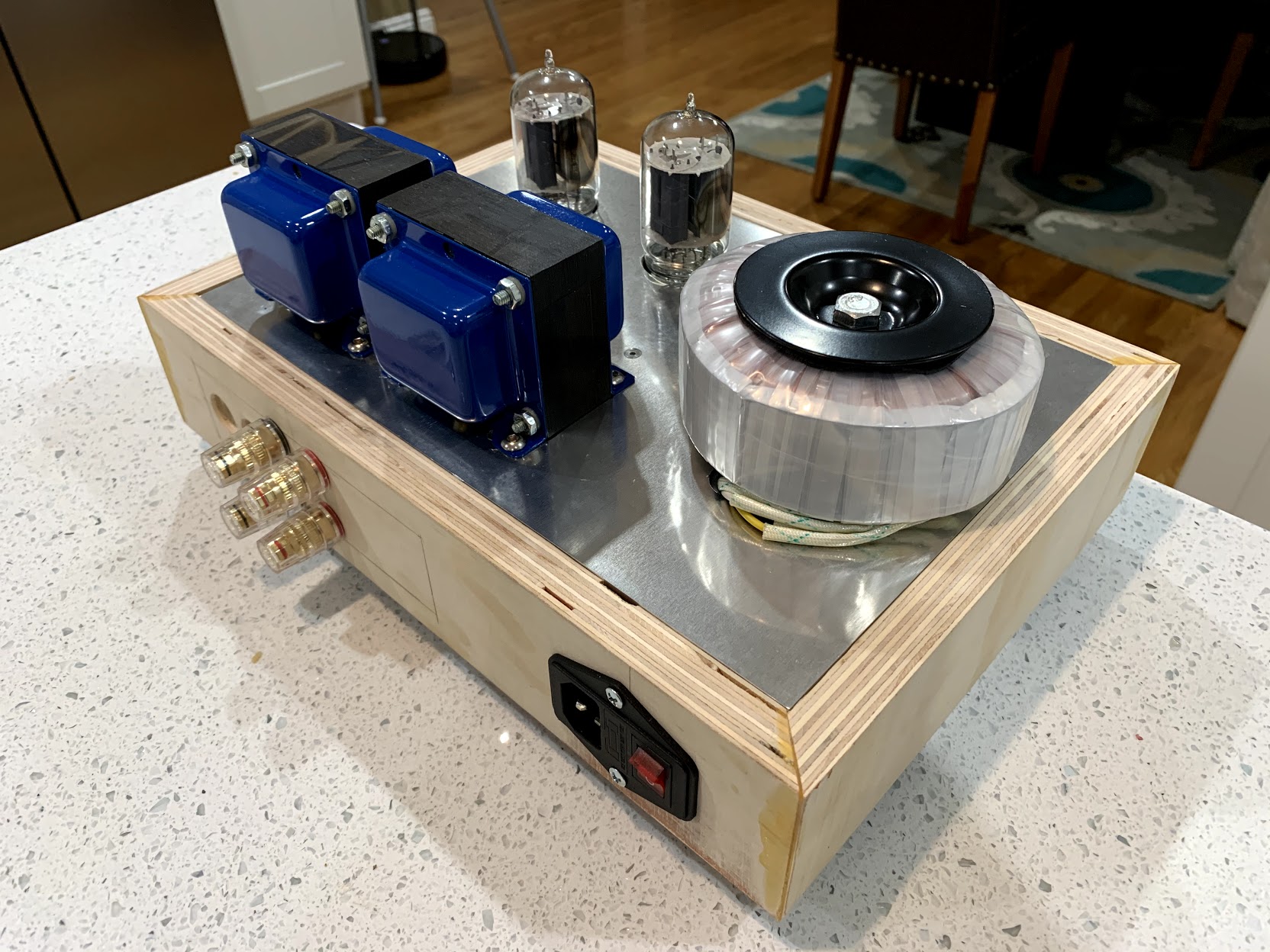

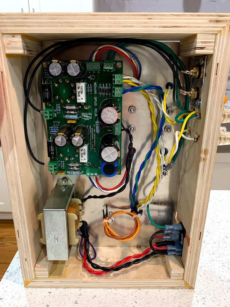

The Novar Spud might be retired but its not dead. All this extra time I've had at home lately has given me a chance to finally complete old projects that were put on the back burner. Decided to finish up the Novar Spud I bought years ago. Used some scrap plywood for the skirt and a piece of 1/8" aluminum for the top.
Setup with 6LR8's in triode mode with GXSE15-5K output trannys. So far I've used it with some Okapi's with Mark Audio 7MS drivers and it sounds fantastic.
