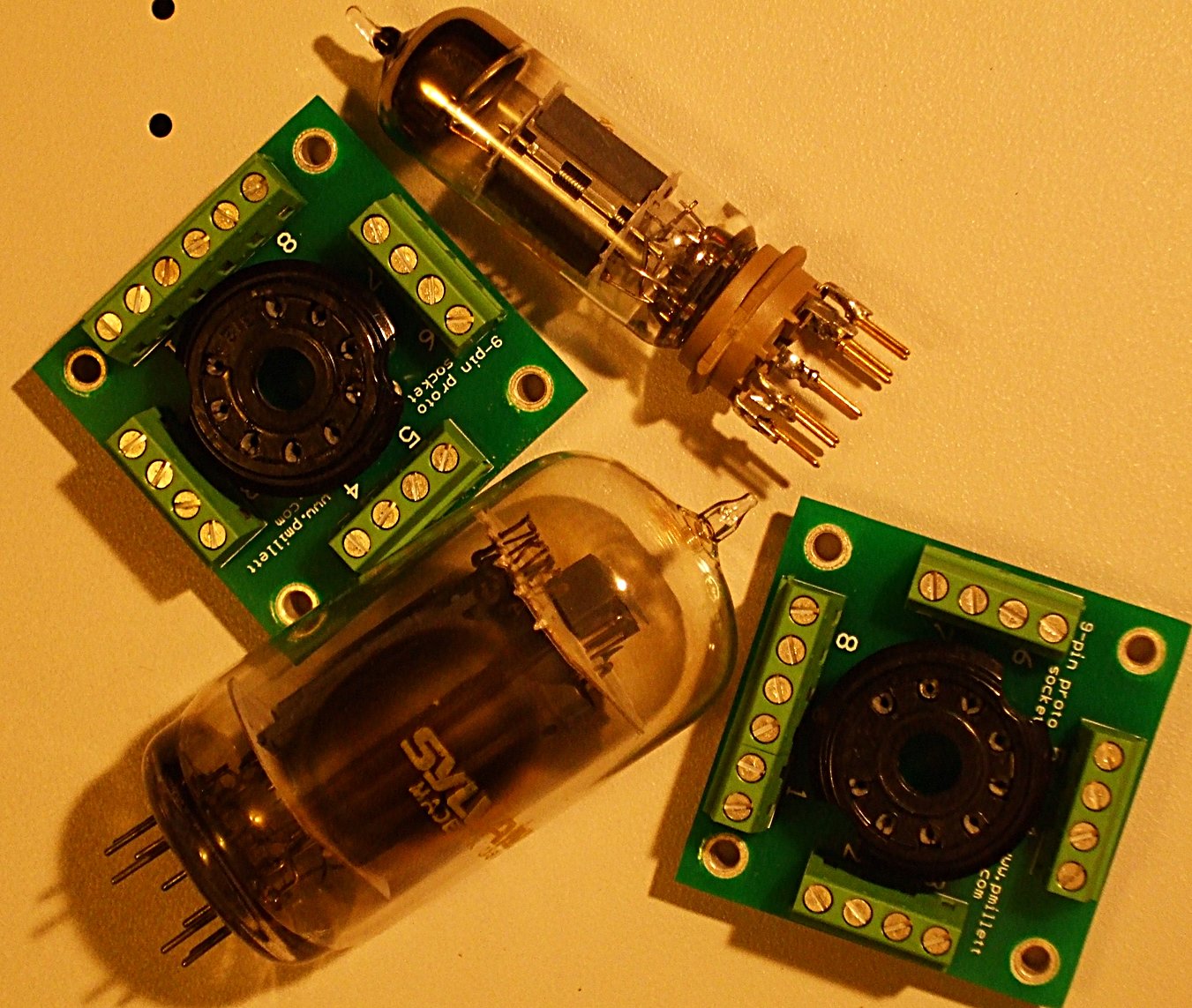

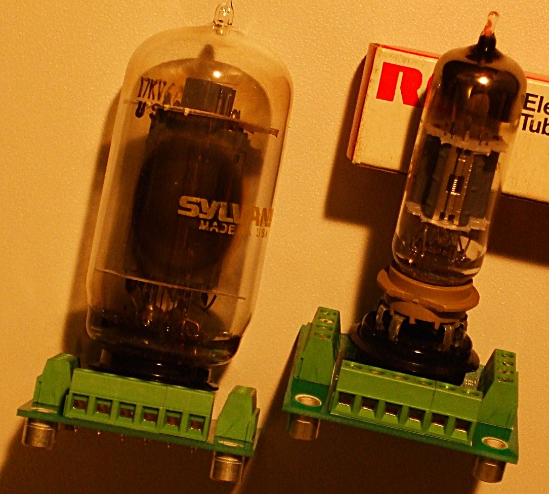

Here is another little trick.
I put Novar pc mount sockets on Pete Millett's 9 pin Noval prototyping boards. Then I made the Noval sockets it came with (specify un-attached) into an adapter using 40 mil Keystone 1405- 1/2/3 pins (Mouser has these). Now it works for Noval or Novar, and it provides convenient scope probe clip-on contacts for Noval tubes:
Since Novar fits too, I may make some Novar to Novar socket adapters also using the 40 mil pins (just like the Noval adapter shown), then I'll have convenient scope probe clip-ons for Novar too.

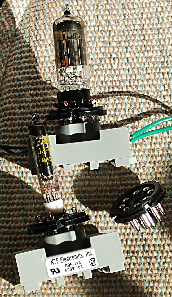

OT: More little tricks
I used Octal Wafer plugs ( Ebay) to make adapters for 7 pin B7G and 8 pin sub-mini tubes. I used a 7 pin PC tube socket, and an old Augat 8 pin Teflon round IC socket for each. The 7 pin PC sockets fit perfectly into the Octal Wafer pins. The Augat IC socket required wire spreaders to fit the Octal Wafer pins. The gray Octal relay sockets make for cheap wired prototyping bases. I also put some looped copper wire scope clip-on contacts around the sockets.
I generally use a piece of scrap PCB with some tube socket mounting holes and turret strips for prototyping. It's not pretty but it does the job until I lay out a PCB.

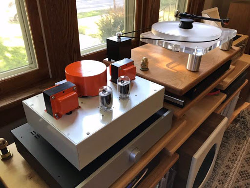

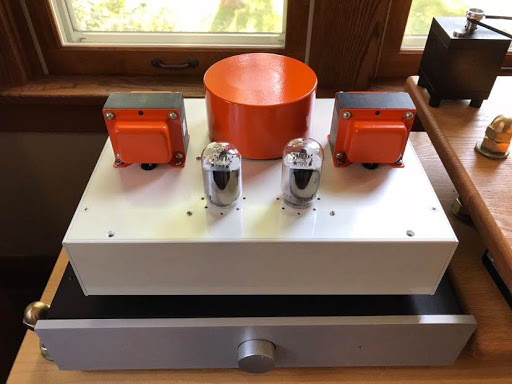

Putting together a tube amplifier for the first time, I couldn't have picked a better one to go with. The documentation was easy to follow. I also got to learn some CAD and had a nice chassis design cut out by the guys at Landfall. Some photos:
Very happy DIYer 🙂
Thanks Tom!
Very happy DIYer 🙂
Thanks Tom!
Nicely done! I like the blue-on-silver look. Thanks for sharing. I'd be interested in your listening impressions as well.

Thanks Tom. As far as listening goes, these run together with a pair of OB Betsy's... I've been playing tunes all day long while I sit in my study, and I am reluctant to move 😀 They are really really sweet!

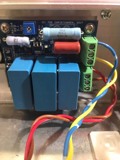

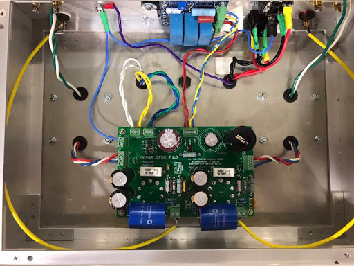

I finally have gotten around to putting my Novar Spud together.
Unfortunately I have a 60hz hum that I can't seem to get rid of. Hum does not change with volume adjustment. Removed inputs and binding posts from chassis with no difference. Tried multiple grounding locations with no change. If I remove source and short inputs there is no hum. Unsure what else to do at this point. 3rd photo of layout is before I finished wiring the outputs, I can upload a current photo when I get home, but the -'s are connected and ground to the pcb as per the schematic.
If the hum goes away when you short the inputs, the hum does not come from the amp.
I suspect you have a ground loop between the source and the amp. You can break that with a line transformer. You can also try a ground lifting circuit. I'm normally not a fan of those, but they can at least help you debug the issue.
If you have a 2-pin IEC cable (i.e. one with the ground missing) or one of the 3-pin to 2-pin adapters (ground cheaters) you can try that first. You can find the adapters at your local hardware store. If this removes the hum, we can work out a more permanent solution.
