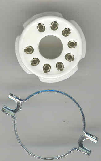

Woops, sockets were ordered from "The Tube Center" (off Ebay), which has the same address as ESRC at 6424 Pinecastle Blvd. Orlando. I assume they are the same.
I think it is some kind of vendor mistake, so I'll call them. The packed invoice has the completely wrong part number on it, SK-9, which is a standard 9 pin noval socket on their site. But what came is a 9 pin Magnoval socket. And what I ordered (off Ebay) said:
"9 Pin Compactron SOCKET
Fits 6JB6, 6JG6, 6JE6, 6KG6, 6KV6, 437A, etc."
To confuse matters, 6JB6, 6JG6, 6JE6 and 6KV6 are Novar. But 6KG6 is Magnoval.
However, the ESRC SK-9C 9 pin Compactron tube socket on their site has a picture with obviously too big of pin holes in it: (1st pic attached) And I don't see any Magnoval socket even listed there. Received socket is 2nd pic. Notice the large socket pin holes. Some Chinese sockets state that they fit both sizes, but these sockets just fall off Novar tubes.
Somewhere, the truth must be out there....

Update:
They are sending out some replacement sockets that are tested to fit the 40 mil pins of Novar tubes. And I'm sending the others back. Pretty sure these are more Chinese ceramic sockets though, look identical.

Keep us updated on what you received. The right photo clearly shows Magnoval. Very same as:
2PCS 9pin B9D MAGNOVAL Ceramic Tube Sockets for EL504 EL509 EL502 Chassis Mount | eBay
I have on hands both like this one and a Compactron, and it seems the opening for the Magnoval's terminal is a bit bigger. The terminals look very alike, the Compactron's ones just seem having smaller opening gap.

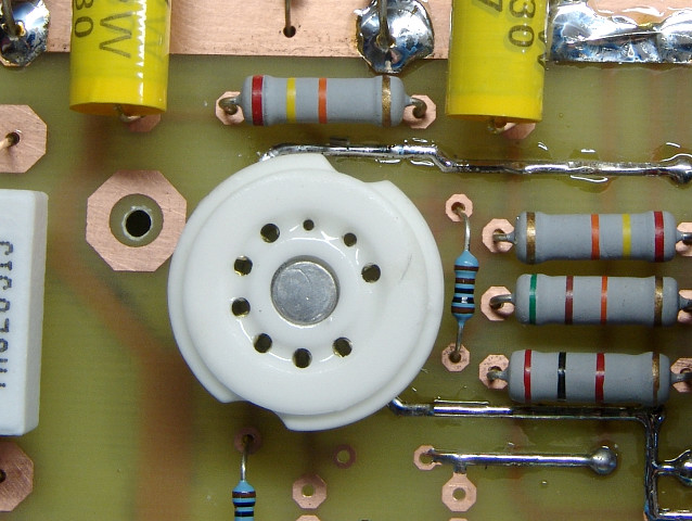

Maybe this one......of course I soldered it into the board before I noticed it, then tried to drill it with a PC board bit in a Dremel, resulting in a bit broken off in the socket.
