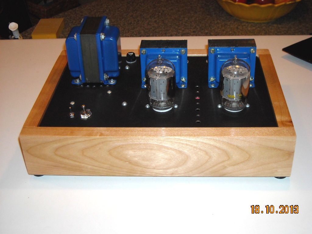

You can't go wrong with Tom's PCBs, the 6LR8 is a great sounding sweep tube.
I built my amp before I was aware of Tom's PCB being available, if I had known I would of bought a set to make my life easier.
I have attached a pic of mine for fun, great sounding amp.

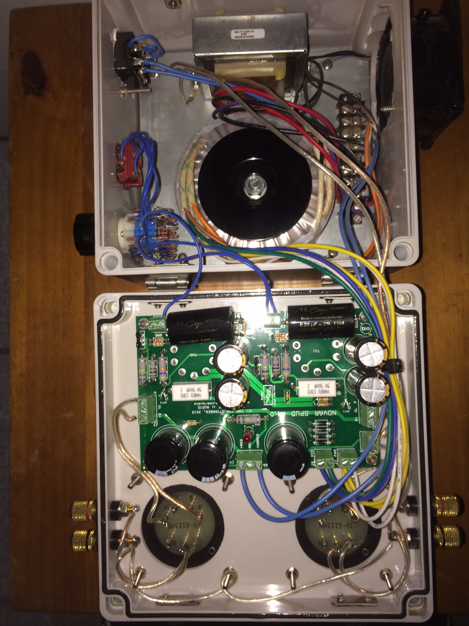

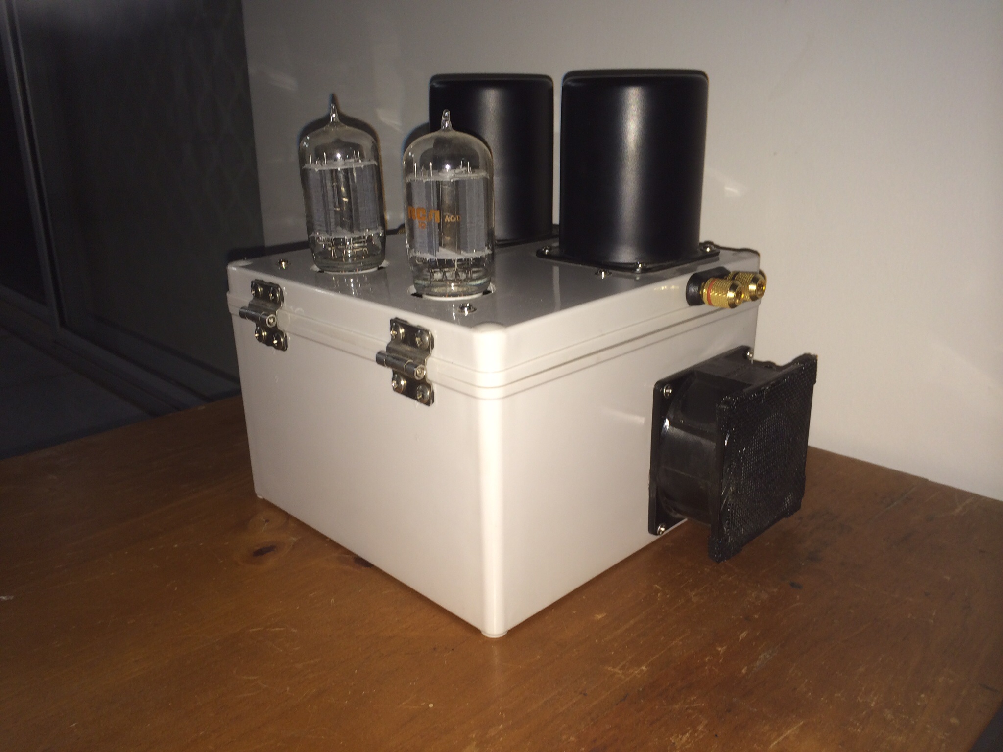

Here's mine. The "industrial" version 🙂
That's pretty sweet! The fan might be a bit overkill, though. Some ventilation holes top and bottom would have done the trick as well. I like the compact form factor. That's exactly how I intended the PCB to be used. Nicely done, Sir!
~Tom
Thanks for your kind works. 🙂
The box was bought from an electrical wholesale company, it's designed to hold switchgear, relays, timers etc. I think it's made of PVC.
There's a steel plate fixed near the bottom of the box for mounting things to, keeping potentially "live" screws inside the box. If you have trouble finding one I can post one to you 🙂 It's the perfect size for this board.
Originally I fitted the fan in an effort to keep dust out of the amp; the amp normally lives at my (very hot and dusty) workshop. I had fitted one of those little filters to the fan but found it doesn't stop much dust anyway. Need to find a better filter! The temperature at work often reaches 42c and the amp does lots if hours so I thought keeping things cool may help with longevity.
