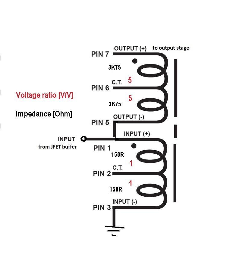

no , connect input to pin7
As always, I don't understand your answer
That's why it took some while for this post, to think it over....
What to do with pin 1 and 5 then?
is this a way the trafo can be represented in a different way, how papa used it?
sorry , 'twas a typo - what I meant - connect input to pin 6
usually , not using entire (all) winding(s) in xformer is not so clever
I wrote proper impedances and proper voltage ratios for Edcor 600/15K
for signal connected to pin 6 , calc. resulting gain with simple proportion

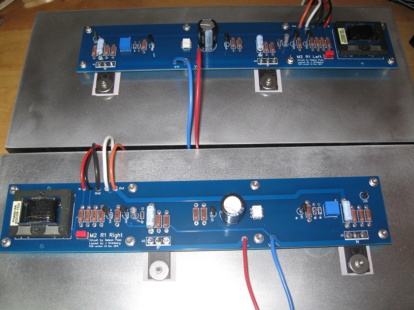

Following up on my last post, I assembled both PCBs and mounted them on a pair of Conrad heat sinks. I used a regular First Watt style PSU and listened to the M2 clone for about 16 hours on Friday, Saturday and Sunday.
http://www.diyaudio.com/forums/attachment.php?attachmentid=524431&stc=1&d=1452574993
It did not take that long to determine the amplifier was working properly. It is just that it sounds really, really nice, without being in-your-face about anything.
The Aleph J and the F5 have characteristics that I noticed the first time I heard them. The M2 does everything right and grows on you. The hardest part was to turn it off each evening.
Thanks ZM!
I've tried input to pin 6 and gain is indeed much reduced
How do I calculate? I would think when input connected to pin6 I will get: 5 : (5+1+1) at the output, so 5/7 * Vin= attenuation

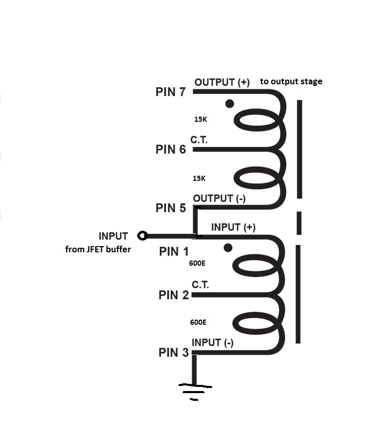

Why do they call it 600/15k trafo and the impedance you wrote are all 4 times lower?

Very clean and nice designed PCB!!! Shame it doesnt fit to standard case specs...
Otherwise If you could alter the design to meet the UMS specs I imagine this would be one of the biggest group buys ever..
Otherwise If you could alter the design to meet the UMS specs I imagine this would be one of the biggest group buys ever..![]()
You can request chassis customization and ask that the holes match the M2 PCBs. I can provide the exact measurements.
That's a great idea. BTW, congratulations on your PCB and build.
The M2 is quite the sleeper.
Dennis
Yes, thats also an alternative only if you will make your PCBs available??? GB???

What is the impedance to be used on the trafo?
Found out:600-15K....
