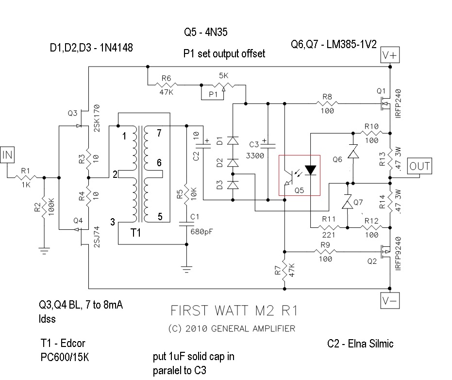

Official M2 schematic

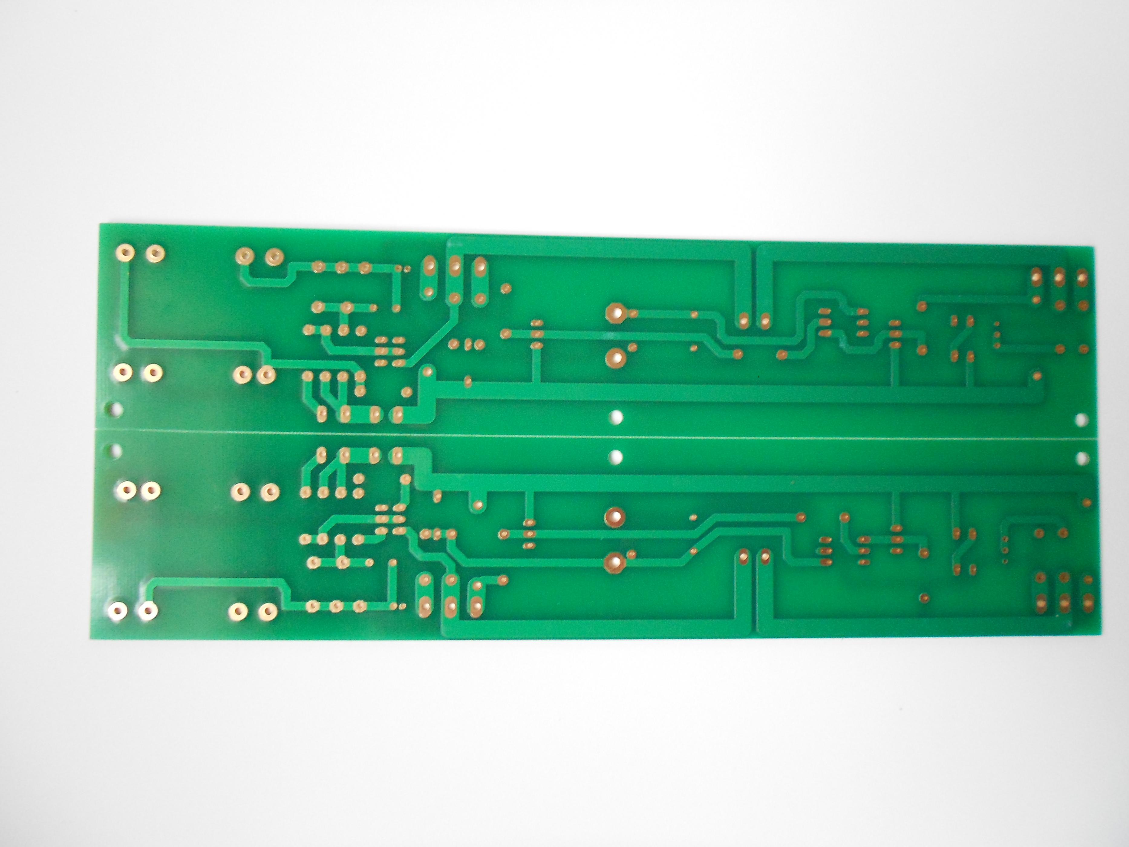

After a lot of ordering problems, I´m finally delivered next week (I´ve try about 5 manufacturers: cost gets high then the PCB consists in a lot of vias and price target should be not more then 15€).
Please be patient...
Jean-Paul
How are things proceeding? Take your time, no chassis for me to buy in DIY store, have a few amps waiting for their arrival.

Simplicity is the ultimate sophistication...as they say!! Such a simple and clever design!

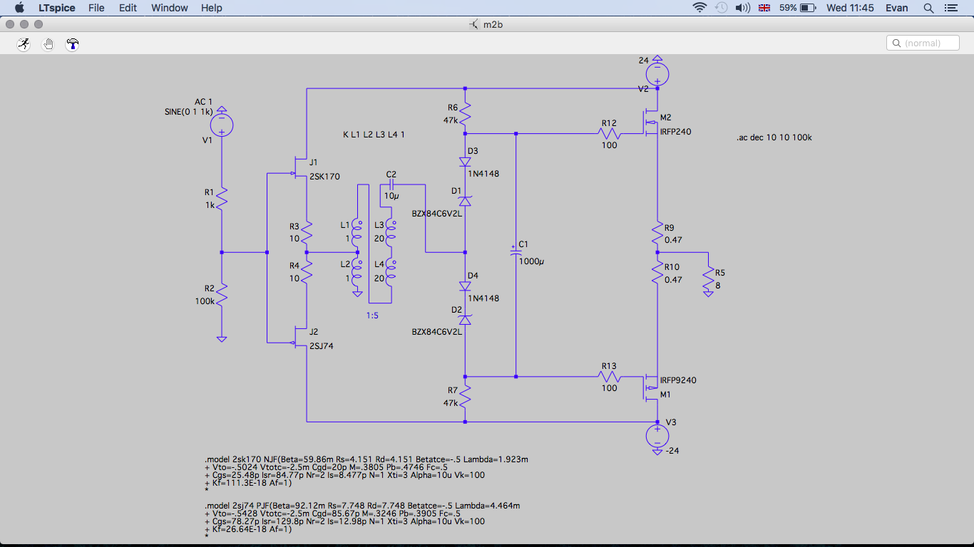

I've been speculating about the schematic for months now, and I thought it was was going to be something along the lines of the attached.
I did scratch my head too when I first saw the schematic. Initially though that the diodes were biasing zeners and the optocoupler served as some sort of limiter circuit.

If I want less gain for my headphone amp, can I connect the output stage to pin 6? And have half of the gain, 9dB ?
Do I have to change more, because of different impedance?
What do I do with the free floating pin 7 ? 🙂
