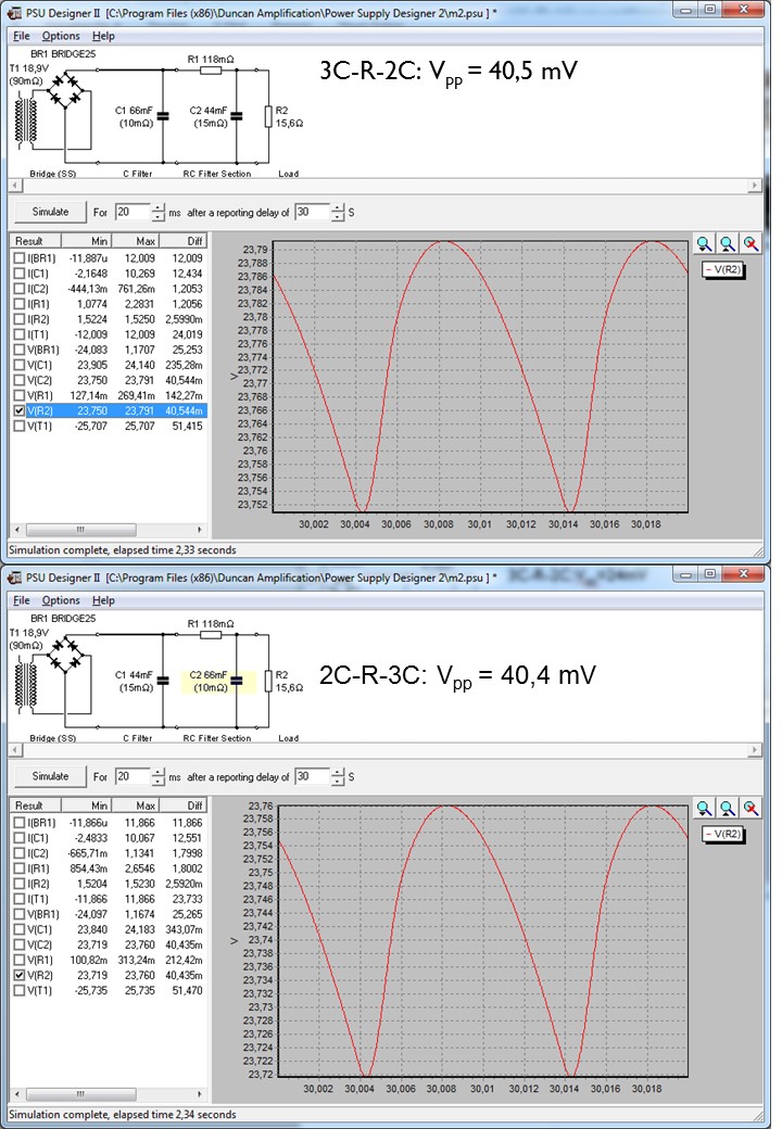

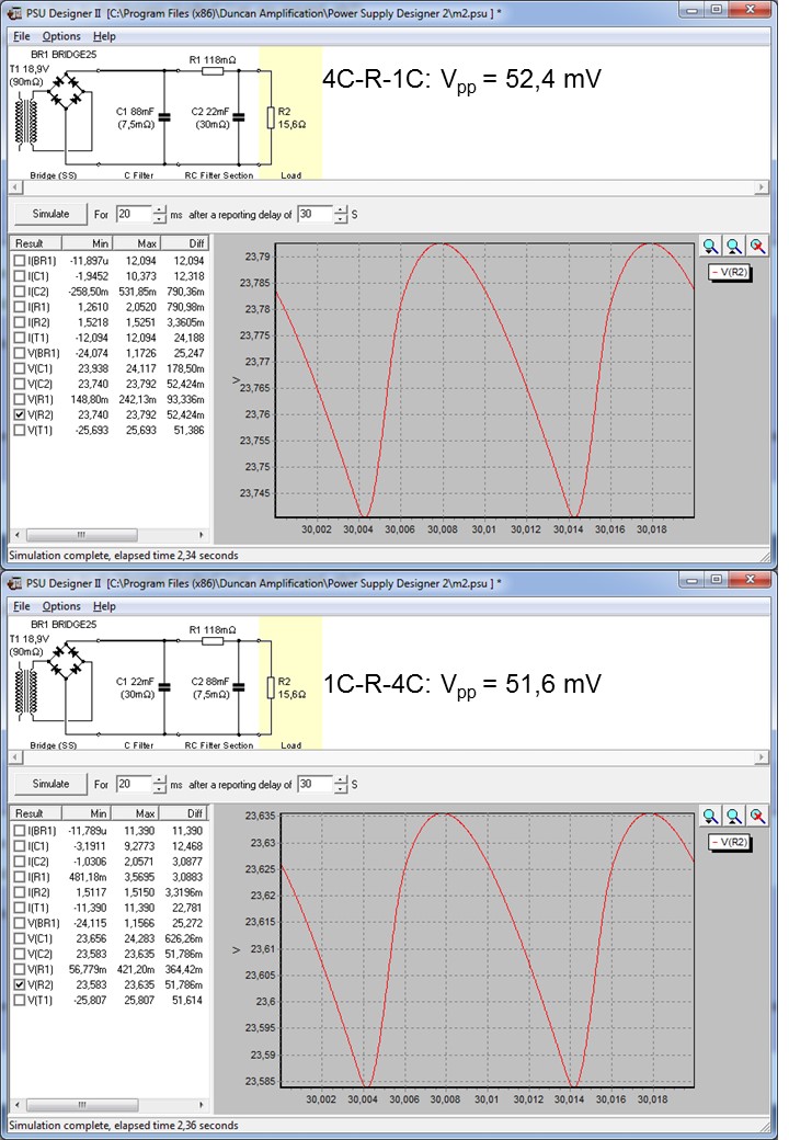

I have 10 cans 22mF each coming for the PSU.
How shall I combine them for the filters of the two rails?
rectifier-CCRCCC-amp
rectifier-CCCRCC-amp
or even
rectifier-CRCCCC-amp
rectifier-CCCCRC-amp?

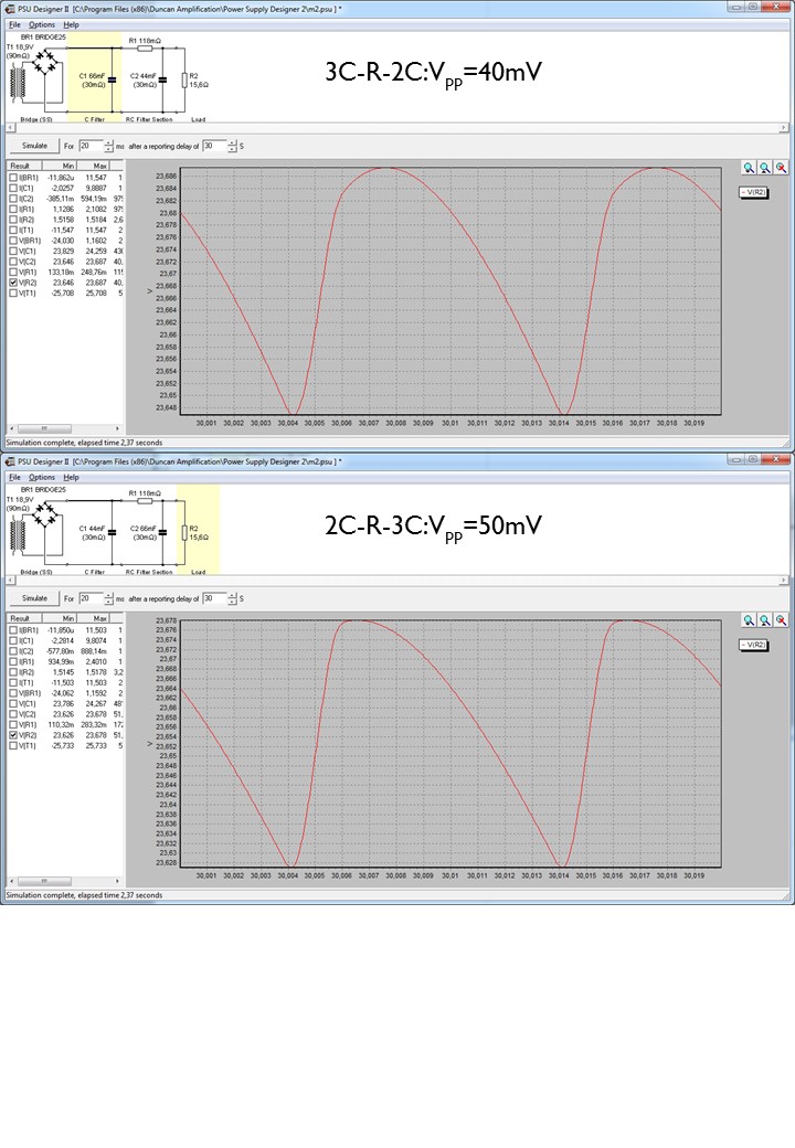

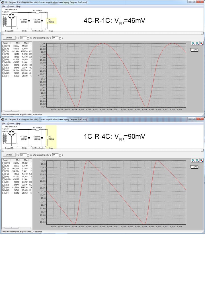

Try to simulate whit psu tool! I would use 5x22mF-R-5x22mF.
But if you have only 5 per rail then 2x22mF-R-3x22mF!
I also have 22mF in my psu. I choose 1x22mF - L - 3x22mF!
When I tried LTSpice and simply configured a CRC filter adding capacitance after the resistor had more impact on attenuation at 50Hz than in front.
PSU Designer II from Duncan's Amp Pages actually gives a different picture (Vpp)
2C-R-3C 50mV
3C-R-2C 40mV
1C-R-4C 90mV
4C-R-1C 46mV
2C-R-3C 50mV
3C-R-2C 40mV
1C-R-4C 90mV
4C-R-1C 46mV
When you arrange caps in parallel, effective ESR drops.Just downloaded LTSpice and need to learn e.g. how to do "dynamic loading" (can you expand, pls?)
Caps are Panasonic TS-UP ECOS1EP223CA and the ESR I find in the sheet is 0.029Ohm@120Hz. In the sim I put 30mOhm. Where is my mistake?
Two caps in parallel: 1/R = 1/30 + 1/30
R = 15mOhms
3 caps in parallel will be 10mOhm etc

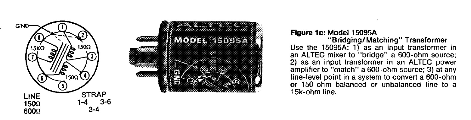

Altec 15095A
Hi. I have a couple of these lying around and was wondering if they could be used in the front end of the M2. I've attached a couple of pictures of the Altecs hoping for suggestions on proper hook-up. I've already put together a pcb in diptrace that I posted if anyone would like to look through it to see if it makes sense. Thanks.
