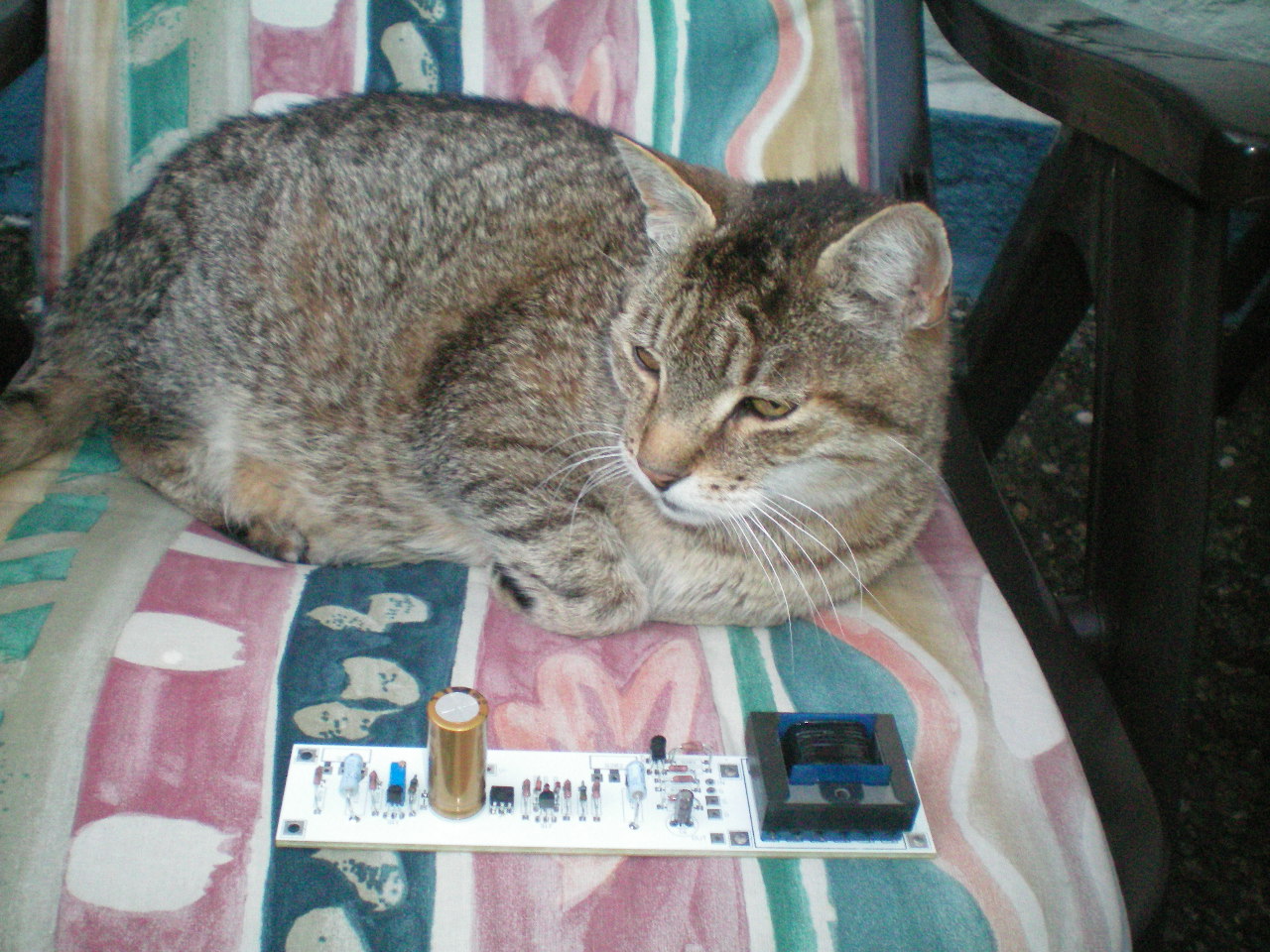

Cat trying to understand the diodes in M2…….
