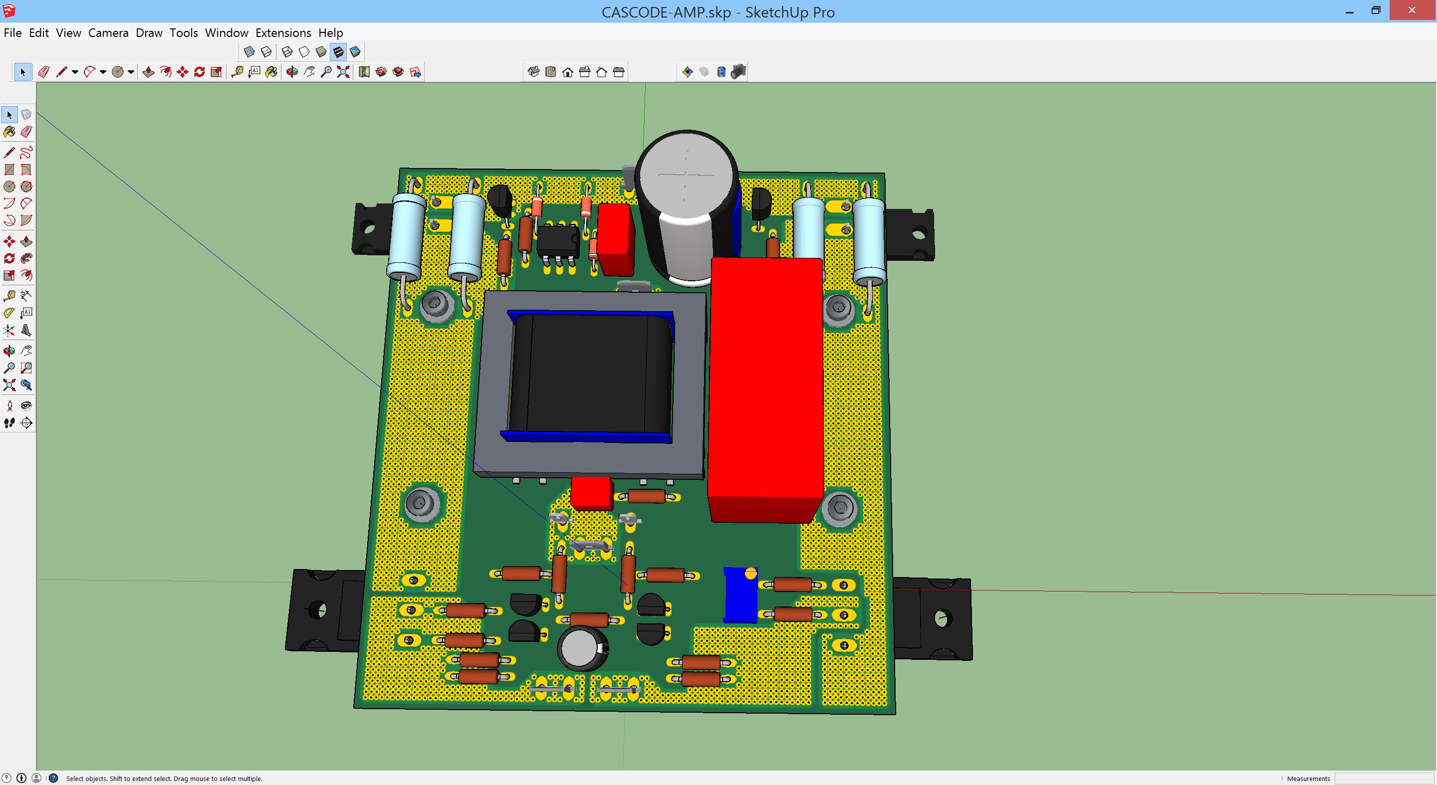

cascode version...
But I don´t know if there is a really demand?
The M2 is cheap, the costs are mainly the selected JFET´s, the transformer(s) and the enclosure.
Jean-Paul
The beauty of it is if you have jfets with idss above 10mA you can use them with cascode.
Also if more power is needed or someone has transformers with 24 secondaries then that can all be taken care of, which can't be performed without cascoding the jfets.
I mean, is there a really demand for PCB?
I try to define HIFI2000 enclosures in 3D for simulated complete M2 assembly (depends on quality of the 2D HIFI2000 documentation).
Idea for the supplies?
Jean-Paul
