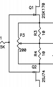

Nicoch,
in response to your PM: The arrangement to add a trimpot to the input stage of the M2 looks like the attached.
The snippet is taken from p.2 of the F5Turbo article by Nelson.

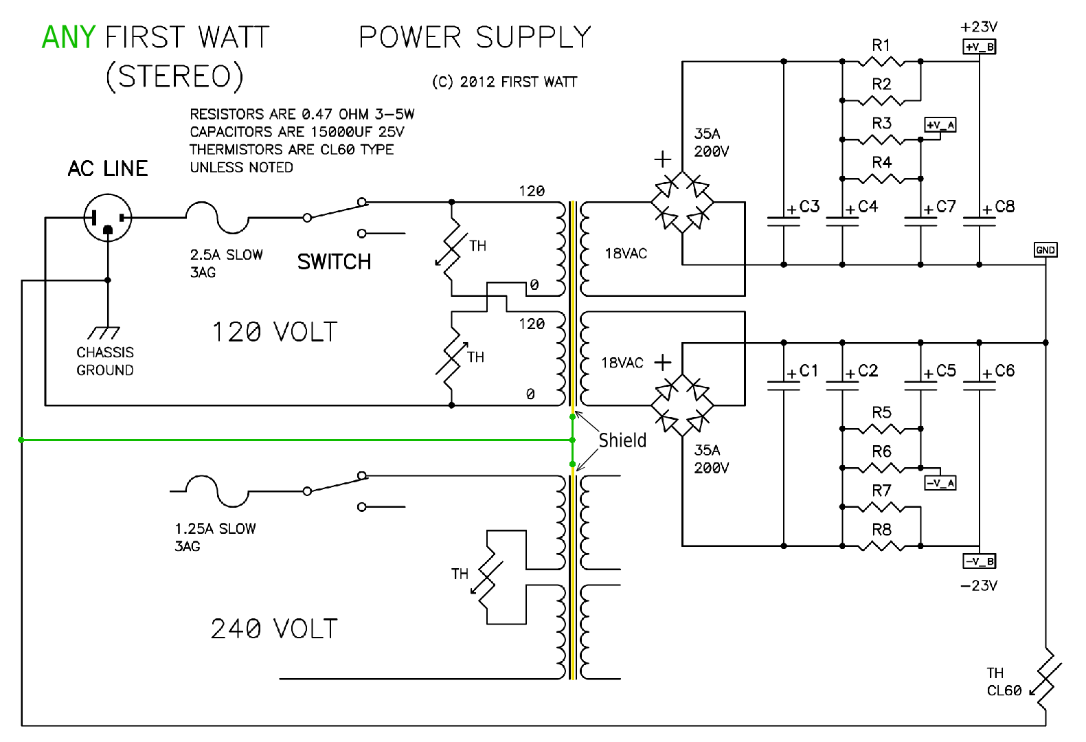

Hi Generg,
Can you show a picture on how you shield the transformer? My friend is experiencing hum when the PS board or the rectifiers are close to the amp module/Input transformer. Even if just the rectifiers close to the input transformer will cause hum. No hum if we put all the power supply cap bank, rectifiers and power transformer in another case or away from the amp module. We have also noticed that the rectifiers gets quite hot and vibrates, is that normal ?
I noticed a 3db increase on my left channel without the star ground. Im going to try running a separate ground from: supply-board-thermistor-ground and see if that lowers it, I also read that shielding the power transformer is better than shielding the input transformer. Overall my un-shielded M2 is buzzing about 6db louder than the F6 on 115db/w drivers.
On Antek transformers their is a shield wire, where is the best place to connect it?
Can you discern whether you experience a 50Hz or 100Hz hum?
I am getting a 50hz.
To make it clear:
You want the shield to be connected to a point which has the biggest distance to your audio signal, and also from the audio ground. And this is the ground/earth from the AC mains, where it gets into your amplifier's case. You can put it to the connection, where you grounded your case (so where the ground/mains connects to your case).
A picture does say more like 1000 words (especially if it's not your mother tongue
