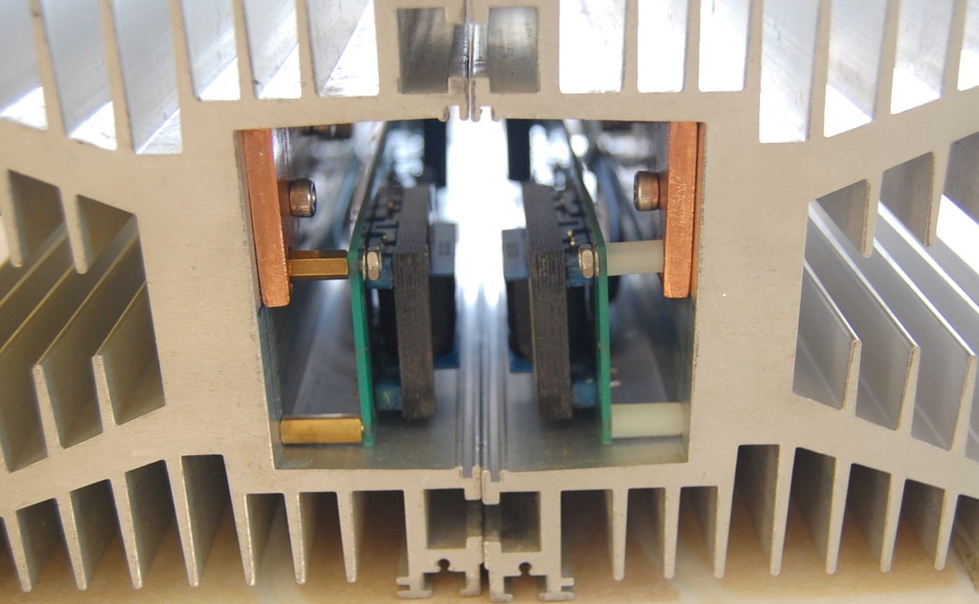

Hi" I am hanging in my inspiration M2 chassis because I has realized the input transformers are very closed each other. Would it be okay if I place them in this location? Interference is a concern.

just go for it
if worry , put steel sheets in those channels in heatsink
as example - they're puttin' two MC xformers in same case ...... and I can't imagine more cautious engineers![]()
Thank ZM,
Thank ZM,and Is it work to use a copper sheet? I already have in tool box box.
Earthed copper will shield an electric field but not magnetic.
For magnetic shielding, you want iron or something with even better magnetic permeability
nope , just iron will hold (somewhat of) magnetic coupling
There is nothing magical about Mu Metal other than an annealing process to improve magnetic permeability through modification of grain structure,
