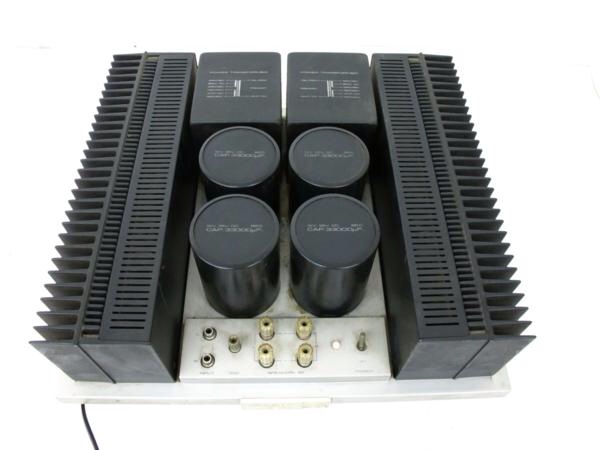

I see Pioneer made class A amps with psu transformers covers.

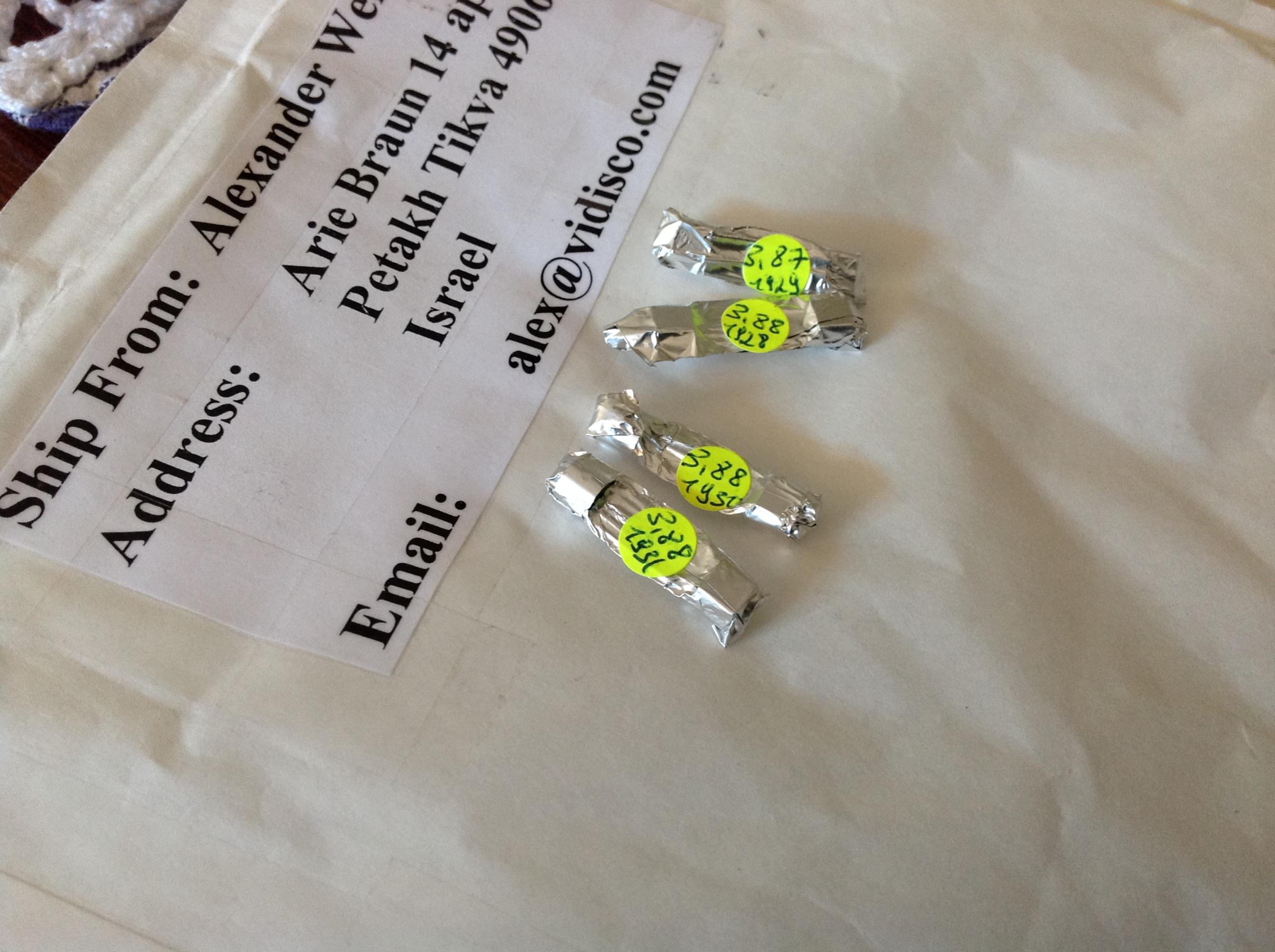

If that does not reduce the hum then I'm contemplating to swap out the Toshiba 2SJ74GR 2SK170G with the spare set I have on hand

do you have 4 pairs , by chance ?
it'll help if you parallel them ......
I purchased 2 sets - 1 set as spares just in case - But I won't bother now
It's easier to purchase the BL
