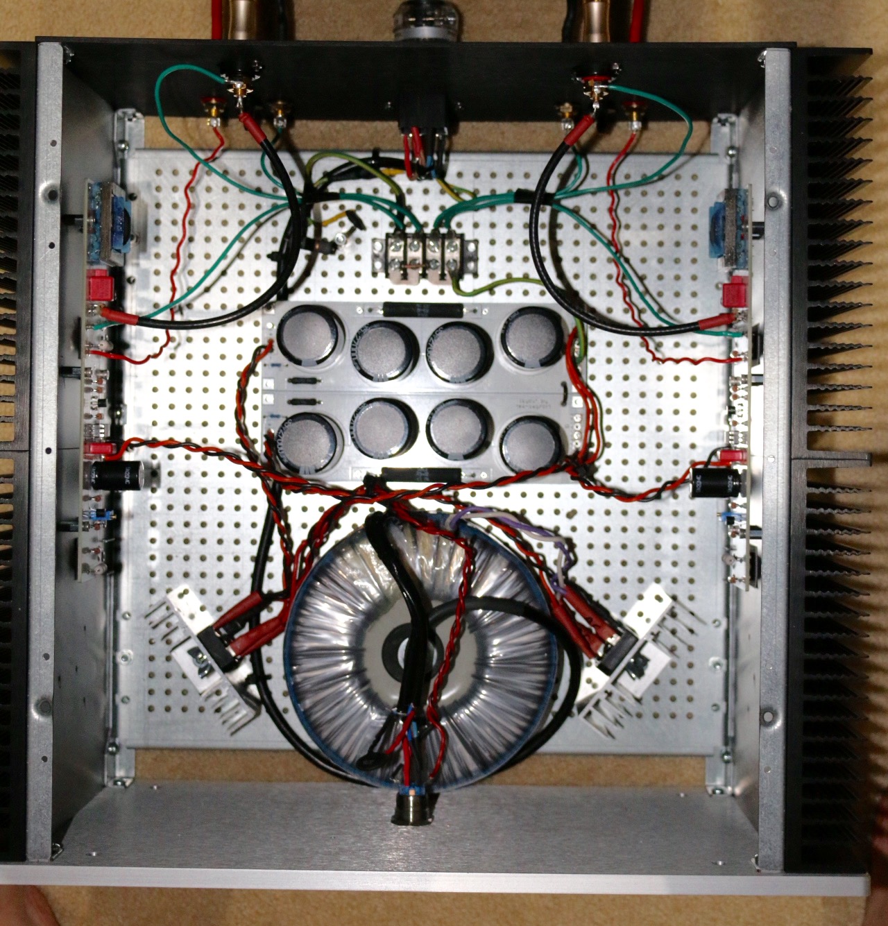

I require some assistance to pinpoint an M2 amplifier hum on both channels (tea bag version)
It presents as a louder than normal hum that can be described as earth loop hum
Speakers are 104db and other amps even the tube amp is quieter
Apart from an earth ground loop - as I am very certain that its wired perfectly as a star earth configuration as I was tutored by - wdecho and Tea Bag by PM
Also tried a bus style earth with no improvement
The amp hums plugged in on any power point and even when connected to a regulated power filter - a Thor PS10 - this can be set to supply 220 V or 240 V
And if you are still reading this the hum is constant on both settings
The toroidal transformer used is an audio quality spec from Germany
The power supply has oversized capacitors on Tea Bags boards
Also swapped out the fast acting bridge rectifiers for sealed type and mounted them on their own heat sinks
What should I look at as an alternative possible cause for this hum ? Could it be
1) Power supply cable (internal ) is NOT shielded ( have plans to swap over soon )
2) Faulty capacitor / s or Resistors
3) Unfiltered IEC power socket
4) Problem with PCB mounted transformers
5) Other unusual earth wire issues
6) Should I use shielded cable on all internal hookup wiring ( note RCA wire is shielded now )
7) Faulty CL60 ? On power side
8) Anything else

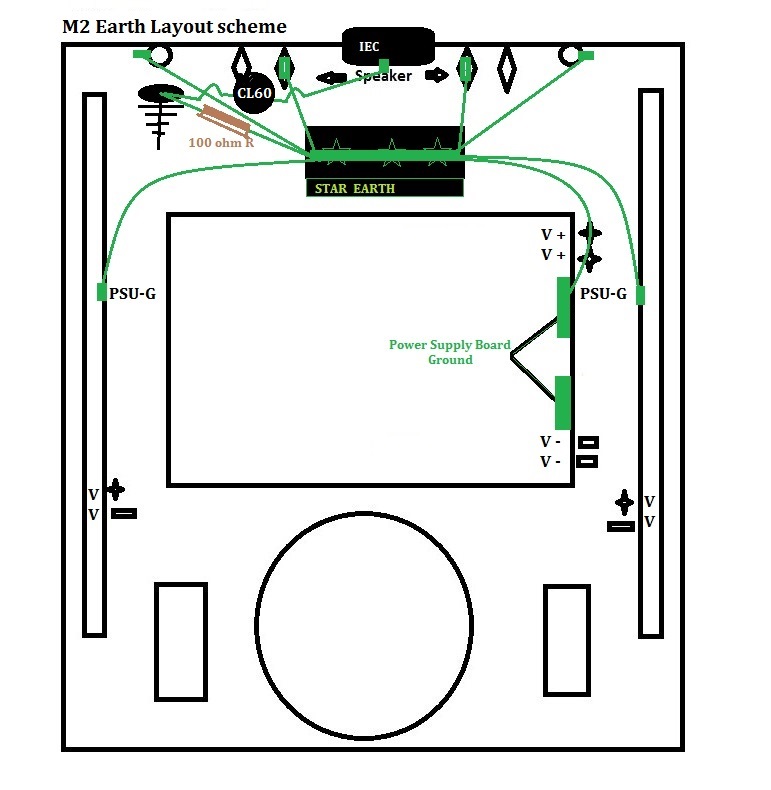

safety gnd from IEC goes directly to chassis bolt
then CL60 from chassis bolt to main audio gnd point
as I see it on picture , that's wrong - CL60 between IEC and chassis
Bolshoe Spasibo for that Zen Mod - Will change this tomorrow and post results
I agree exactly with this. That is the way mine is wired.

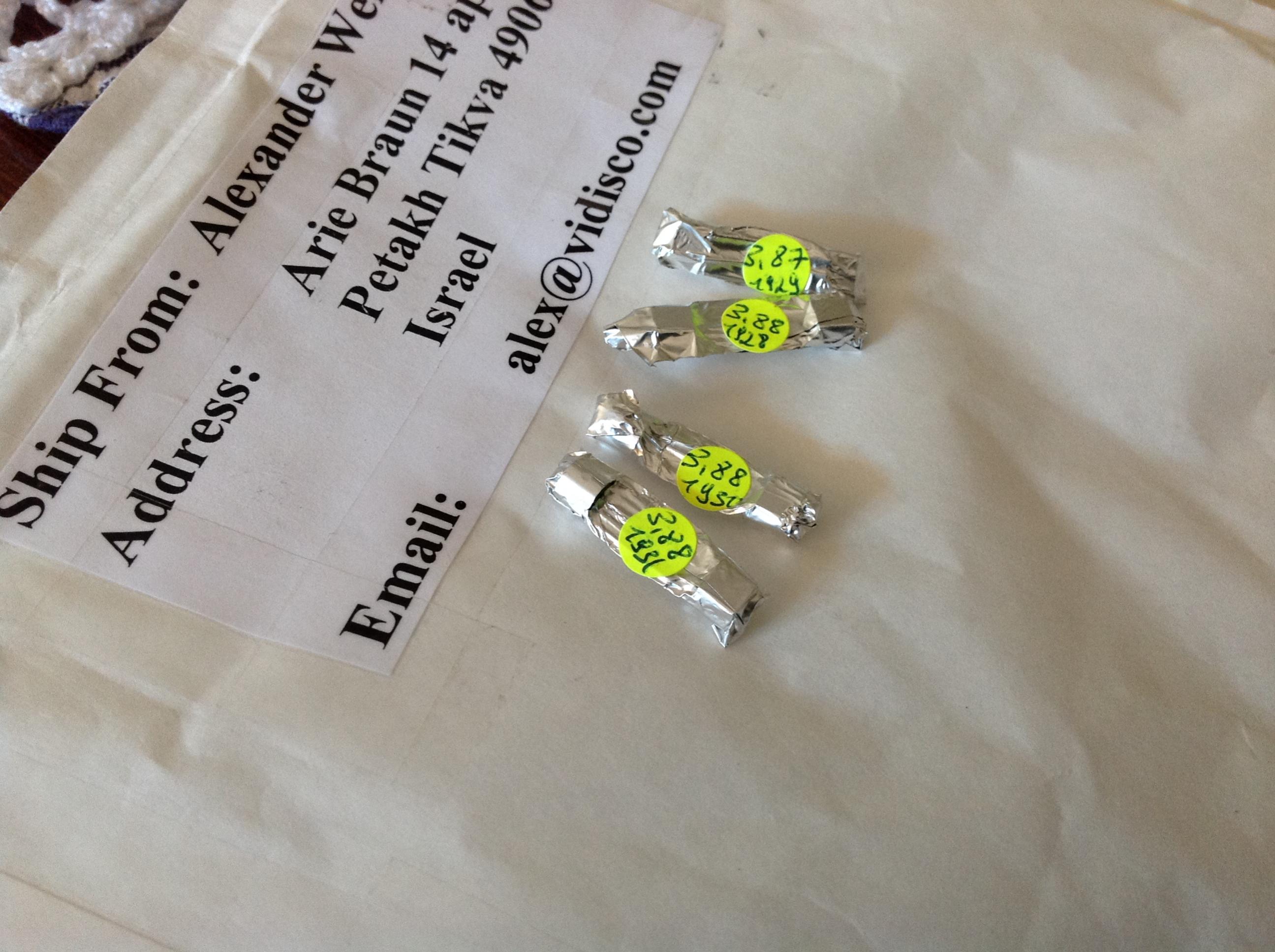

The Toshiba matched JFets were supplied by a fellow in Israel ( purchased 2 sets just in case I need a spare set )
Also I had the boards populated by a professional electronics technician so I'm sure all is well with solder joints
If it is Alweit (audiofet) he has a very good reputation. My understanding is that he only has GR grade left though. Unless you can find a grounding problem somewhere you will probably need to start looking at the boards. The reason I ask about j-fets is fakes can be noisy.
