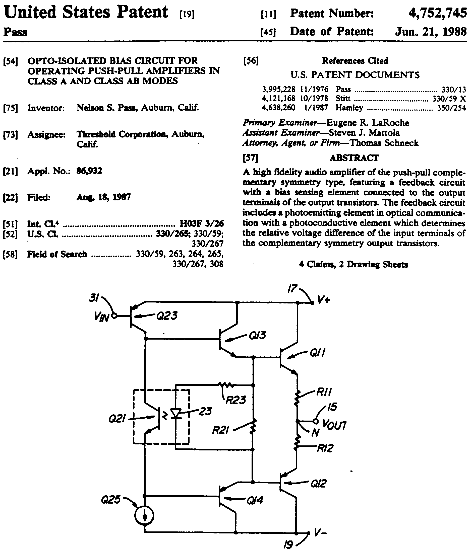

And what about losing the source R's altogether?
The bias circuit actually doesn't know anything about the output except
the voltage across the two .47 ohm Source resistors.
Dear mr. Pass,
and what about my suggestion above, to have the bias circuit not knowing anything about the output, NOR the voltage drop across the source resistors? Of course, me being a simple chemist, I hope you forgive me not telling cathode, emitter or source degeneration apart 😉 At least I meant the source degenerating resistors (0R47 in the design). The suggestion remains valid and usable imho. What about having the bias circuit taking its input (I called it 'sense') from the voltage drop across the resistor in the CRC filter in the power supply? The source degeneration is no longer needed in that case, and effectively more class A power would be available from roughly the same design.
kind regards,
Mark Bolech
It's more tricky than you might think.
Let's take the example of reading the bias current from the voltage drop
across the resistor in the CRC filter. For quiescent bias without current
flowing through the load, you can use the DC voltage to adjust the bias
voltage across the Gates of the outputs. However when significant amounts
of current start flowing through the load and the output starts approaching
the Class A output limit, the voltages across those resistors increase on
average, shutting the bias down.
I have attached a copy of an old patent as an example, where it works on
the driver transistors because they don't have enough variation in their
output current to create this problem. This phenomenon in also part of
the A40 amplifier, where the amplifier would lower the bias when the output
exceeded Class A.
In the M2, this is avoided by a more clever scheme where the drive to the
opto-isolater is limited by the LM385's which coincidentally are very close
to the forward drop of the LEDs.
In any case, any adjustments made by the circuits to the bias is
differential to the bias value, but common mode to the signal - any
noise or distortion it might create is sums to zero at the Sources of the
output devices. And, as I indicated, the circuit is shunted by 3,300 uF
so as to filter any such noise or distortion.
You will get the sense that I am still happy with the circuit, even though I
no longer use it.
Thank you for your insights! I downloaded your patent and like the engineering solution. I already felt coming that implementing the control of the quiescent current from taking the voltage drop over the power supply filter resistor is not straightforward 😎. Still, I feel that a comparably elegant solution as you designed into the M2 with the LM385's bootstrapping/limiting the voltage input into the optocoupler, must be achievable in a modified amplifier design without source degenerators. And -quite likely- with more class A power output available at equal quiescent power loss. Possibly a solution 'sensing' the voltage drops over the resistors in the CRC filters of both + and - supply, and using two optocouplers in parallel to define the bias voltage.. Anyway, i will do some more thinking and hope to come up with a solution sometime soon 🙂
