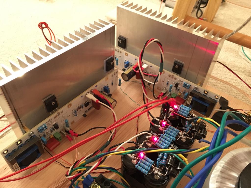

New PSU with lots of caps

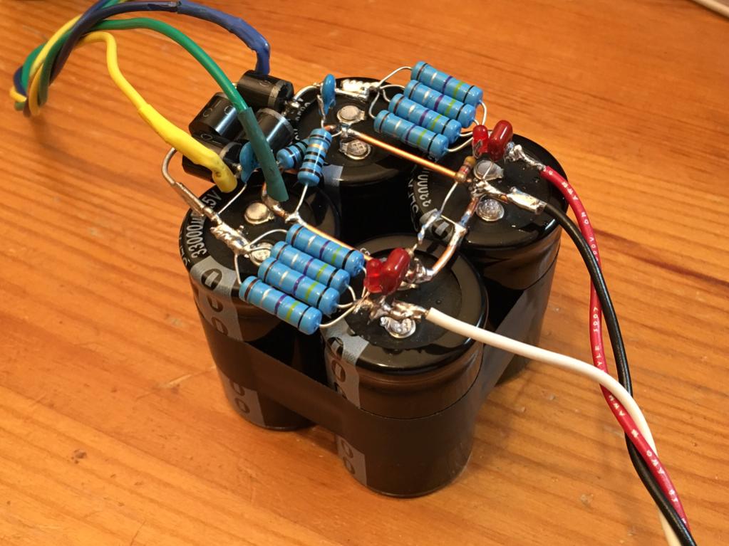

I built the recommended qnty 4 x 33,000uF CRC PSU with qnty 4 x 0.47R per rail. I added a 330pF & 10R snubber to clamp the diode switch noise and 100nF 100V MKT bypass caps on the outputs. The DC power ripple with full class A operation is measured at 19mV. The nominal 25v rails sag to about 23.5v when running.
The extra caps seems to have improved the sound stage width and imaging. The overall dynamics are very good and I am actually starting to enjoy the sound on a lot of material. Listening to Gretchen Parlato and Melody Gardot. Also throwing in some Paul Moatian. Good stuff.
Here is a closeup of one of the new PSU's made with P2P for super compact footprint:

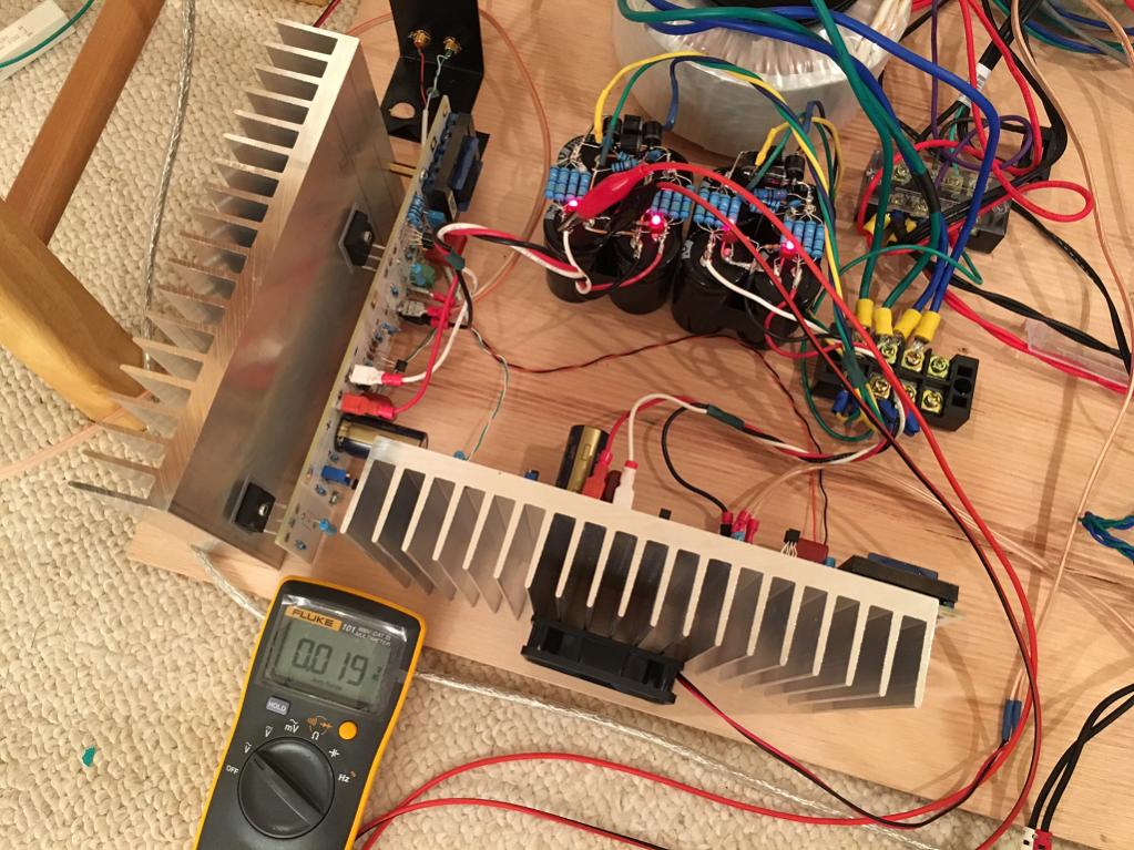

Here is the measurement of the ripple with DMM:
![567848d1472892618-official-m2-schematic-m2-build-05-new-psu-closeup.jpg](https://www.diyaudio.com/forums/attachments/pass-labs/567848d1472892618-official-m2-schematic-m2-build-05-new-psu-closeup.jpg)
![567849d1472892618-official-m2-schematic-m2-build-05-new-psu-ripple.jpg](https://www.diyaudio.com/forums/attachments/pass-labs/567849d1472892618-official-m2-schematic-m2-build-05-new-psu-ripple.jpg)

My kind of PS board. I do install them on a small wood board with hot glue and then install the board in the case. And do cover them with a magazine when you are working inside the amp. Drop a screwdriver on them caps and you will get a wake up call. When the amp is finished and the cover is on it will not matter which side of the caps are up. I expect you already know all this but for those that don't.
I see no sense paying for a board when all it does is hold the caps and a couple of resistors but then I am a cheap diy'er.
