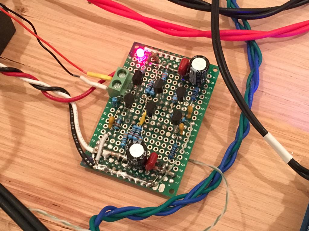

Just built this simple Apex Audio preamp (10.3dB gain):
http://www.diyaudio.com/forums/soli...imate-fidelity-amplifier-861.html#post4822088
Clean and transparent with just enough gain to make the M2 loud enough with my usual inputs. Conveniently, it uses same 25v rails as M2, so it's easy to add on without any extra PSU considerations.

You mean like BA-3?
Or simple buffer or simple buffer with gain, aka The KISS
X, thats not simple, very complicated design just for preamp, look at so many transistor simbol
for me who enjoy soldering rather than understanding basic EE, what I call simple is like BA3 pre, ZM iron pre, or Luminaria
ahh, maybe thats why i love this subforum rather than solidstate
It's all symmetric and that's two channels - just look at veroboard implementation. I agree 6 transistors is a lot more than the 4 on the M2 but there's very low distortion as a result. Yes, this is usual stuff from SS forum but it drives me nuts that a power amp doesn't come standard with 24dB to 30dB gain like the usual designs on SS forum. We don't need no stinkin' preamps for those cases. Also, let me ask you all this question: is an amp with 4 transistors really a simple 4 transistor amp when it requires a preamp to be useful?

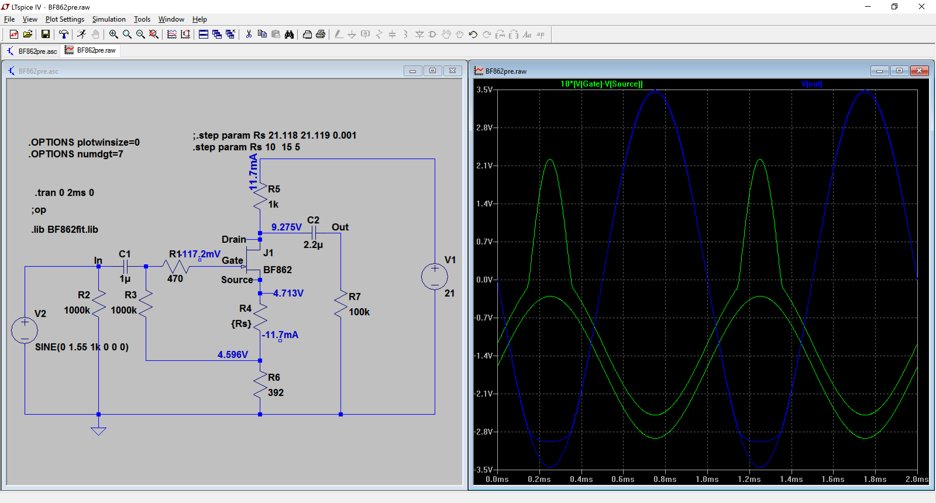

Maybe I should have made this one - perhaps more acceptable to this forum?
![566336d1471987527-bf862-preamp-clipping.png](https://www.diyaudio.com/forums/attachments/pass-labs/566336d1471987527-bf862-preamp-clipping.png)
That is indeed clever and simple. How much gain do you get and what is added distortion like?
