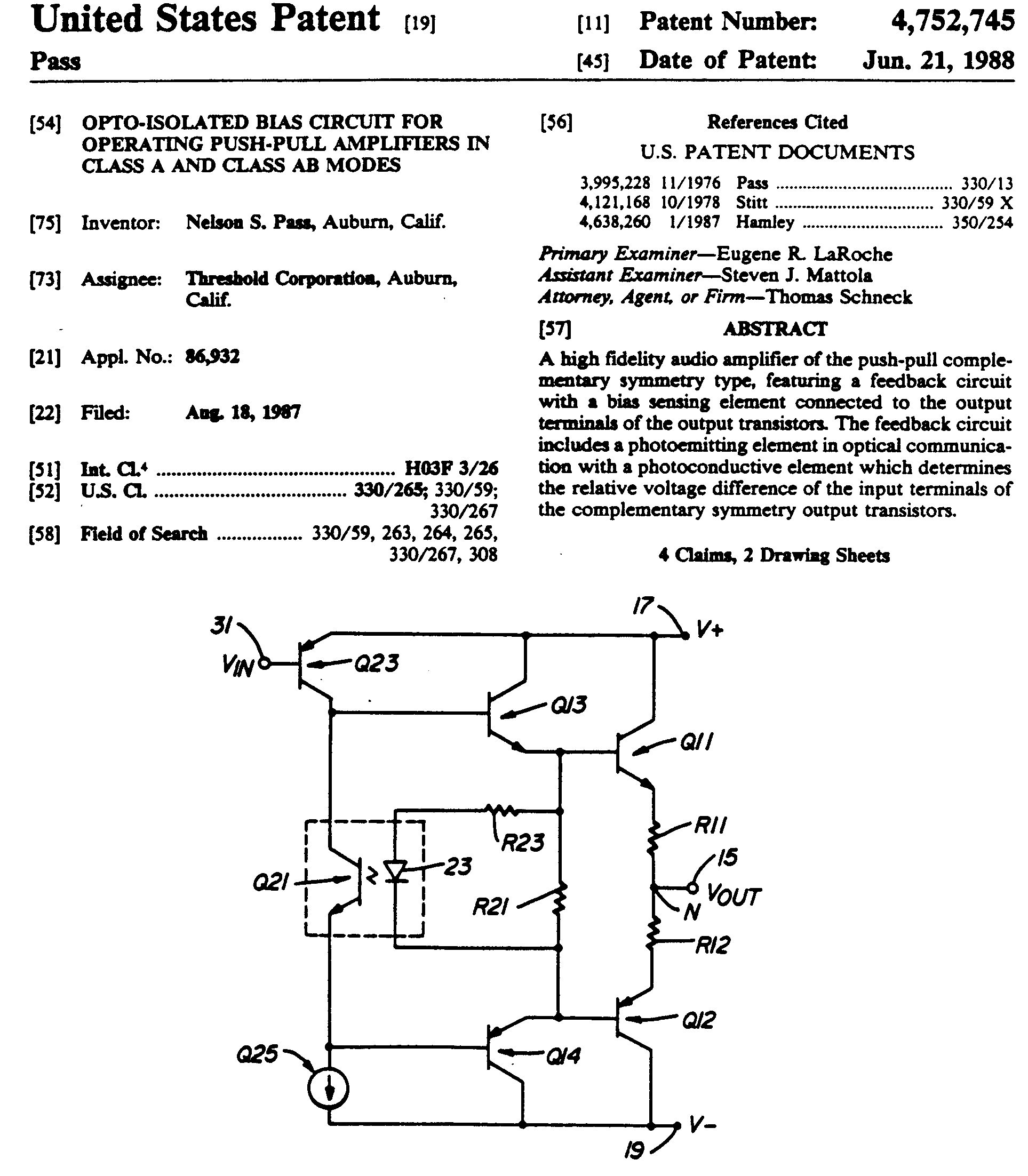

@Mr Pass - I am really impressed by the auto-bias circuit here on this amp. Could it be used for lower bias class AB amps where we typically use a temperature compensating BJT thermally mounted to the heatsink to prevent thermal runaway? Is calculation of resistors to set bias current done the same way and even a pot could be used for variable bias adjustment. What keeps the system from thermal runaway as there is no temperature sensor?

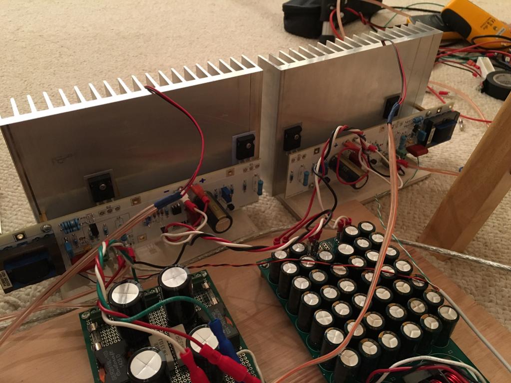

Hi xrk. I don't suppose you could detail the heatsink size you have there? I just chopped a large heatsink from a solar inverter in half, and I'm trying to get a feel for if it's enough for a pass amp.

Completed pair of Teabag M2's:
It seems to be running at 1.3A bias current, and the neat thing was to see it start low, and rise fairly quickly once warmed up. I guess had I been listening I would have heard it go through class B, then class AB, then class A
Even with the 52.3k resistor on R7, I could not get the DC offset to zero out. It's bottoming out at -95mV. However, that's not going to stop me from listening.
I am using my existing PSU but with a new 400VA 18vac trafo which makes exactly 25.0vdc rails. Ripple is 56mV with CRCLC filter ending with 20mF of small 1k cap bank and about 29mF total per rail.
This amp puts out some heat on these slightly undersized heatsinks.
Thanks!
This is 7.28in wide x 5in tall extrusion, fins are 1in long and base plate is 0.375in thick. It's undersized so I augment with a small 60mm fan at half speed and it's fine. If heatsink was double this size, fully passive would be OK.
Here is the heatsink I used (cut to 5.0in long):
It's a cute little circuit which locks the bias current of the output stage based
on the voltage drop of the opto-isolator LED. It's a more sophisticated
version of my 1987 patent.

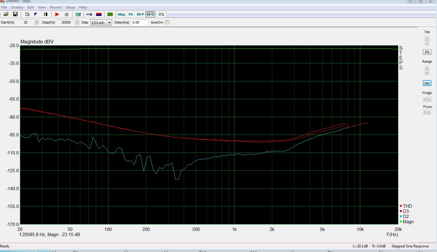

I am getting rather large measurements of H3 distortion at the speaker (normally not present with other amps). M2 seems to have a signature of higher than normal third harmonic from low bass to about 500Hz. Is this normal or is it something off? I am reading that the autoformer may be cause of this signature.
See speaker RTA's here:
http://www.diyaudio.com/forums/soli...audition-very-simple-quasi-mosfet-amp-17.html
Here is Harmonic profile with 200Hz excitation:
Here is speaker measured harmonic distortion (normally the HD is flat below 500Hz but notice the big bulging rise here).
Compared to my CFH7 amp (same IRFP240/9240 outputs but CFA topology) at same condition for speaker and mic and SPL:
The frequency response of the two amps, and M2 with and without preamp are pretty much spot on:

When I measured mine some time ago I got similar results, I think it is the xformer doing this.
My M2 clone is clearly k3 dominant. But this is all written by Nelson in his M2 manual and you can see it in the residual character.
Thanks for the plot - pretty much follows the same trend in the rise of THD and H3 on my speaker data.
I am not so sure I can live with this signature as I am very sensitive to distortion, especially 3rd harmonic.

I've been using a production unit for over four years. For my taste, much like ZM, it's one of the greats. It emulates a valve sound with none of the drawbacks save heat.
and I can add that I measured a real FW M2 too and it has this data too.
I was also a bit concerned when I saw this plots…..
But it does in no way impede my pleasure to hear M2.
This was for me am example how an k3 dominant amp can sound like a k2 amp!
And I do not why…..
And I do not why…..
Hmmm. I'd venture to say that our sensitivity to said distortion below 100 Hz is not the same as it is in the mid band. With few exceptions, it's extremely difficult to find, design or build a transformer without rising distortion in the bottom octaves. I will say the amp deserves the Best preamp that you can afford or build.
