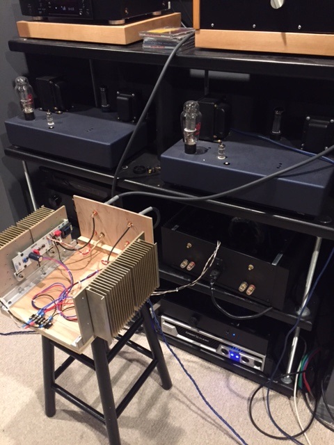

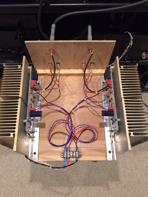

My M2 is alive! I let it burn in a couple hours before listening. This is one fine amp. I only have a F6 clone to compare with in regards to other First Watt designs. I find the M2 more relaxed sounding. It projects a big sound with most of the detail of the F6. The nice surprise is that I can play it louder than the F6 without sounding strained. It's very easy on the ears and my big horn speakers. I will compare to my direct coupled 2A3s next but right now I think this amp could be the long term replacement I've been hoping for. (I only use this amp north of 65 hz as my subs are tapped horns powered by a Crest audio pro amp and active crossover.)
The picture shows the M2 boards in a temporary home with power being furnished from my finished F6 in the diystore chassis. Bottom line, I really like this amp. Thanks to all who helped me here and to Teabags for the first class boards. And a huge thanks for the man himself - Nelson Pass.
