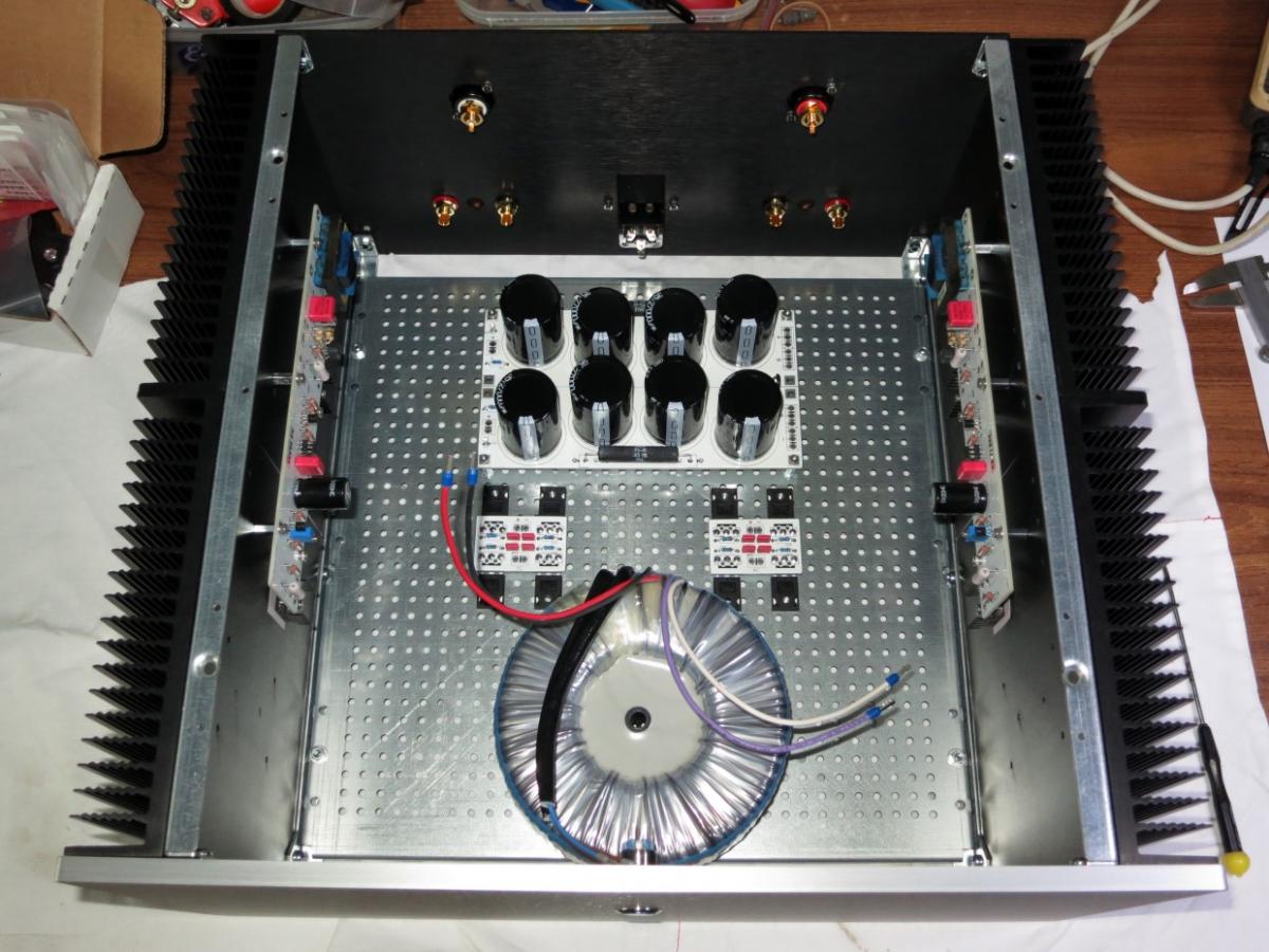

A quick M2 build update ( Teabag Version )
We had some delay issues with the toroidal transformer and decided to source another from Germany
Currently making some alloy angle pads to mount the power supply transistors then the internal wiring will be started
Here is a mockup of the amp as it stands

Is your casework deep enough to turn that PS board lengthwise and move the diode boards alongside the toroid and closer to the front panel?

It looks like it is. I have the same PSU board and case and there is lots of room inside!!

The toroidal transformer is quite large in diameter and it will make it a tight fit
What you see is the most comfortable fit in the 5U Deluxe case

There are compromises in both the case and supply board designs.
Yes it is.
But then the board would be almost hard up against the mains input.
Why ?
What benefit or issue do you envisage ?

Lengthwise allows a more symmetrical wire routing, that's all. Simply a question. If I had the room my OCD tendencies would run it lengthwise. I did my own M2 with Tea's Clone boards and PS as shown, but I had a smaller 4U case...
