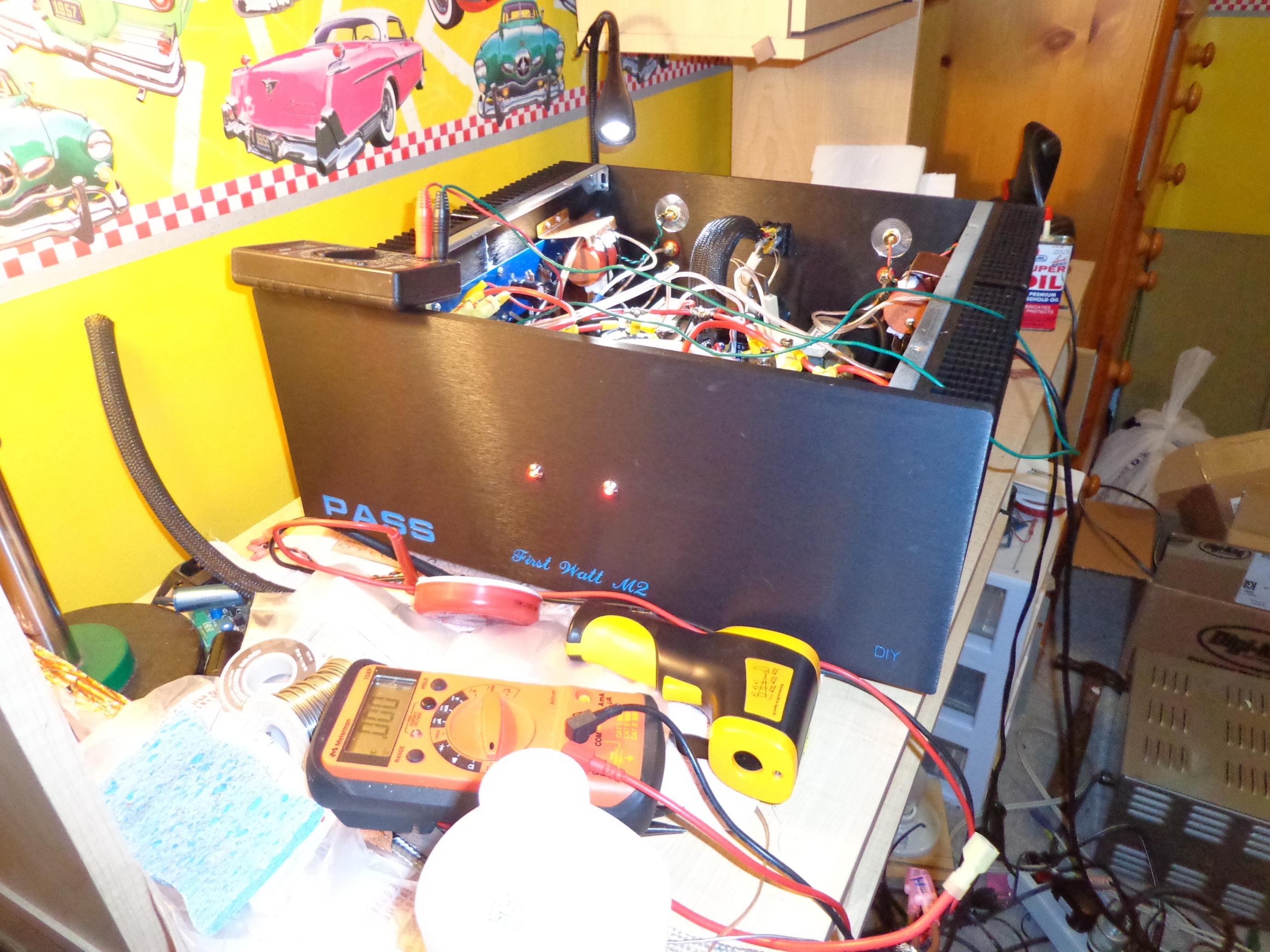

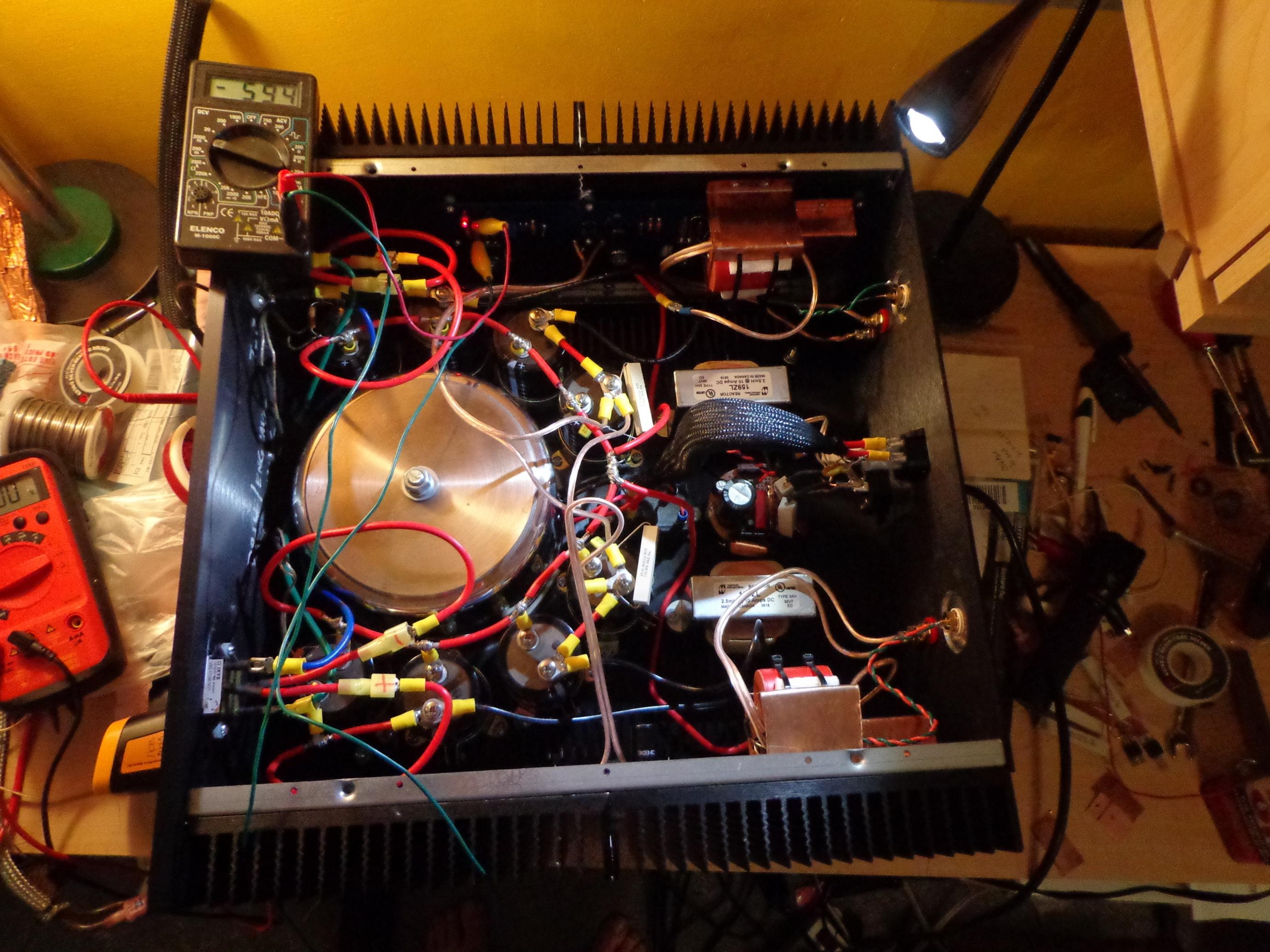

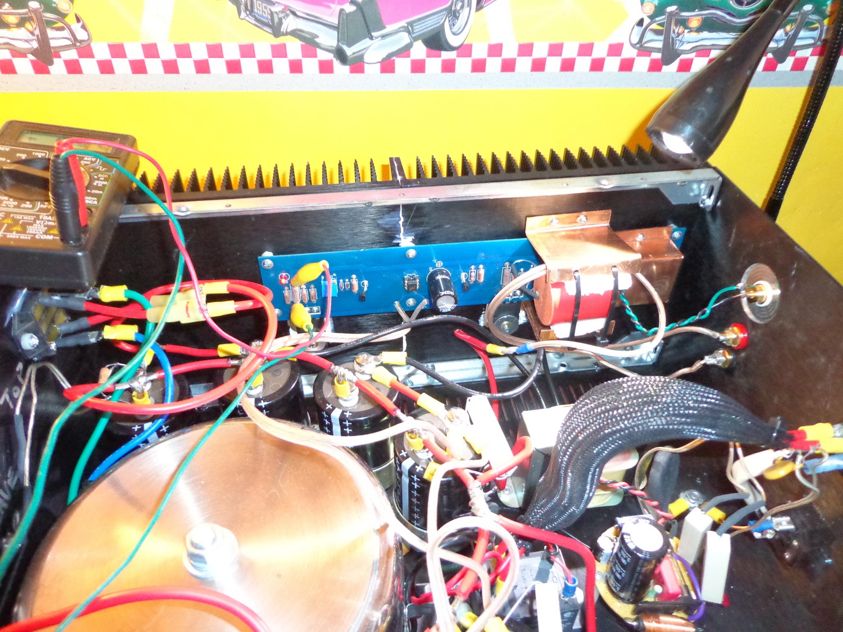

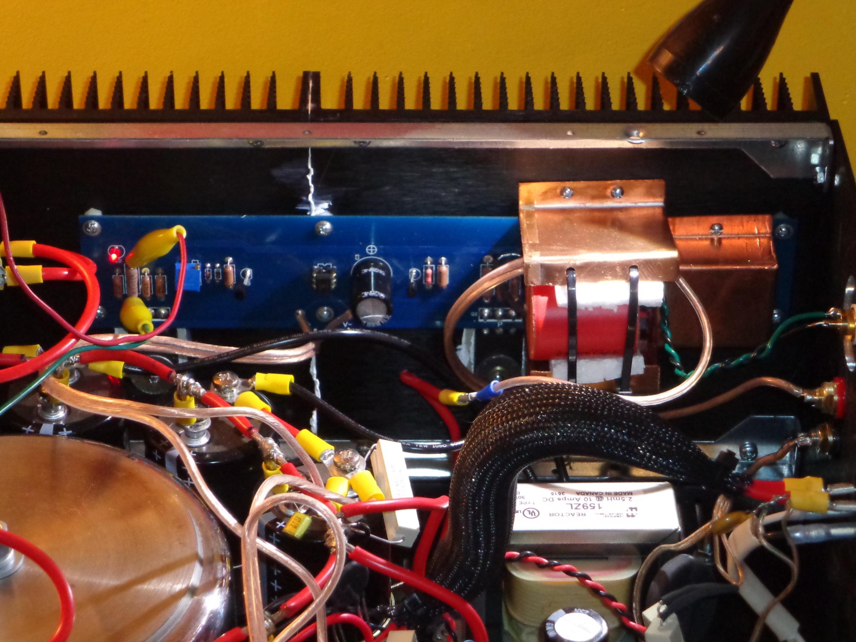

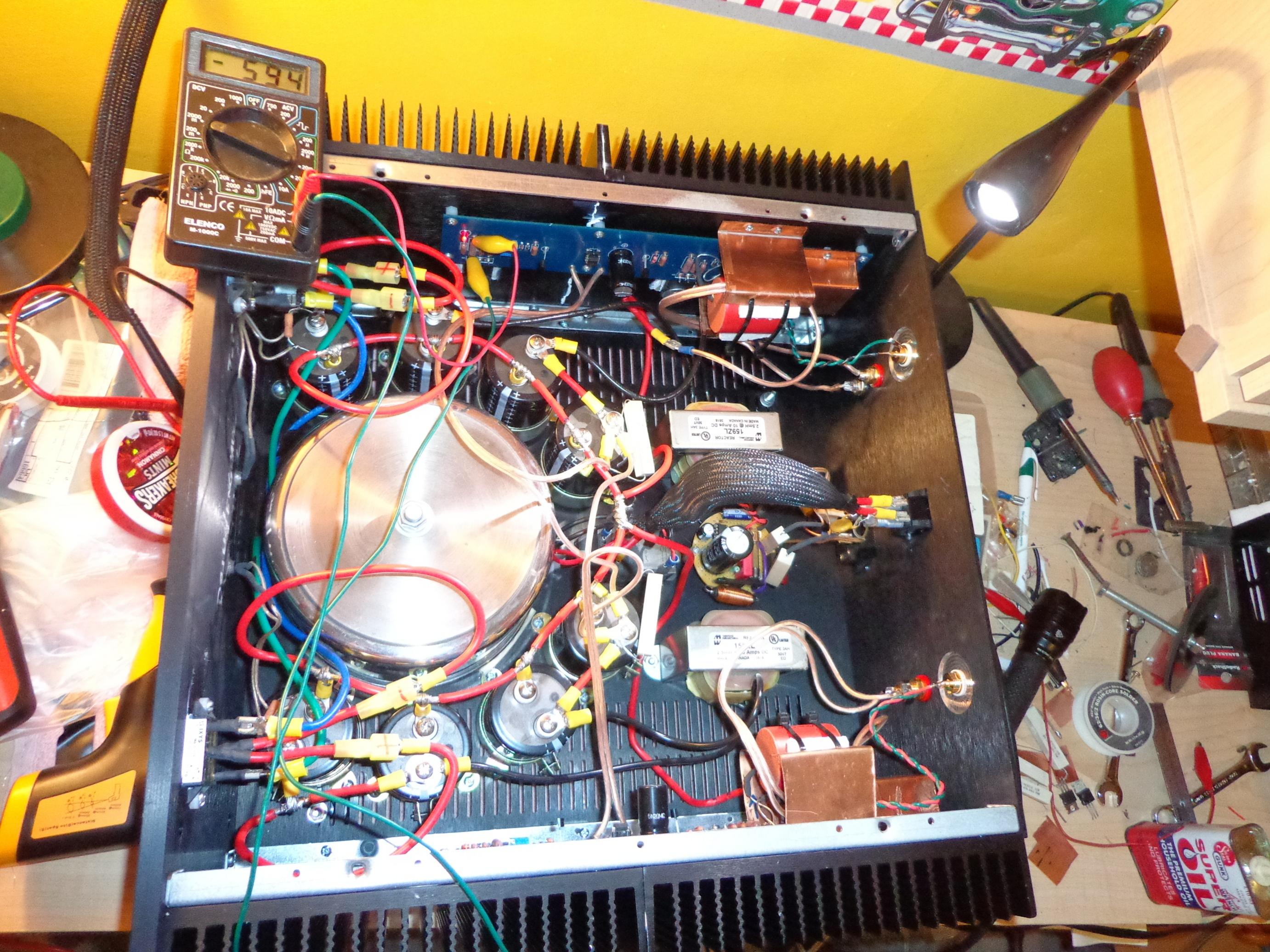

Finally got my M2 powered up. It uses Grimberg's boards, 2SK1530 & 2SJ201 and a CLC power supply, based on an Antek 500Va 18V transformer. Bias current is 1.8A, and after 25 minutes or so the heat sinks are pretty steady at around 50ºC. DC offset is 0.6mV, and doesn't seem to be affected at all by the trimpot. The only thing that seems a little odd is that the power supply rails are only about 20.8V instead of 22-24V. Haven't tried to listen yet.
