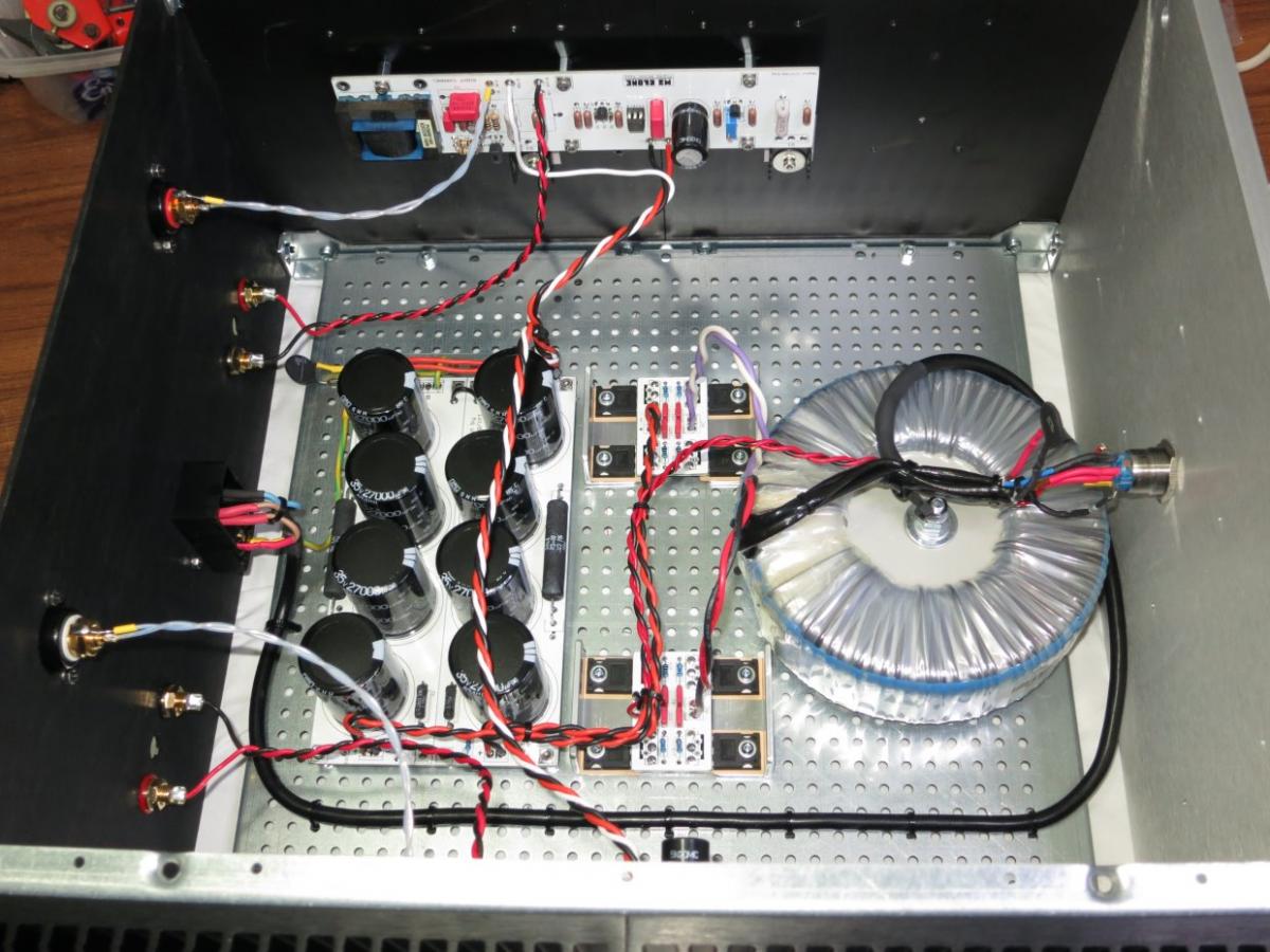

Lengthwise allows a more symmetrical wire routing, that's all. Simply a question. If I had the room my OCD tendencies would run it lengthwise. I did my own M2 with Tea's Clone boards and PS as shown, but I had a smaller 4U case...
BK
The orientation you note would probably work if the Tiroidial was 4" in dia
However the one being used is 6" in dia
2 inches is a lot of real estate inside a chassis
Specs are here - http://www.sedlbauer.de/files/ringkerntrafo_datenblatt_825059_e.pdf
I counted baseplate holes in your pic and it looked close, but of course the pic is not top-down. I have mine situated like yours, in a smaller case, and I have no issues. Either way it's going to sound great :cheers:
BK
If you want some adventure, you could elevate the toroid until it is just 3mm under the cover and then slide the rectifier boards underneath. That way the cap board can go more to the opposite side of the backplate.

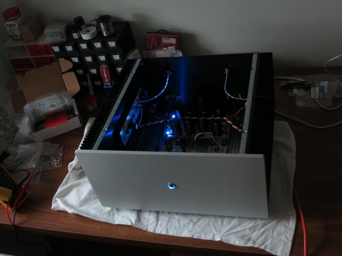

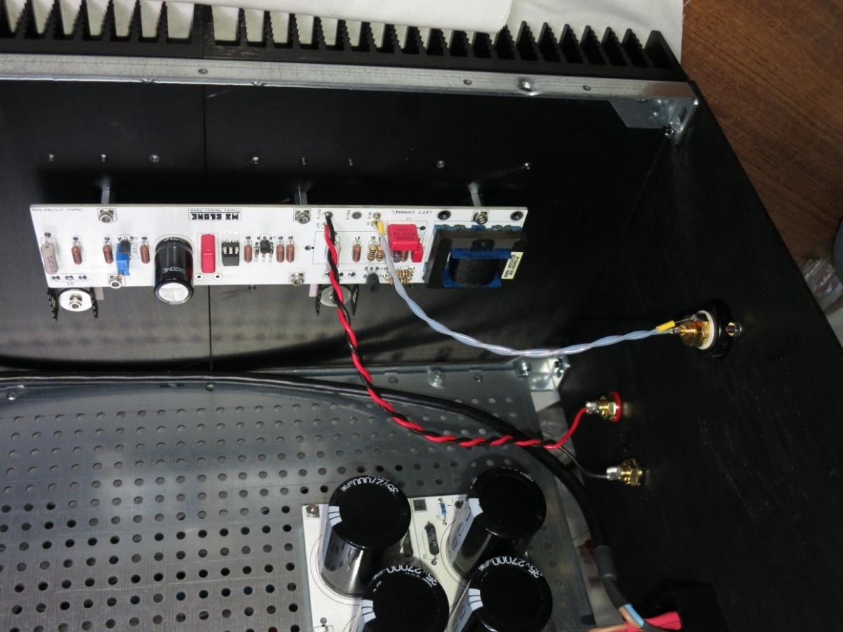

The M2 amp (Teabag Version) is now finished and burning in
It was fired up last night about 10pm, but first up was a slow variac rise for testing (no smoke
) :birthday:
However it was necessary to swap out one resistor on both boards to 'center' the dc offset.
Once that was done it was time to let it stabilize, offset is now under 3mv.
Both channels are so close you'd think they were matched.
So far the massive heatsinks on the 5U case are doing their job very nicely. Just over luke warm so far.
