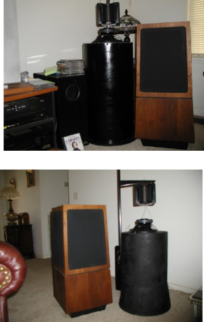

Hello Moray,
Thank you for the input as I was just thinking about slanting the baffle and considering the consequences of doing so.
The amputation of 4 inch's off of the SonoTube base (28 inch to 24 inch) had mixed results. On one hand it accomplished what I set out for - having a fuller range while seated about 10 ft. away - hmmm - about 3 meters or you metric types (bad Thomas bad - I just can't help myself from being a smart - xxx :censored: at times -apologies to all!). The bad news is that by doing so I reduced the VAS to much to make up for. Played with the stuffing to no avail. The lower midrange up to around 2K hz is just much better with the 28 inch tube. Perhaps if I kicked the diameter out to 18 inches to regain the VAS - but then I have what is approaching a really BIG baffle and another set of problems.
My thinking (about 30 seconds worth and thus needs a bit more thought) is that slanting the baffle will take away from the omni presentation of the speaker - which is an aspect of this build that I rather enjoy. Very nice open sound these little buggers have! Perhaps some room for improvement (isn't there always!) but this is a nice project in terms of return for effort and cost.
The underlying physics of this type of construction I find very interesting as it has a bit of OB design, a bit of pseudo Walsh technology (a moving cone Walsh? Who would of thunk it? :scratch: ) and I was able to find a use for my Heil drivers that I had sitting around. Plus it was a suitable project for a newbie such as myself and was reasonable in cost.
I'm a happy camper! :cloud9:

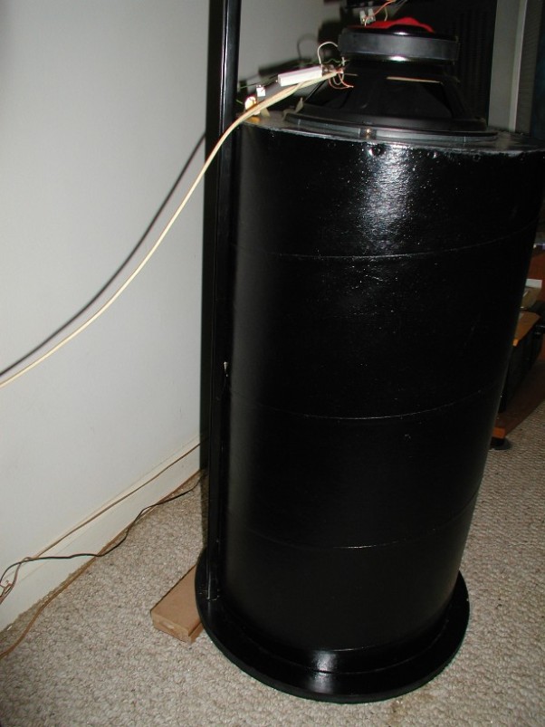

Hello Moray,
I have followed your suggestion and with some degree of success!
I can discern an improvement from my sitting position but have not had the chance to sample my other listening post as the spousal unit is camped out in the reading chair spot and when reading enjoys the music at around 60 db - not my normal 90 db's! Provoking her in any manner could lead to a "I'm getting out of the house and going shopping" response as a passive-offensive counter maneuver on her part and is to be avoided. Further testing at my favored SPL's shall need to wait until Her Majesty relocates to the home office. A small price to pay - I assure you!
Attached you will notice the precision tilt mechanism employed - consisting of a couple of pieces of scrap MDF planks placed under one edge of the speaker. You may also notice the prototype precision externally mounted crossover network along with a bit of felt to cover the vent hole of the Pioneer speaker.
I call this speaker unit "Alpha" and it's mate "Beta" for good reason!
The finished units will be refined a tad - but I just love prototyping! :D
Thanks for the tip - more investigation to come!
BTW - these litter buggers are good enough to discern the microphone pattern used to record piano (near or far miked - single or multi miked) and I can hear the foot pedal work on the stops. On violin I can hear the individual strings played on chords. Not to bad!
:cheers:
