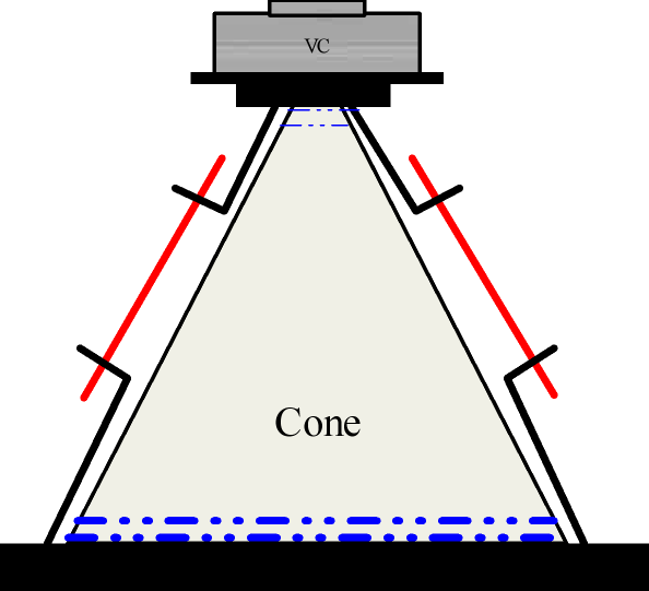

I have been thinking exactly the same thing about the stamped steel basket legs and also figured that as long as I'm doing surgery that I might as well make a cone about 2 or 3 inches taller and stuff that in there as well. As I said earlier all I have to lose is some time and a few bucks for the speaker. Losing the time right now is the problem - I've been to tied up having fun doing other projects!!
Could be a good time to add that 10 KiloWatt 2 foot plasma tweeter too!
and your new suspension will be?
When you extend your cone? Ya know another thing you can do is to bury the talk from the spider, they sing all out of tune and very loud on top of it all. If you build up a felt dam layer by layer around the spider up to just clear of the voice coil you will be amazed at the clairity and detail that is there when you drop the output from the spider. The first proto's of the highwood point source all had spiders and since they were only behind a mylar diaphragm you heard every note. Our solution was to eliminate the spider all together, we used ferro fluid in the gap as a fluid bearing to stabilize the voice coil on the lower side and the diaphragm as a suspension on the top side.
Now something that I have never liked from a conceptual point of view about the Walsh style driver is that you will always have time smear since the wave you are listening to is jumping off of an angled surface. No way around it. So why not eliminate the the time smear and just not use a cone to begin with? Besides where is it written that you have to use a cone for a driver like this anyway? You can just as well use a tube as a cone. You can play with variable density/stiffness wall structure. Since the tube will be vertical and parallel sided you wont have any time smear as with the cone. Besides paper tubes are a whole lot easier to make that cones. A three ply laminate of fine balsa veneer would be fantastic. I should think that a cone the same diametre as the voice coil former would be just fine but there is no reason why you could not use a larger dia. tube if you figured that size matters (some do). Chew on that and tell me what you think about it. Regards Moray James.

Interesting ideas you have there! If I go with a straight wall tubular type of speaker design for the "cone" (can't be called a "cone" now can it?) - and make it the same size as the VC it would be a great looking match to the SonoTube base unit. I should think about getting an endorsement or something from those guys!!
This might be a chance to try out my pneumatic speaker design I've been thinking about where I drive a "balloon" like transducer made of thin rubber and excite it with air pressure - hmmm.

Frame modification is a novel idea. I assume the cold rolled steel would be a rectangular section (?). Why not get the replacement members "cranked" 90 degrees on each end so the x-section seen by the sound wave is less?
If any effort is is put into the 3-ply balsa, the directional stiffness can be tweaked by varying the alignment of the layers.
Hi Mongo! Good to see you over here!
I was simply thinking of taking a hack saw to the existing stamped metal brace sections mid way up and then bending a outward pointing flange say around a 1/2 - 3/4 inch or so and then putting in some off the shelf aluminum spacers I can get down at yonder super home improvement hardware store. Probably use some 2 inch lengths and put some type of rubber bumpers on the ends to deaden things up a bit.
Given the fact that the basket just has to support the vertical force of the weight of the magnet in this configuration, and not have to support that magnet cantilevered off the end of the basket, as in a typical configuration, couldn't you just cut off some of the brace sections? Might be easier, if not optimum. - Pat
Hello Pat,
Thank you for your input. Currently things sound nice and sweet so I have not been in any rush to fix something that is not broken. I have thought over many ideas about this - but to what advantage?
My main problem is a proper way to go about extending the cone in length and still have the speaker operate properly. My best idea so far is to dissect the cone using a sawtooth pattern near the VC and surround and then glue in a new extended cone section made from a heavy bond paper used by artist for watercolor painting. My concern with this is where the new extension will bond and interface with the existing cone material. This is sure to cause some type of interference - but on the other hand with the proper design I might be able to use this to an advantage by employing a Mamboni pattern to help hold things together as well as providing some controlled stiffening.
I have also considered simply inverting the cone and letting it stick out of the speaker and remounting the speaker in a normal manner.
I have an extra speaker laying around that I keep meaning to get around to - but other events seem to keep diverting my attention away from playing around with things.
I can see that I shall need to put this project back onto the stove and warm it up a little. After all - some foods taste better the next day!
