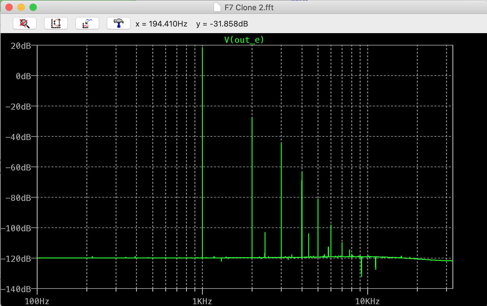

F7 clone for LX Minis
I decided to embark on an LX Mini speaker build and was looking for a class A amp for the high-end drivers. I will be using Papa's analog crossover - board and parts from the Store.

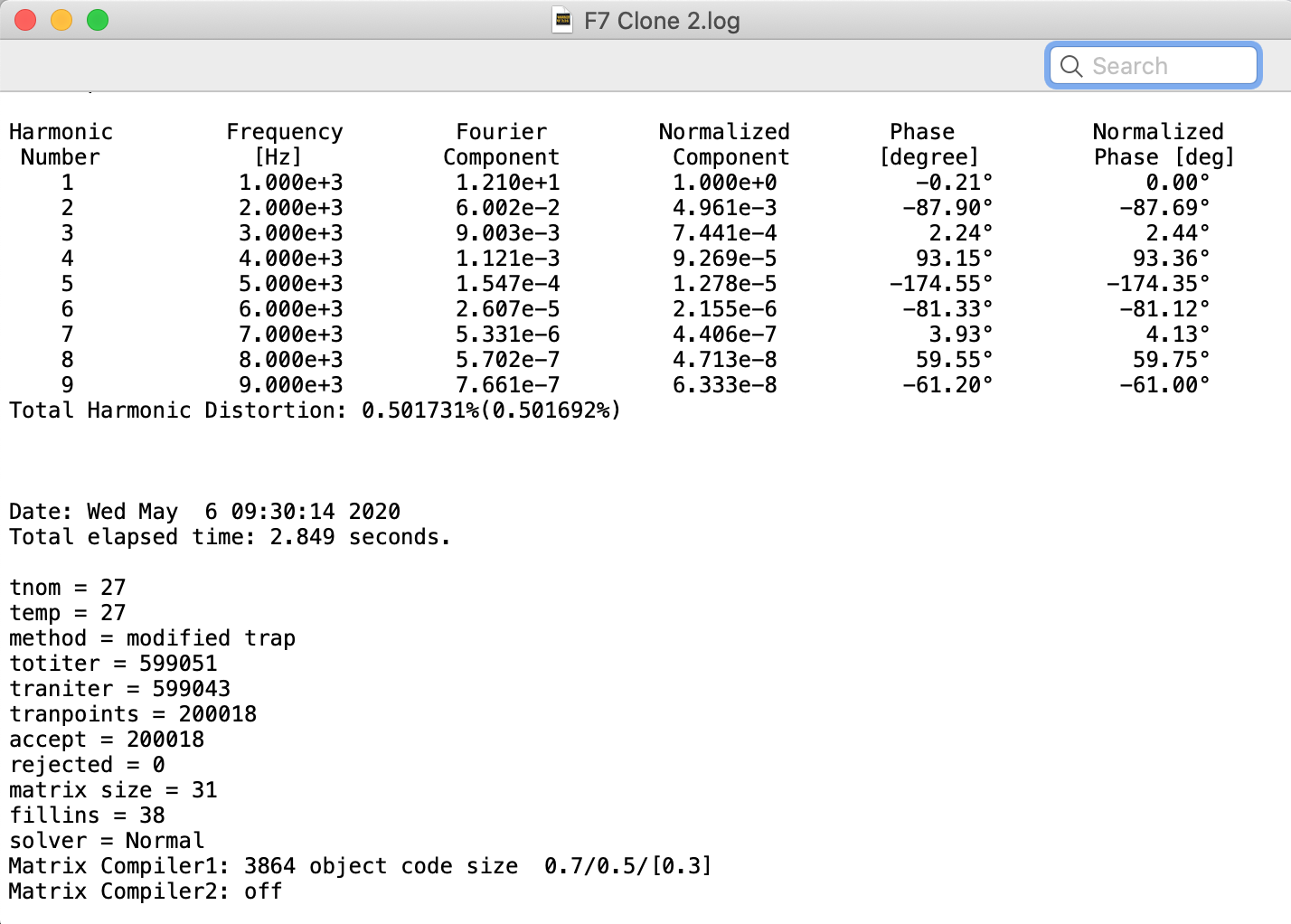

I was about to start on an F6 clone build but got intrigued by the F7 Review thread. I started (like most of you guys) with a bunch of sim runs. But what finally got me off my butt and gathering parts was when I got LTspice to spit out this lovely FFT. The THD at 30 watts is around 0.5%, but it is almost entirely even harmonics (fine with me). The 3rd is 120db down!
Oops - I goofed. Obviously the third is NOT that far down! But still not bad.
I should add that I am using the LTspice built-in models for LSK170B/LSJ74B for the fets and the Ian Hegglun/keantoken lateral models found here for 10P20/10N20 Exicon parts. And here is the LTspice log for the previously mentioned FFT.
