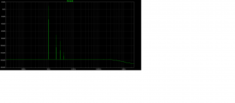

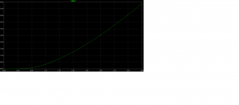

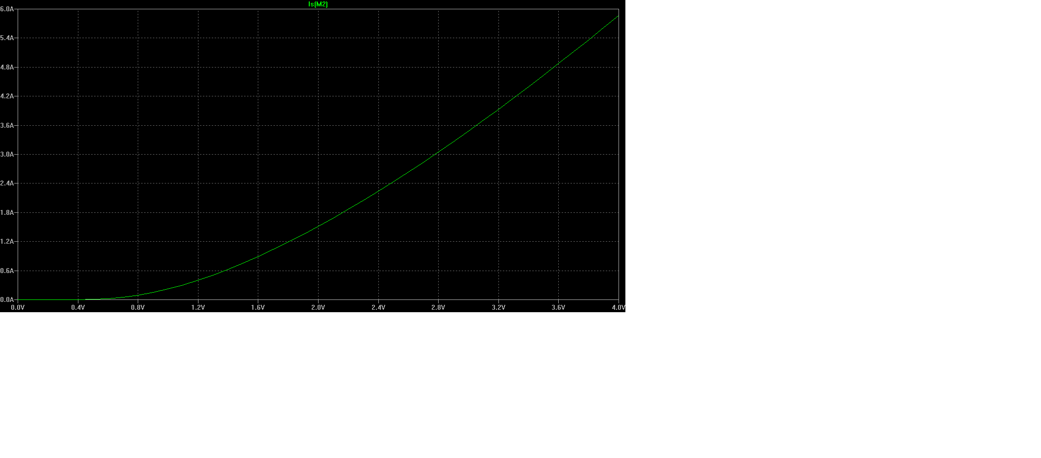

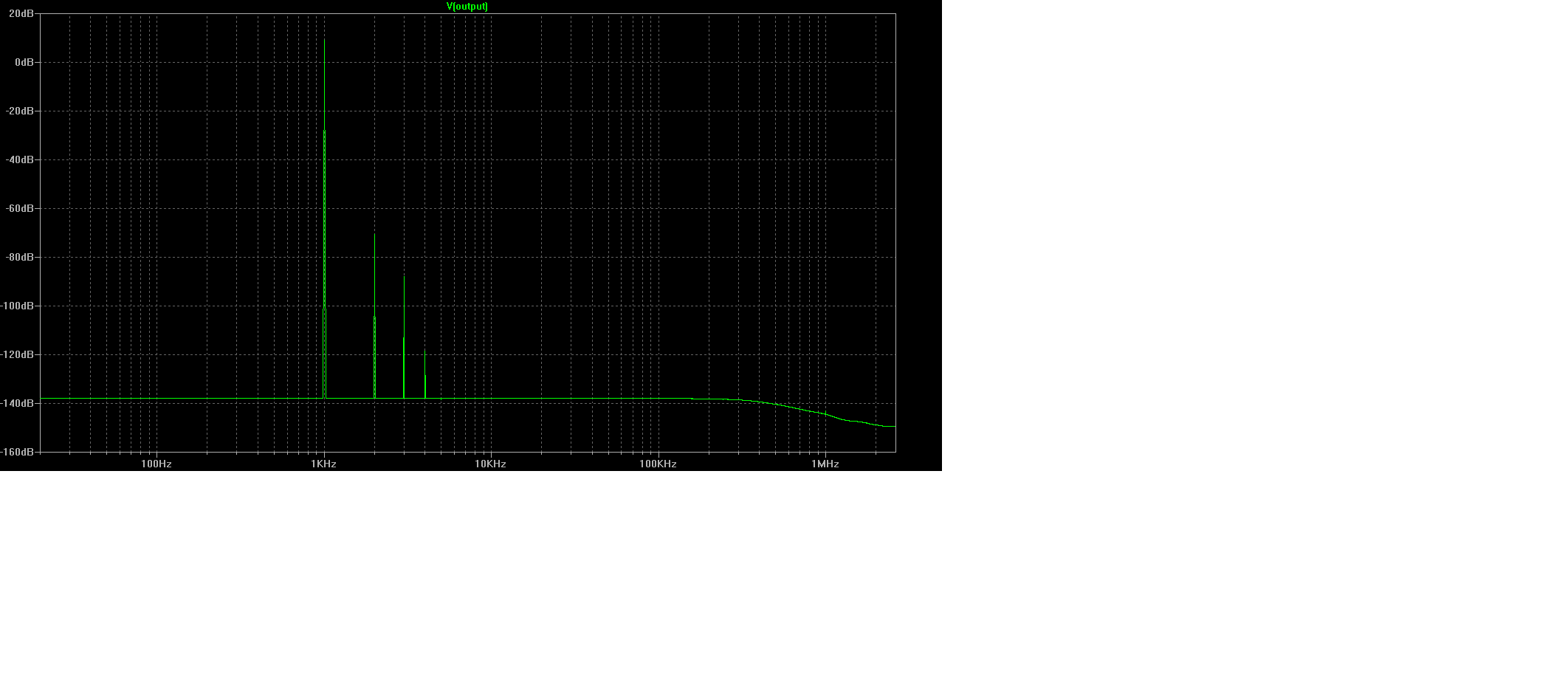

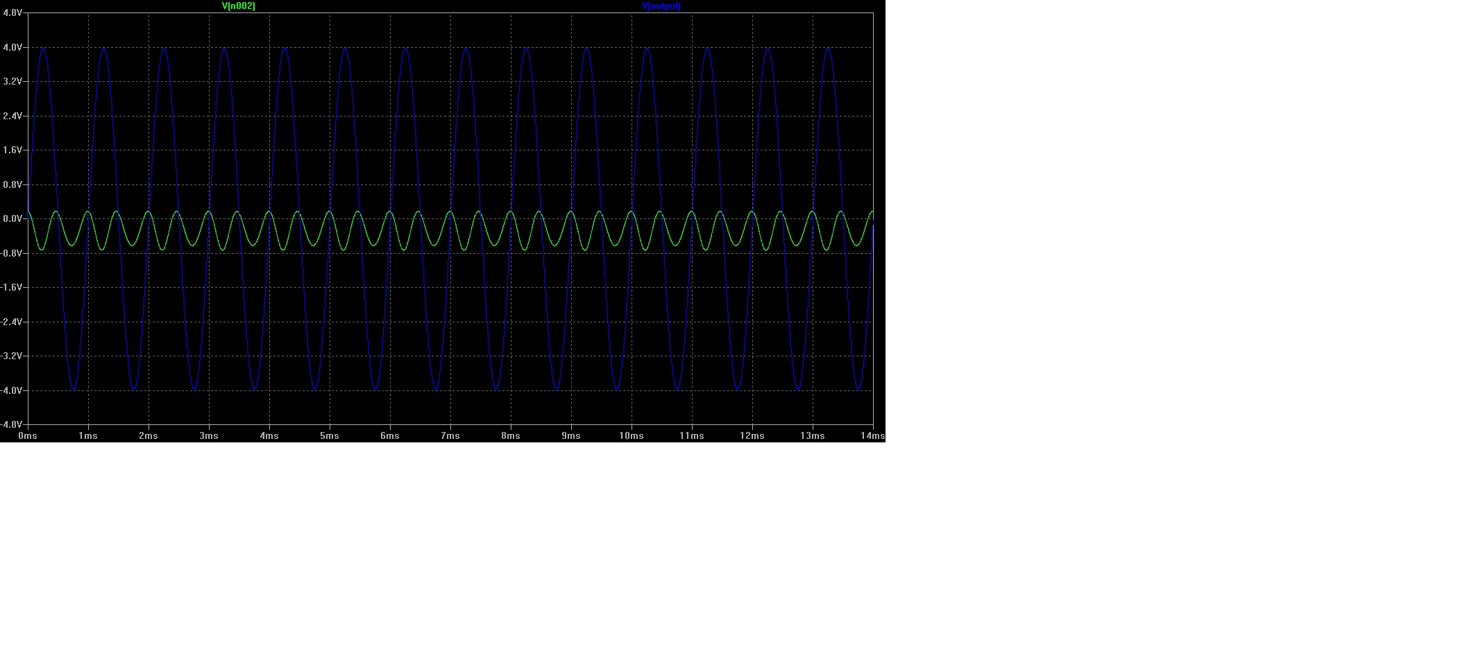

There are some new models recently posted by IanHegglun for the Exicon 20N20 and 20P20. So I simulated the f7 with them using matched and unmatched jfets. I also simulated a notch filter to see if the distortion waveform phase would change in ltspice. The unmatched pair distortion was 180 degrees out of phase with the matched pair distortion. The Idss of the 2sj74 was 6.4ma and the 2sk170 was 8.4ma. The distortion was 0.04 thd for the matched pair and 0.01 for the unmatched pair.The unmatched pair has a higher loop gain.
