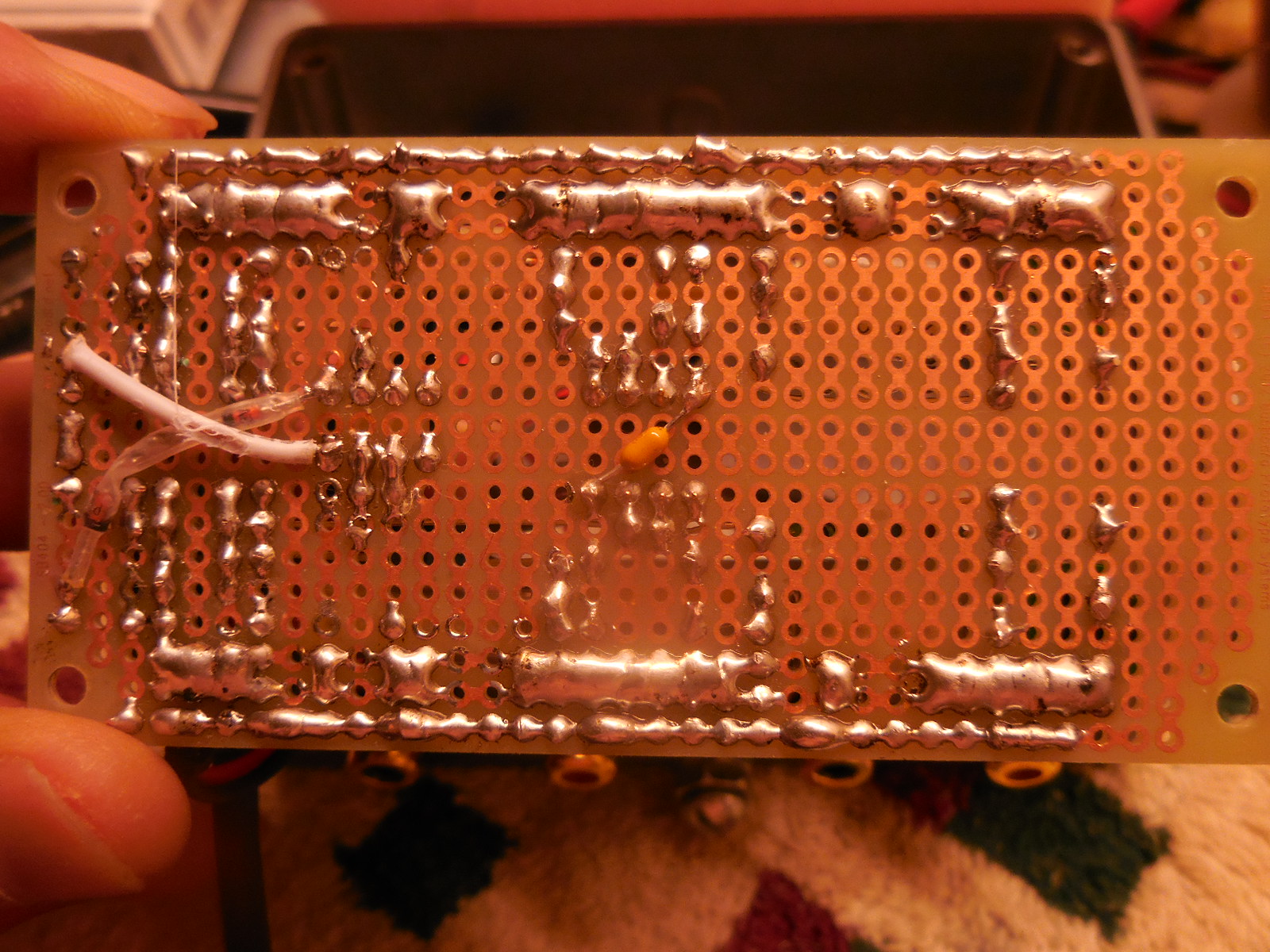

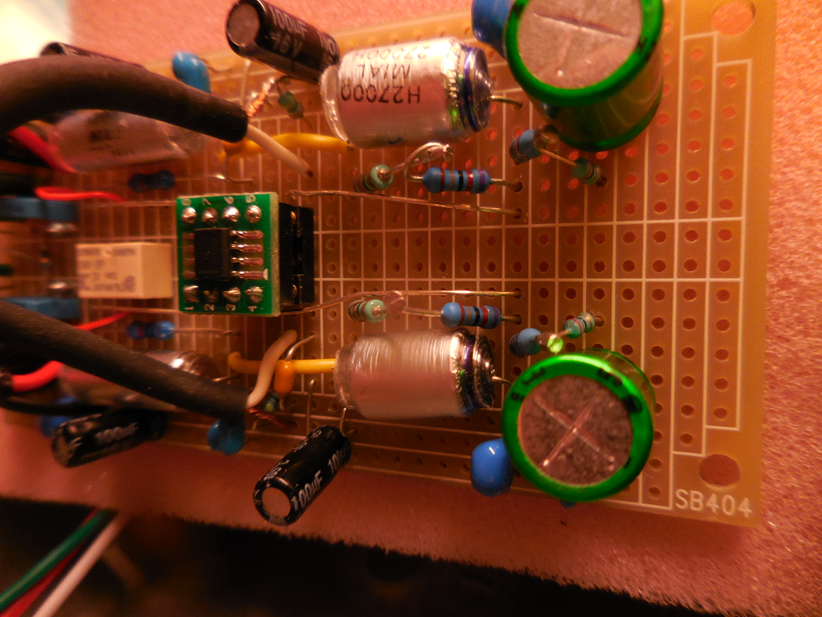

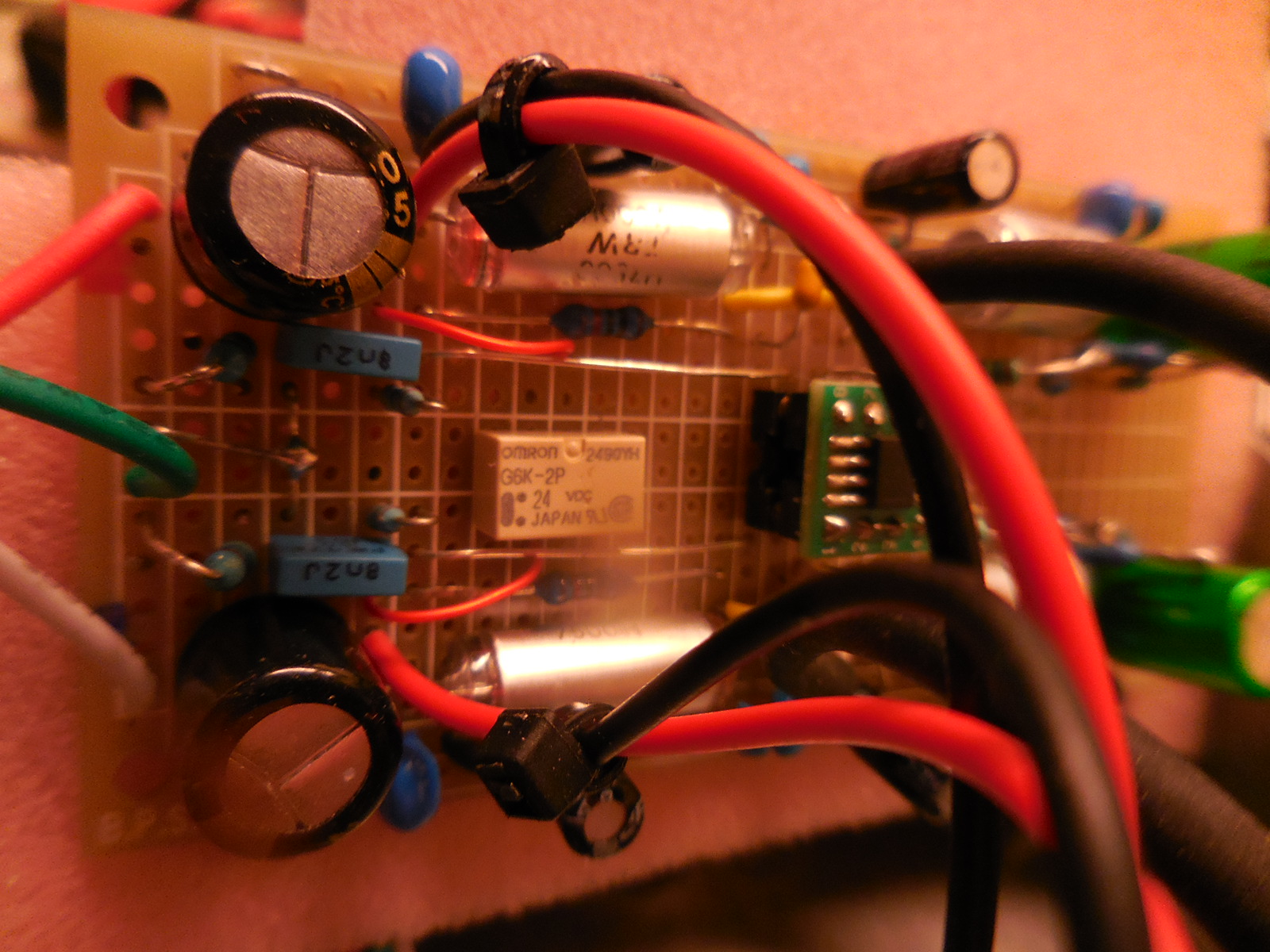

I have an OPA1656 story that may be interesting especially to whomever wants to build the RIAA preamp example in the apps section of the data sheet. I did build that and the slightly modified schemo is attached. I used the attached blank proto board. The Layout is attached. Of the three independent rails on each edge the outside L and R were used for -15V and +15V, resp. The inner two were 0V, center Gnd, branched at power entry at the top. The rails are heavily post-filtered and bypassed and the P/S is external. The DIP8 socket has 0.1uF X7Rs pin 8→gnd, pin 4→gnd and pin4↔pin 8. The enclosure is cast Al/Zn, at 0V and everything “grounded” only via the cable shields to the main preamp. I used polystyrene caps b/c they can be had surplus in 1% values. 000.0mV appears across the 47KΩ non-inverting input load resistors and at rest the finished unit is dead quite.

"Is that 47uF/35V cap in picture #1 (far left low side) looking domed?"
It sure is boss. Nice catch but, that is not a current photo. My bad in the company of experts. Jeese. Anyway the 47's were replaced by 220's as in the Layout dwg.
