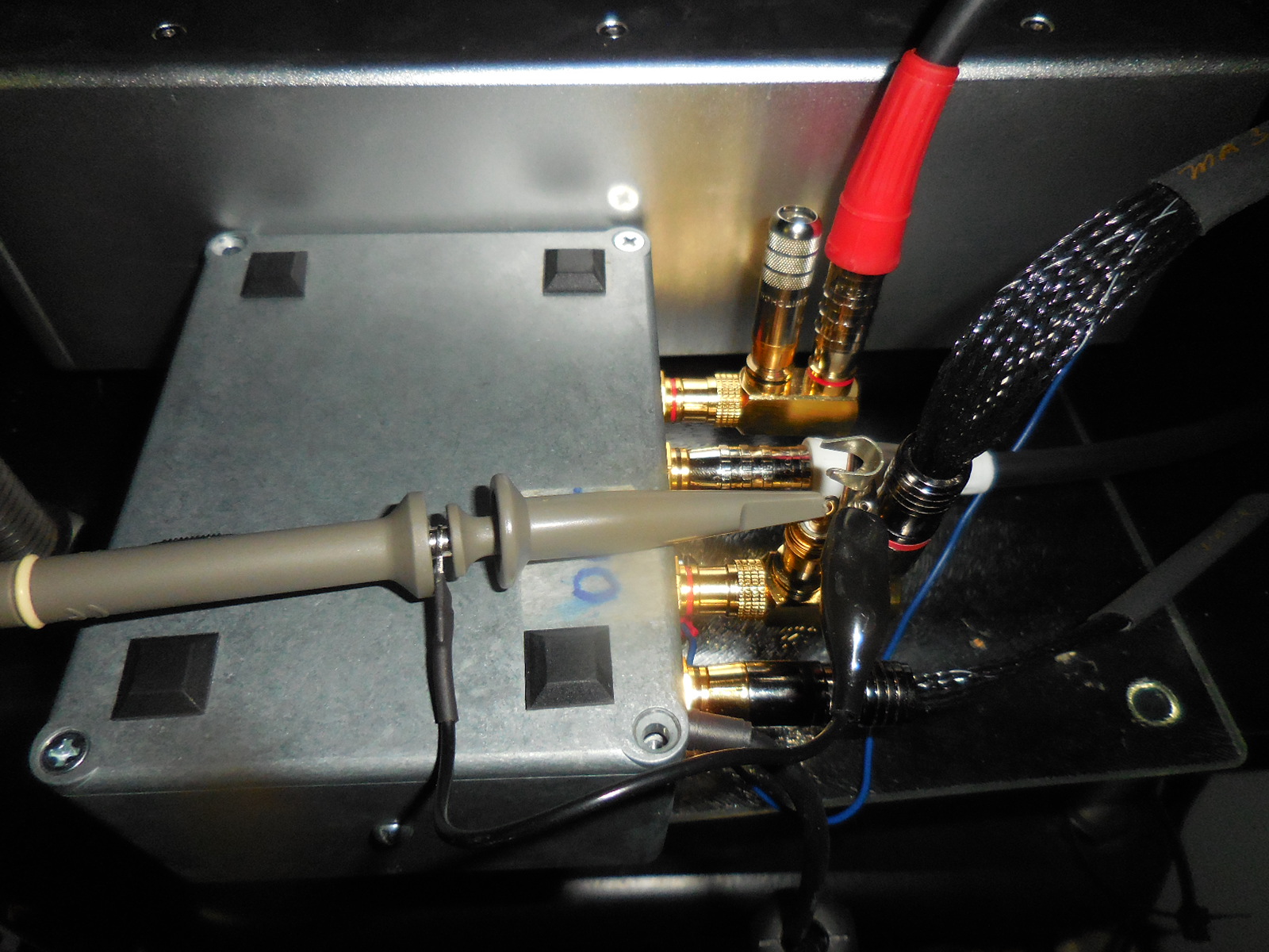

Now, I remembered how just the presence a scope probe could cause circuit trouble or cause circuit trouble to vanish. For this round of pics I removed the Blue probe + the solid 1-male => 2-female adapter used to allow tapping into the RCA input and plugged the right channel TT input cable straight in as per usual.
Hint = no more scope probe impedance across the 47K R.

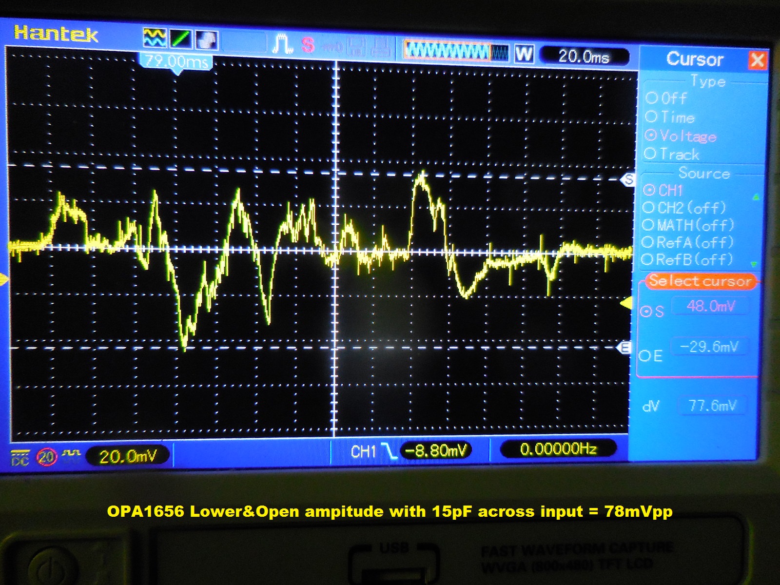

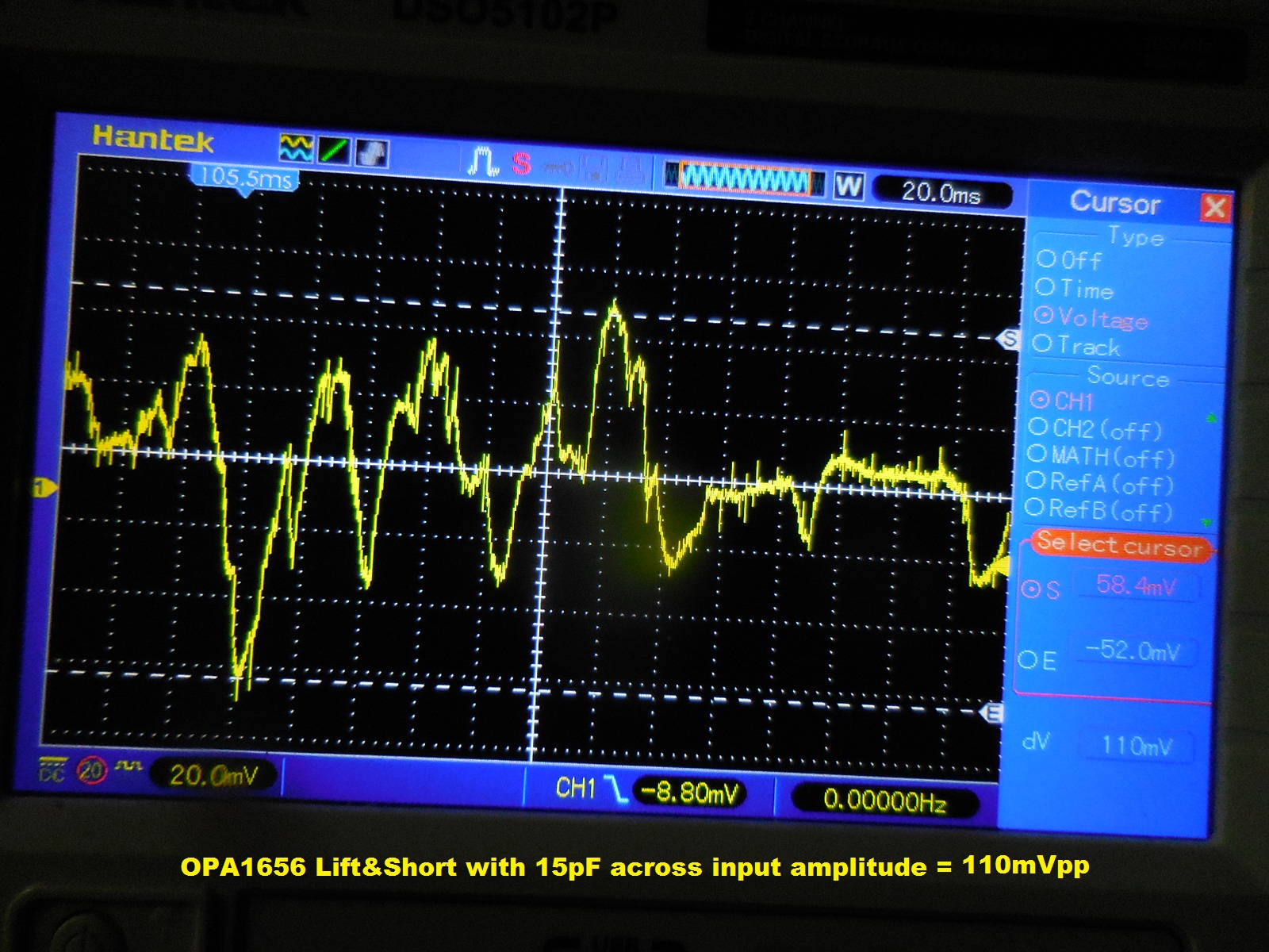

These shots show both the Lowering and Lifting RIAA output results for both op amps. Seems that some posters here are on the right track. I have no endpoint pF at the op amp's + input or RC filter. My 195pF "load" for the cart is distributed all along the signal path.

That's exactly right Hans. Whenever there is a Blue trace it's the TT input where the scope probe tip and its Gnd lead are attached to RCA center and RCA shield, resp. Yellow is always RIAA output. Yellow only is with TT signal straight in - just like the first time I tried my box.

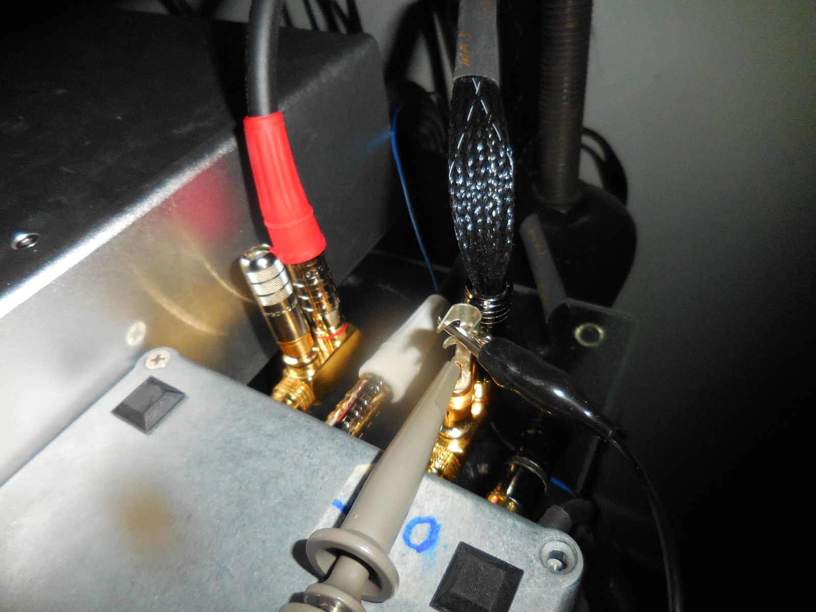

I used an empty RCA male connector and installed a 15pF polystyrene cap inside and plugged that into one female jack on the 1-male to 2xfemale adaptor. Then plugged the Right channel TT cable into the 2nd female jack. Then the single male into the box. So now TT signal enters the RCA adaptor, sees 15pF from center to shield and then the 47K a few inches inside the box on the PCB. That's it.
What this does is to transform the whole situation. Gone are the multi-volt "speaker-eater" convulsions and back are the "with scope probe" many tens of mV "docile" OPA627 results for Lift and Lower - the latter always being the greater.
Attached are today's scope shots labelled the same way as yesterday's + two shots of my setup. Unbelievable. I believe I can live with this solution.
