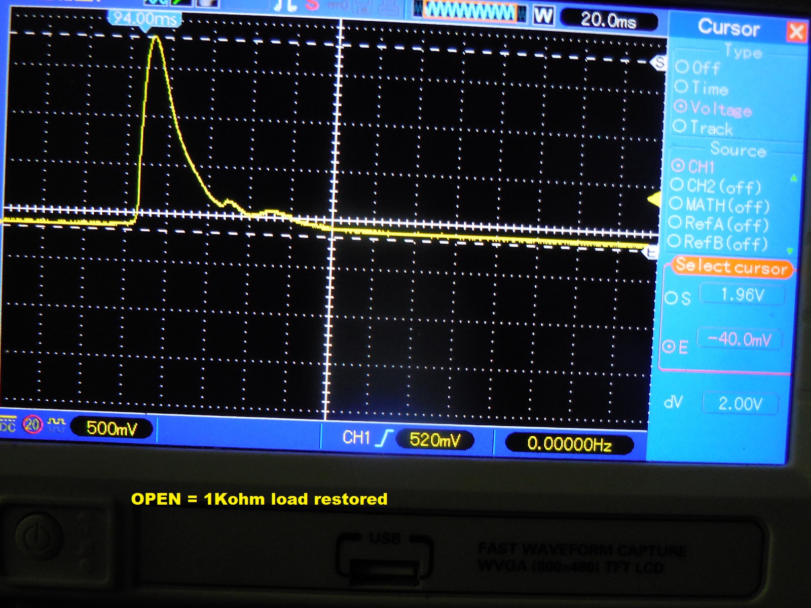

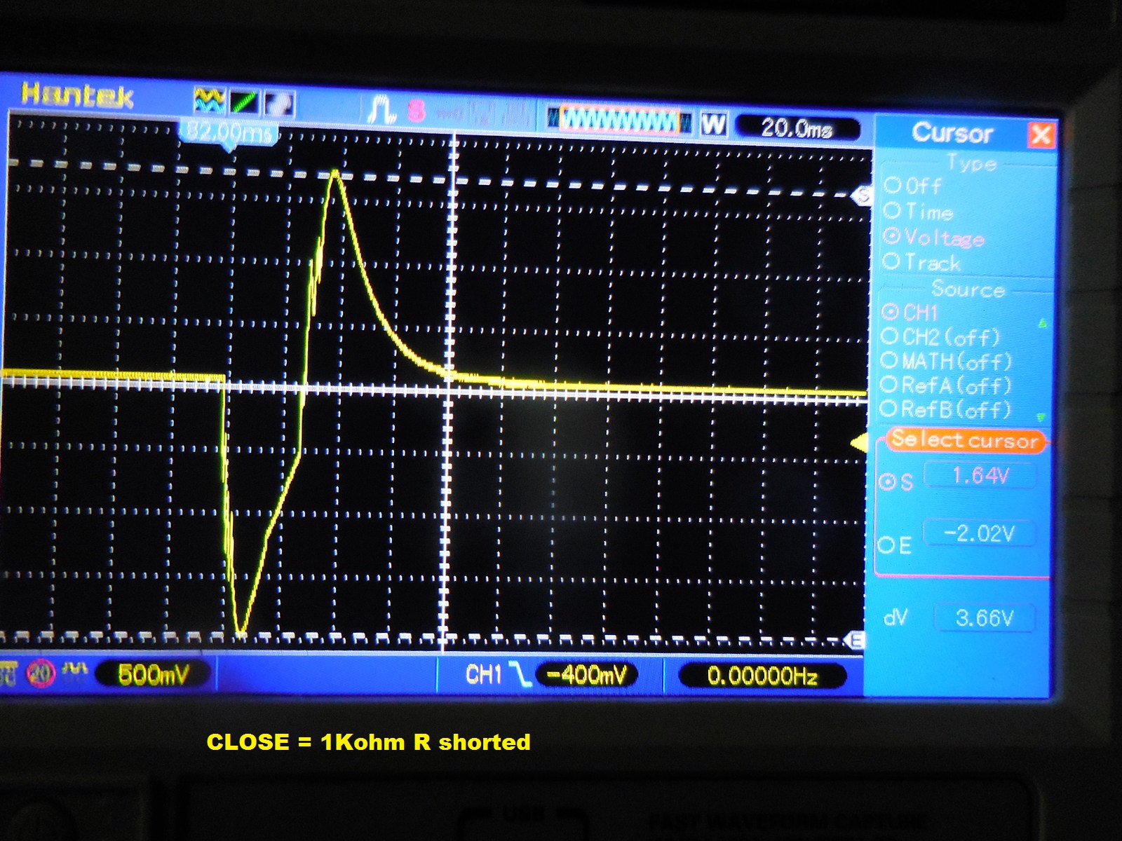

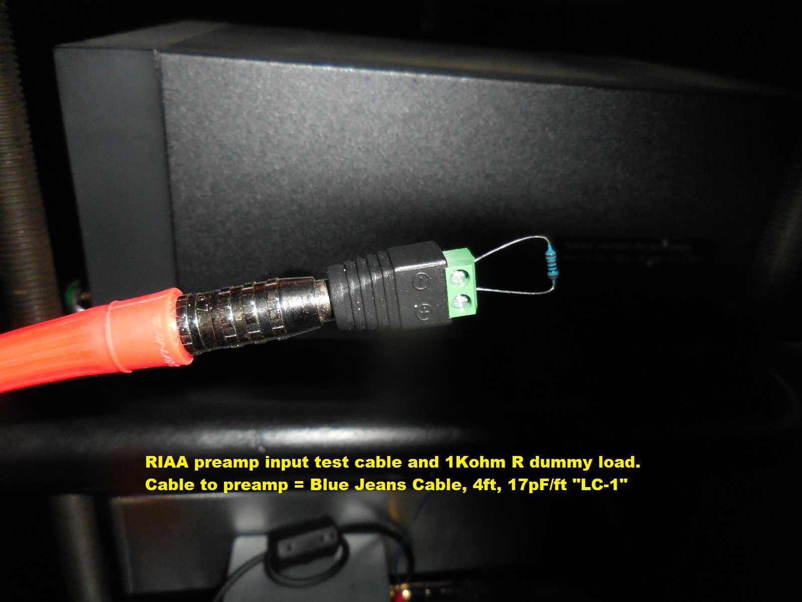

The no cart, cable-only short and un-short testing was done with 4ft of low-cap, 17pF/ft RCA cable with one end plugged into a RIAA phono input and the other end terminated with a 1KΩ R. See pic.
Shorting was done with the shaft of a small screwdriver placed or touched across the leads of the R (=SHORT). Or, previously placed across the leads, the scope set to trigger and then quickly removed (=OPEN). The 1656 sees 1K//47K then 0Ω or sees 0Ω then 1K//47K through a 4ft cable, resp. I practiced this maneuver until I got it right. The real mute slide switch is not that clean anyway. The scope pics are of that channel’s output. (Please see the peak-to-peak voltage in the lower right corner labeled "dV" b/c I forgot to include that value in the captions). They look somewhat familiar to the real 1656 Lift and Lower shots in as far as gross amplitude and the very low frequency content if nothing else. Oh, and the 3rd scope shot was when I bobbled my hold on the screwdriver shaft and resistor leads so this is a series of interesting Short-Open, make-breaks, repeat, etc.

O.k, your experiment with the separate interconnect shows that your TT + Cart can be excluded from the equation.
That narrows the search for a cause.
My next suggestion would now be to shorten C4, the 100uF cap.
This will cause a DC offset at the 1656 output, but below 1Volt so still acceptable for this test.
