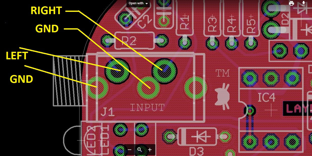

The extra 2 holes on the board under the output jack are not used. Those are switches which *are* used in the input jack to ground the contacts. Just to simpify the BOM (and prevent part mix-ups!) I used the same jack for output as for input.
agdr linked photo
agdr linked photo
Just would like the clarify the above. Are those switches really necessary for an external input jack? Would implementing a non-switched three-contact isolated input jack create a problem?

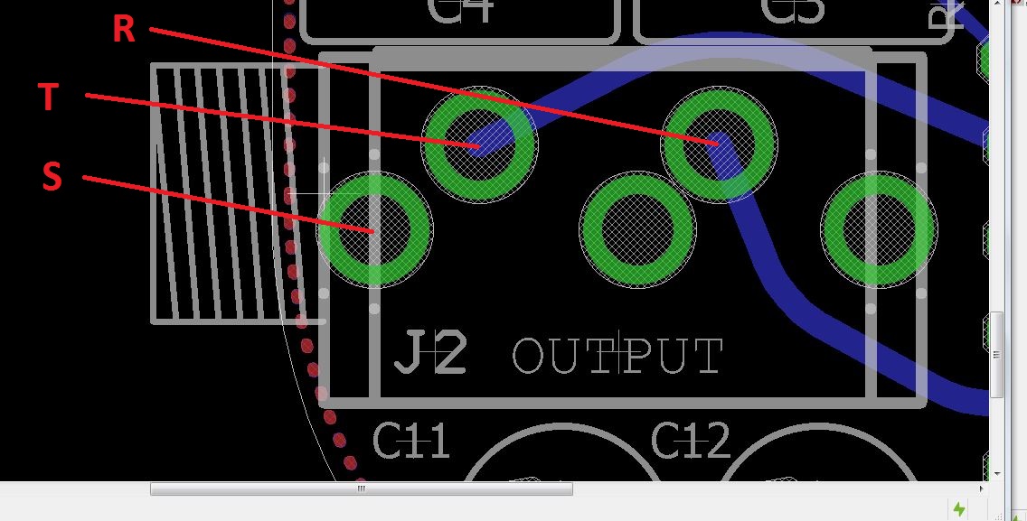

WoodyLuvr - you do need the switch contacts on the input jack. Don't use a 3 contact jack, you need all 5 - 3 contact and two switches. The switches are there to ground the inputs to the amplifier when nothing is plugged in, so you don't get hiss and noise. It is a bigger deal than one would think in actual usage, especially with the volume turned up and nothing plugged in - you won't hear anything this way. Otherwise you will hear hiss from input noise pickup. NwAvGuy's O2 Headphone amplifier does the exact same thing (jack with grounded switch contacts) and it works wonderfully, which is why I designed it this way on the Super CMOY.
So you need a panel mounted jack with the two switch contacts in there. You only need to run 3 wires to the panel jack though (be sure to twist all 3 together):
* The PCB hole labelled T or "left" is one of the jack contacts. Google "TRS Jack" for the wikipedia page, then scroll down. One of the pictures on the right edge shows which part is left and right. The tip of the plug is left, the ring is right, and the bottom part is the shield. You just need to figure out which contact on your jack mates up with the tip on the plug and that is your Left. You can do this via the diagram in the jack data sheet, or the old fashioned way of just taking an ohm meter, sticking the probe into the jack to contact the "tip" contact, and then measure the jack connection contacts to find which one that is.
* The PCB hole labelled R or "right" is the other jack contact. So figure out which jack contact mates with the ring on the plug and that is right.
* And finally the S on PCB is the ground (as are the other two holes down the middle, which are the switch contacts, but you don't need to run any wires to those). So you just need one more wire going from S on the board to 3 places on your jack: the contact that mates with the shield part on the jack (bottom part), and then to both switch contacts on the jack.

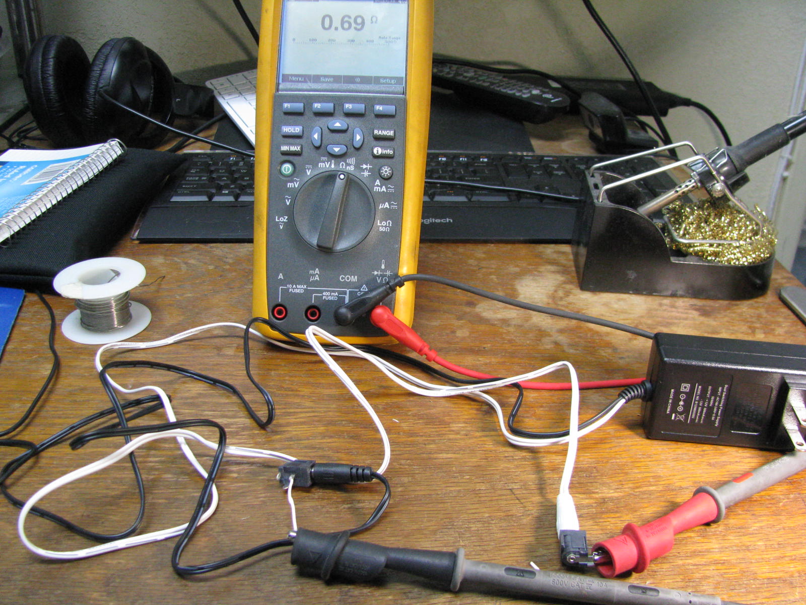

Analysis of the Adafruit # 2591 +/-12V 500mA wall wart power supply
Here is the promised analysis of the nice +/-12V 500mA wall wart that WoodyLuvr found at Adafruit, their product ID 2591. 🙂 The summary is that it looks great for audio! Should be a real time-saver in powering some projects, like the Super CMOY here.

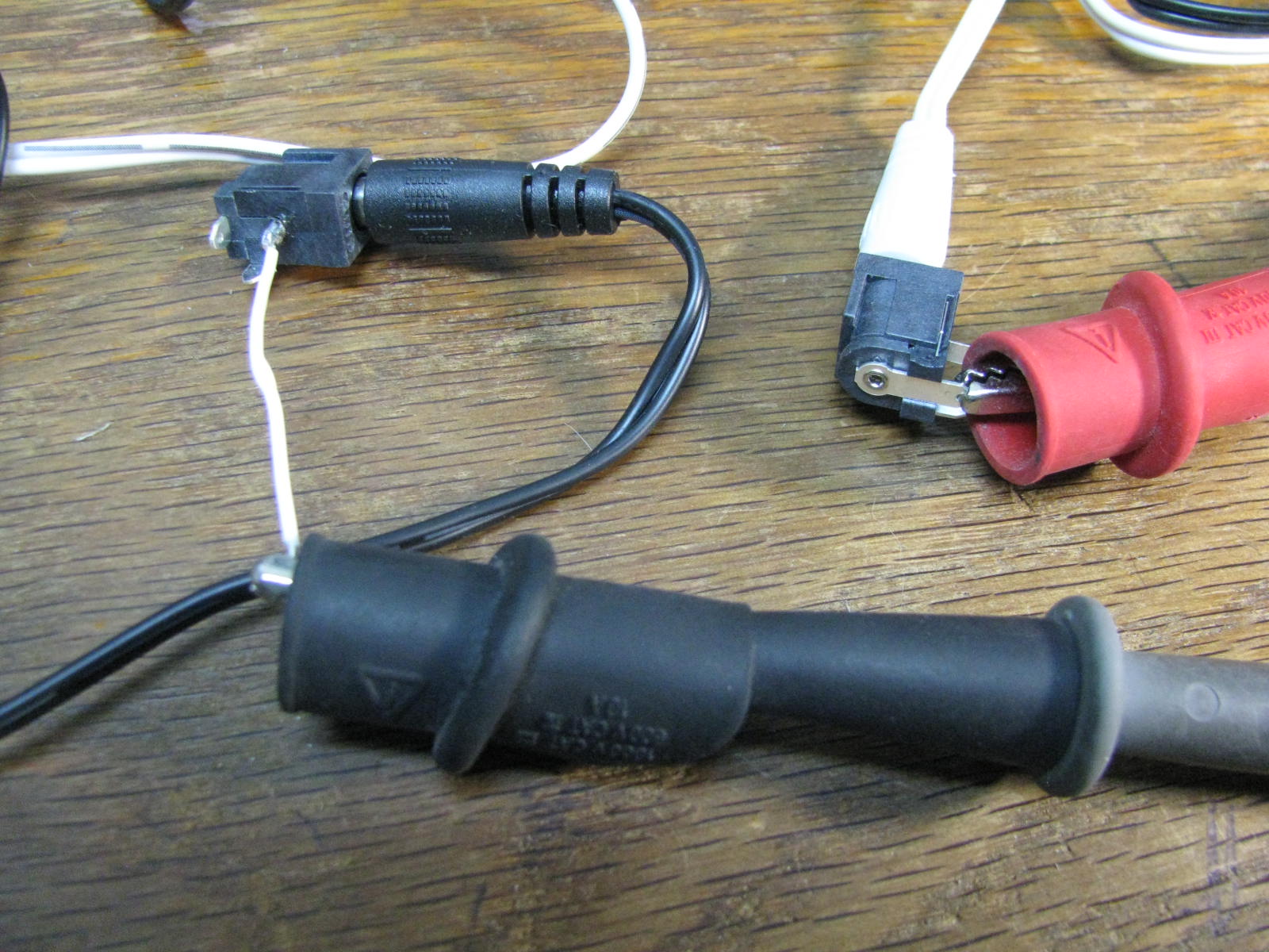

* The first two photos, 5445 and 5446 (mouse over the photos for their number, and remember you can click the arrows in the lower left of the photos to expand them) show the basic setup. The wall wart uses 5.5mm outer and 2.1mm inner barrel jacks, which happen to be the same ones used by the NwAvGuy O2 Headphone amp.
Like the Adadfruit write-up says, the black lead out of the supply is your "normal" positive lead, with tip positive polarity (the end contact on these jacks) and barrel negative. The white lead is the negative supply. Like the write-up says the tip of that one is also positive, and internally connected to the barrel of the positive supply to form the "real" ground between the two. The third contact on these jacks is an internal switch which isn't used here.
So essentially there are two normal supplies packed in the one wall wart here, just with the negative lead of one (the black wire) connected to the positive lead of the other (the white wire) to make a +/- supply with real ground in the middle.
The first thing to do then is verify the supply really is wired this way. 🙂 In the first photo, 5445, the meter is measuring continuity in the supply between the barrel of the black lead and tip of the white. Sure enough, a short. 0.69 ohms is the resistance of the meter leads, leads in the supply, and test clip contact resistance. So in this case 0.69R is a short. And, of course, the wall wart isn't powered up yet here.

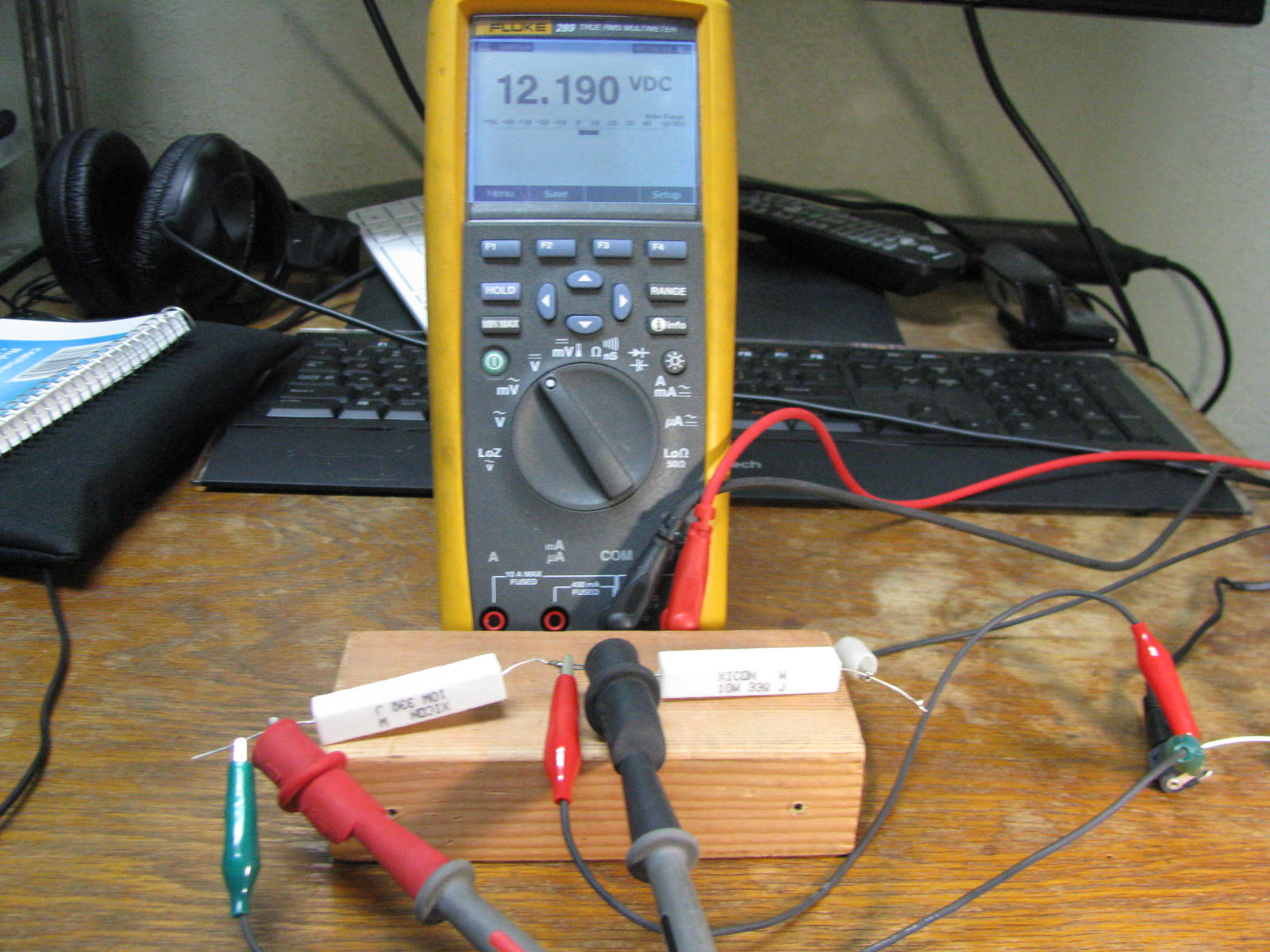

* Next photo, 5449, shows the voltage on the positive half while unloaded. 12.24Vdc, just what we would expect. The negative (white lead) supply isn't shown but was similar.
* Next photo 5450 shows the "real ground" jumpered between the two jacks [EDIT oops, ran out of photo slots, had to remove this one to get it all in one posting]. Since this is also internally connected in the supply I could have skipped this step. But since we are doing noise analysis here made sense to also make the connection at the end of the long power supply cables.

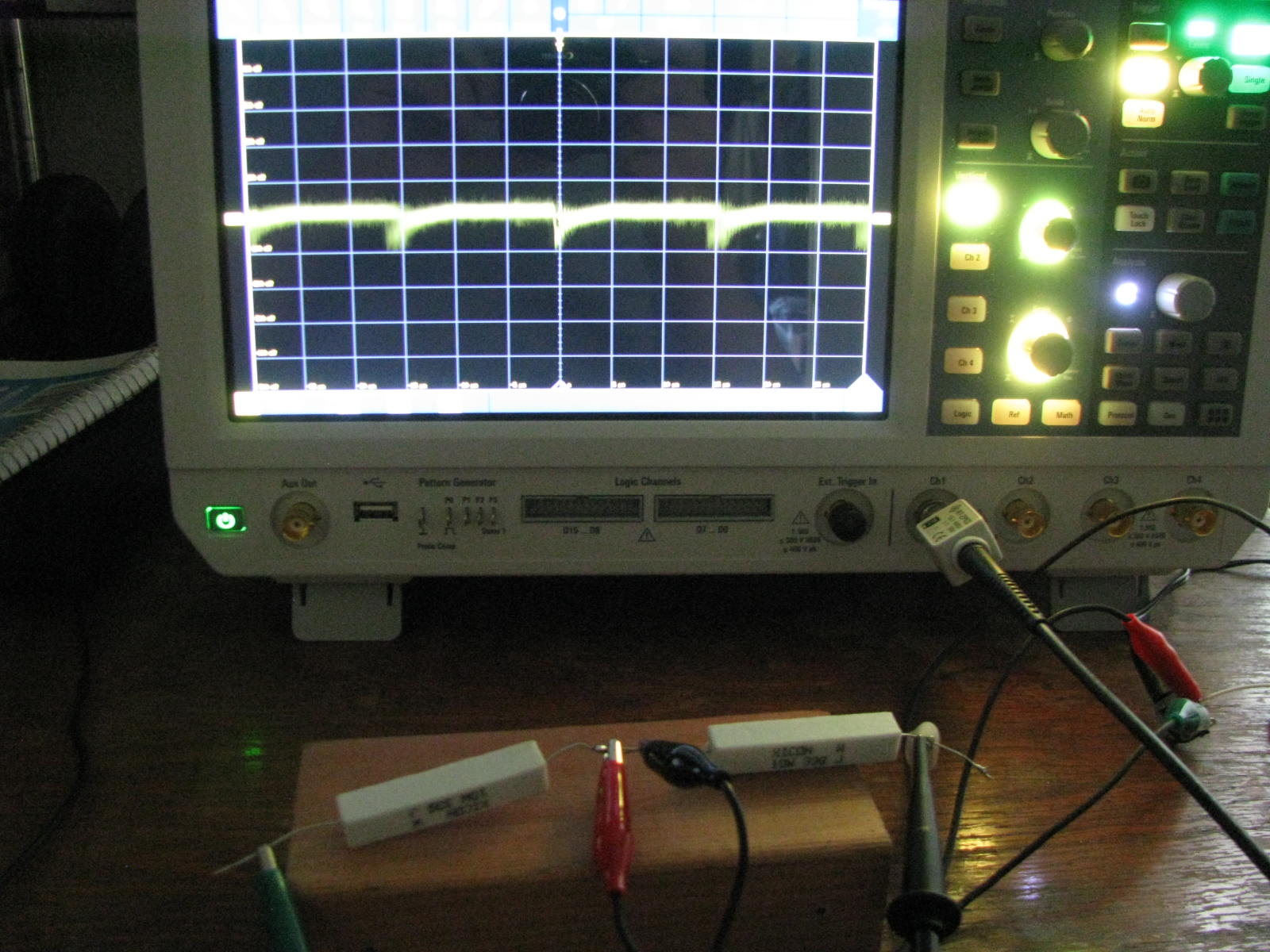

* Now things start to get fun in photos 5454 and 5455 with load resistors attached. 😛 Those are two 33 ohm 10W resistors. 12Vdc/33R = 0.36A = 360mA on each side of the wall wart. The supply is rated at 500mA so ideally these would be 24R resistors, but 33R is what I had on hand in the high wattage type. Close enough for our purposes here. 🙂
The photos show the loaded voltages on each supply half. Note still above 12Vdc even with the heavy load.

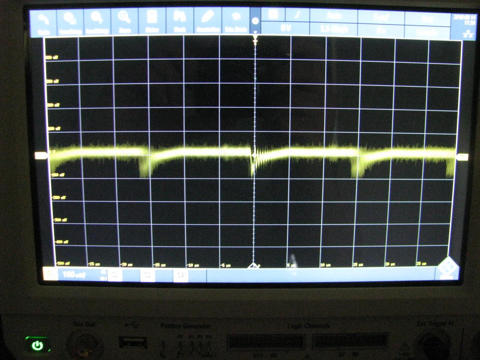

* The next two photos 5456 and 5457 show the scope connection across the positive supply load resistor and resulting waveform. OK, here it is, the switching noise! 🙂 The horizontal on the scope here is 5uS/div, so the period is about 3 divisions or 15uS. 1/15uS = 67KHz. The vertical is 100mV/div, so around 100mV. I'm using a x10 probe here but the scope knows about it and has adjusted the scale to match. I haven't shown the waveform on the negative (white) lead (the other load resistor here), but I did take a look and it was similar.
As I wrote in the post above, these kind of numbers will usually work out fine for audio. In fact they do, see the audio analyzer results next. 🙂

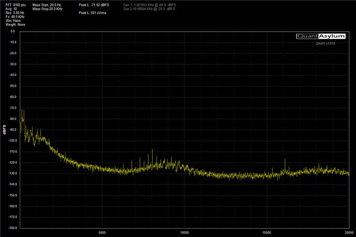

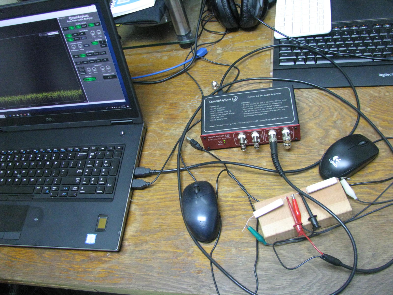

* Photo 5460 shows the connections to a QA401 audio analyzer, across the black lead load resistor (the photo is actually with the analyzer leads connected together, first screen shot, for background noise). The QA401 has built-in AC coupling and blocking to 54Vrms, so OK to just hook 'er up to the power supply here.
* In the final two screen captures from the QA401 the first is with the lead connected together to show background noise in the leads and analyzer, as a base reference. The second photo is across the black power supply lead load resistor. In both of these averaging is set to 10.
Well... pretty d*mn good, I would say! 😀 No major frequency spikes through the 20KHz audio band. The few lines that are there are tiny, 10dBFS or so. Note the scale on the left, all of this is wayy below the hearing threshold. Some of the noise floor rising from 5KHz to 0Hz (leftmost) is most likely due to environmental noise pickup in the room here (fluorescent lights with electronic ballasts).
