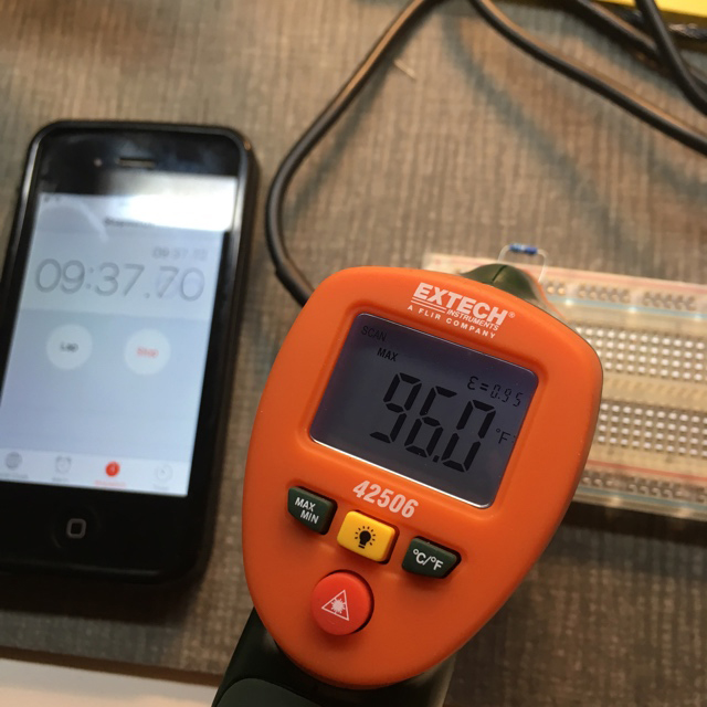

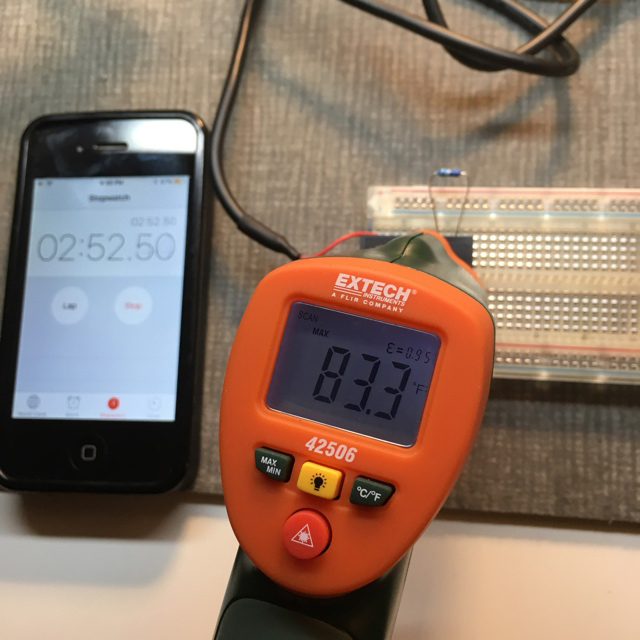

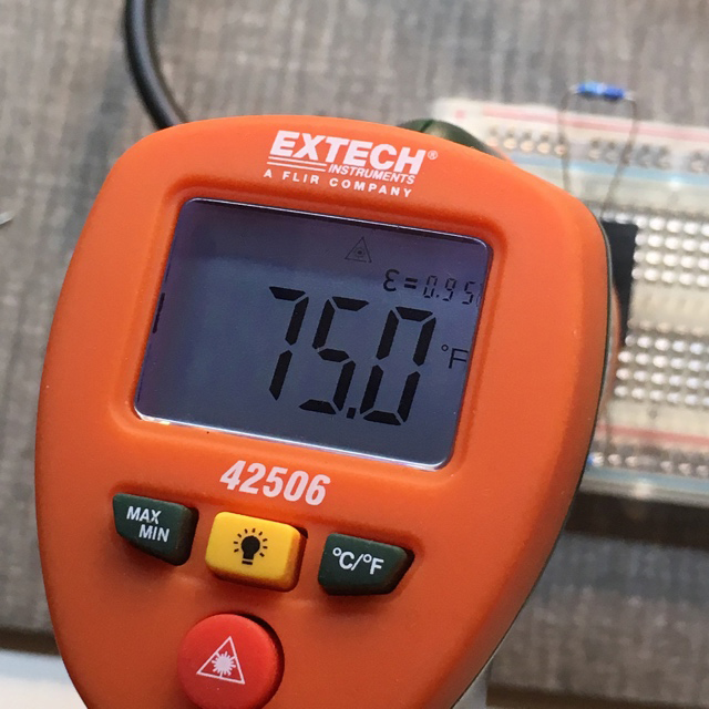

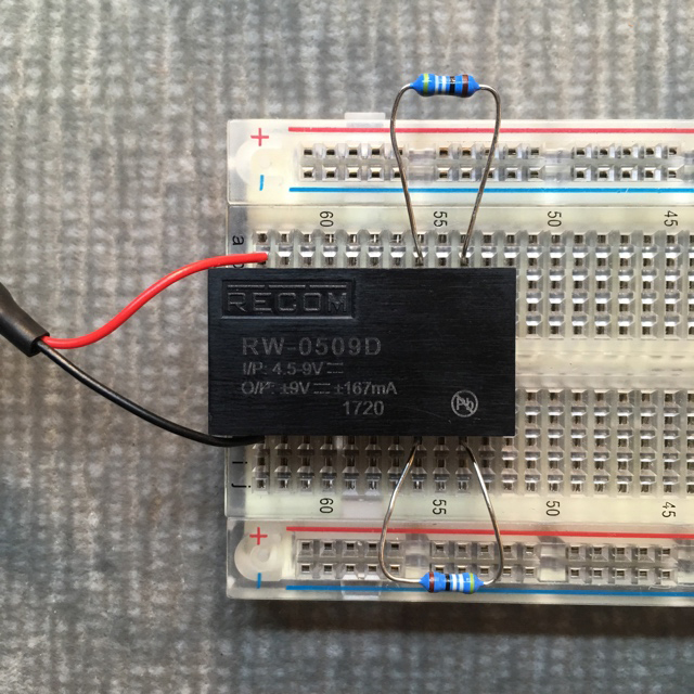

For kicks, I did some very crude thermal testing of the Recom on a breadboard powering it off a 2.4 amp Apple phone charger with the 499 ohm resistors connected. Here were my results using an infrared thermometer measuring the max temperature of the Recom and resistors as a whole. From what I could tell - to the touch, the resistors were the main source of heat. The Recom seemed to barely get warm...
Before power applied: 75°F
02:33 - 83.0°F
02:52 - 83.3°F
03:01 - 84.3°F
03:18 - 85.8°F
03:58 - 86.0°F
04:20 - 86.7°F
04:27 - 87.0°F
04:30 - 87.4°F
04:45 - 88.3°F
05:06 - 88.8°F
05:11 - 89.6°F
05:48 - 89.9°F
05:59 - 90.1°F
06:07 - 90.6°F
09:37 - 96.0°F

Thank you for sharing that temp test. Running very cool. Not surprised though as the converter was designed for medical instruments. In the RECOM datasheet it states: "The converters supply the full 3 Watts without additional heat-sinks over the temperature range -40°C to +85°C." so I am using the heatsink more as a platform to build the power module upon rather than "cooling" peace of mind ;-)
