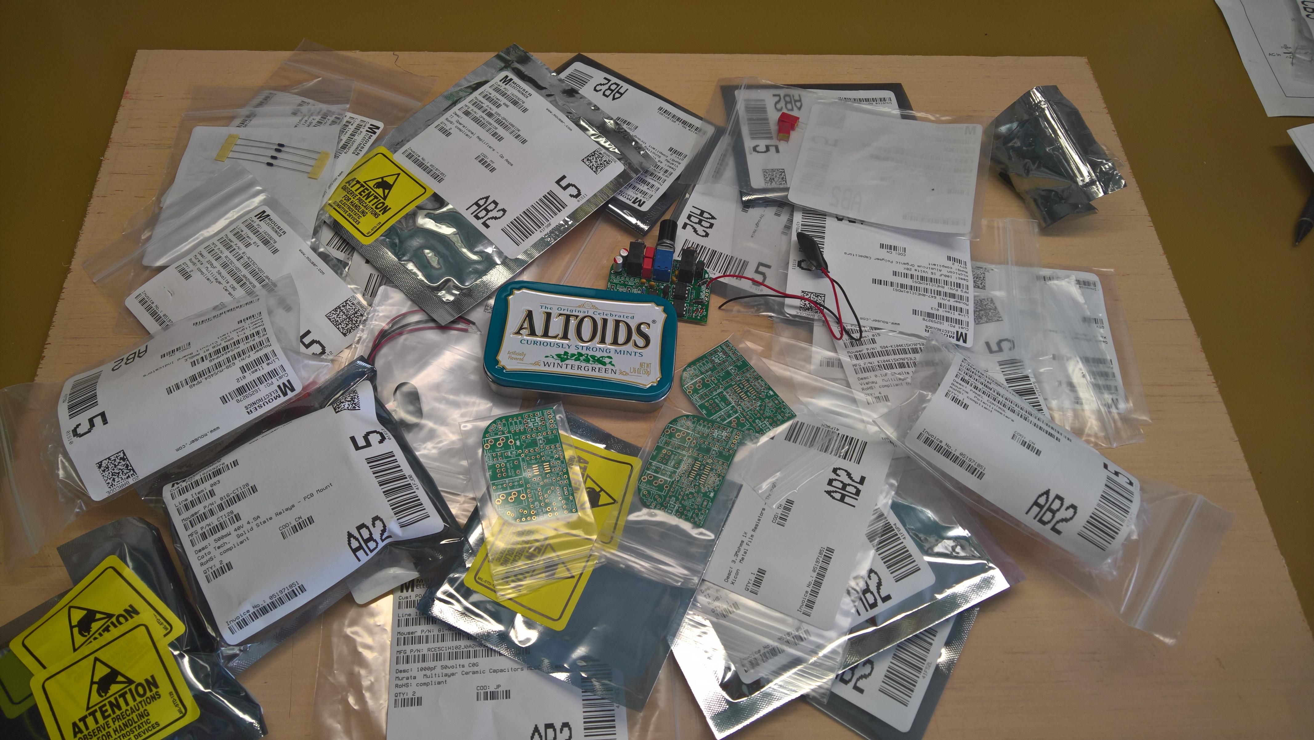

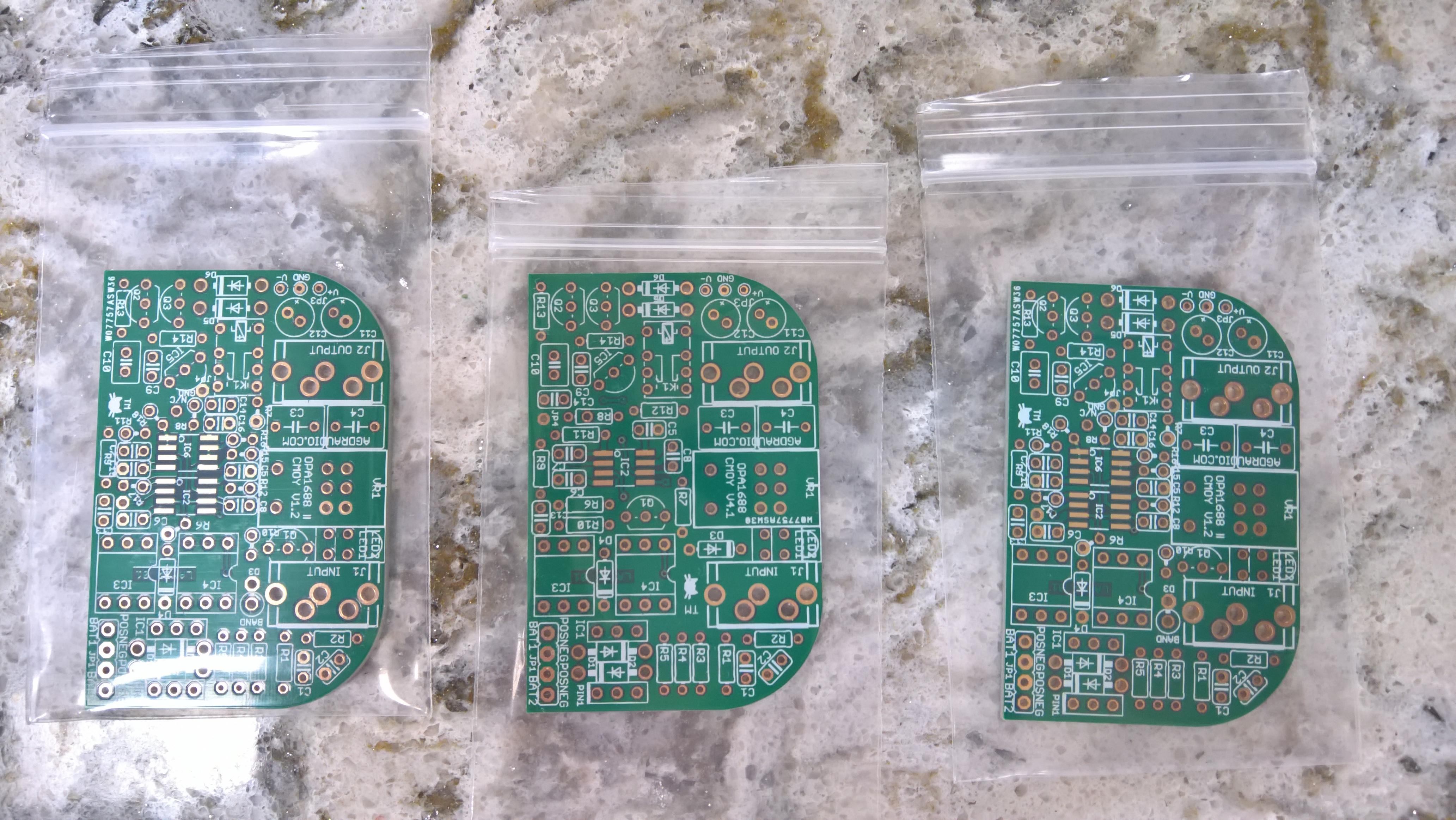

Look what just arrived!
Can you tell the difference?
Alex
The one in the middle is the single chip version. Its IC2.
The outside pcbs are the dual chip version. Notice the double sets of pads for the 1688's.
Those small 1688's are a challenge to solder!
I have an original prototype from back in the beginning that still works, its doesn't have the muting relay but works fine....just turn down the volume and turn on then plug in your headphones...works great.
I even have used it with the cans plugged in and the small click or pop is really very small its not an issue.
That said AGDR is a perfectionist and had to insert the relay in it...
Alex

I love your pre-assembly pile, Alex! 😀
No gerbers guys, but I do have PC boards and assembled TPS boards. PM me. Several reasons for not releasing the Gerbers. One from unfortunate past experience is they instantly become products for sale in China. 🙁
